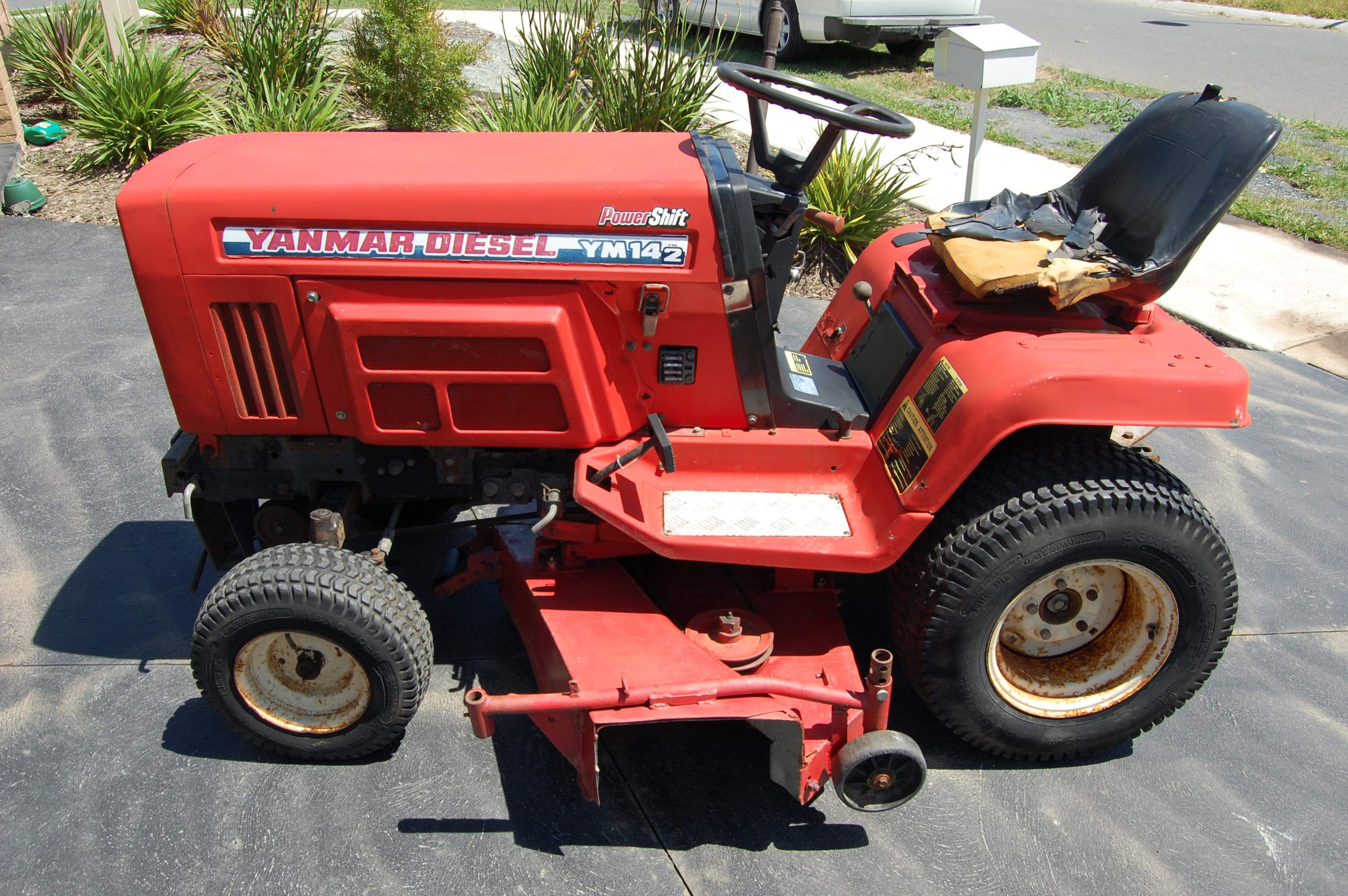

Nazrat.....Pictures would really help to confirm if you have Powershift or not
   / Powershift grinding (always engaged?)
#12
Sure, what would you like pictures of? Here is the shifter/sticker:
Here is the front of the transmission:
Here is the back of the transmission:
And here is the whole unit:
-Tad
   / Powershift grinding (always engaged?) #13
I am not familair with your model but I have read that is very simialir to the GT-14 which there are a few members who have them. I don't think that is a powershift though with just Forward, Nuetral and Reverse...but if you search on GT-14 I am sure you will find some owners who you can PM.

DSC_0740.jpgit should have on the column, N-R which is down and 2 forward, 1 is the first notch and second is all the way forward. then you have 3 ranges I,II and III down to your right. that gives 3 reverse and 6 forward gears.mine also has powershft stickers on it.

On the column shift it does have 2-1-N-R, but according to the parts manual both the Powershift and the gear-shift have the same shift pattern up there.
I found three things of note in the parts manual:
1) The YM14 shows POWERSHIFT stickers and the YM12 does not.
2) The Powershift transmission has a plug on the right side case near the back on the top. Appears to angle back about 45*
3) The Powershift transmission has a shift cable, and the gear-shift transmission has a solid shift linkage.
I know I don't have the Powershift stickers, but tomorrow when I have time I'll look for the plug as well as look at the shift linkage.
Thanks again for the help.
-Tad

1) True
2) thats the trans filler plug
3)if thats the case it must have that sliding mechanical trans they talk about, i dont think the GT14 has that? i am sure they are powershift being the 2 cylinder.

I'm satisfied that this isn't a powershift. It has a mechanical linkage and it doesn't have the fill plug on the top corner of the transmission case.
Thanks all for the help.
