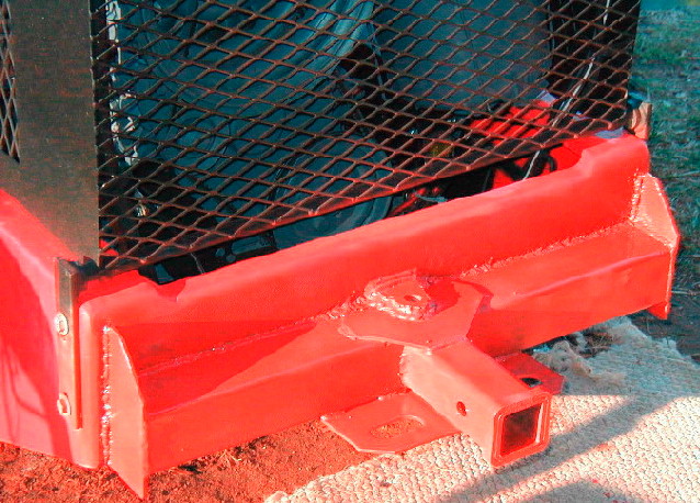

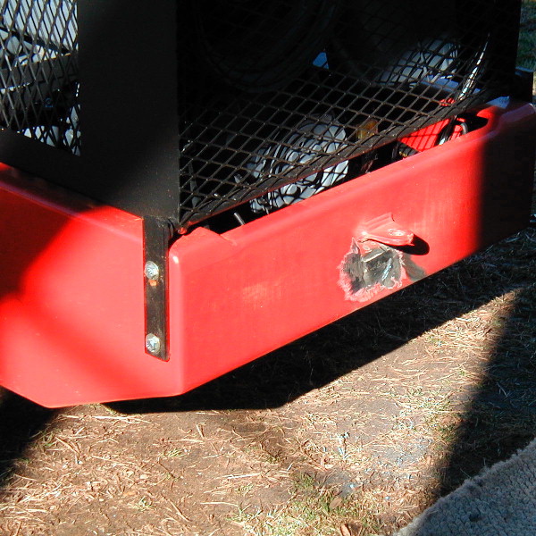

I tried to hitch to an old manure spreader. The Power Trac hitch wasn't deep enough. So, I took a smoke wrench and grinder to the factory hitch. Photo attached is after removal of lower ear of hitch.
/ PowerTrac Customizations #30
Then modified an old rusty Reese hitch and welded it on. Don't be too critical of the welds, please. They are designed for strength, not beauty.
/ PowerTrac Customizations #31
Re: PowerTrac Customizations - 1845 hitch
Hitch in primer - photo attached.
Having owned the Power Trac 10 days, and already cut of something and welded on something else, I suspect that I may keep it. Certainly I made returning it for a refund a bit unlikely.
But, no buyer's remorse so far.
Next project is to dismantle another old Reese hitch and mount the receiver on a quick attach plate to hook things to the front.
