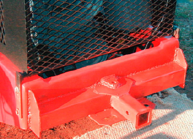

"<font color=orange>Charlie, can you show in a picture how you attached the hitch to the plate? From the one picture it appears you have some type of pin set or is the hitch welded to the plate?
</font color=orange>"
Paul:
Sorry I missed your question last night. We started with the standard Power Trac quick attach plate. A 2" receiver ($19.95 from a trailer supply company) was welded end to the plate at about the center. We then added some flat stock with holes, thus bracing the receiver and providing attachment for the two bottom hooks and the side shackles.
Finally, the multiple ball and pin hitch is an off the shelf purchase. It is held in with the standard pin through the 2" receiver. We can use that insert either on the front or the back, where we welded the receiver a couple of weeks ago. In fact, the multiple ball hitch can also be used in the pickup truck to pull a trailer with the Power Trac on top.
Sorry no picture of the separate insert. My photos are limited since I don't have my own digital camera and haven't gone to the trouble of taking film pictures.

Charlie,
Thanks for the update regarding the hitch, I have a good idea now of what you have put together.
Hate to be a copy-cat, but plan on doing the same based on your experience.

I welded up a trailer hitch like the one that I diagrammed earlier. It still needs some work and painting, but I think it will work. If it doesn't, I've only lost about $20.00 and a dozen welding rods.
