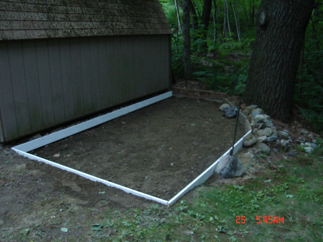

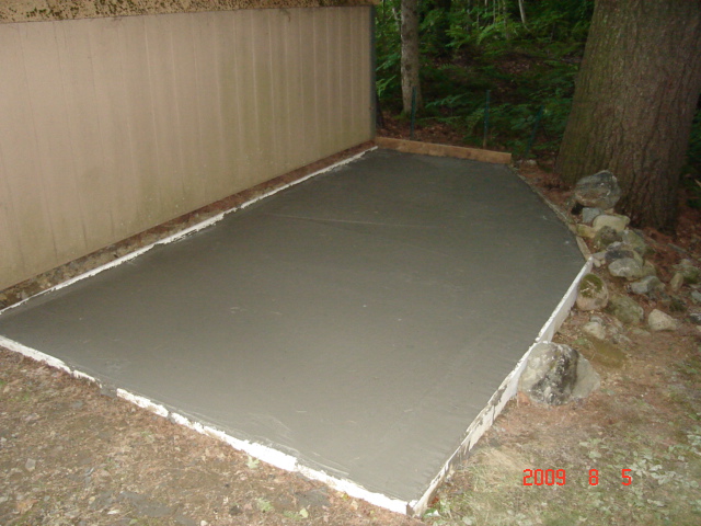

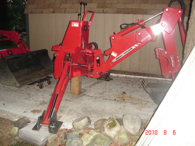

Johnbro-- sounds like maybe you just didn't hit the right combination of control moves to relieve the weight on the pins....?
A small slab is a wonderful thing!
