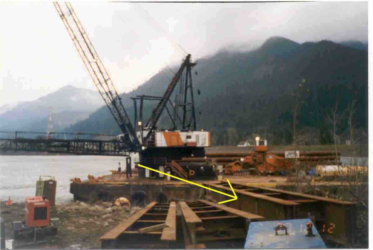

   / practicing with my new mig Question ? #30
I don't know if it was really all that heavy Mark? Splicing 36-inch x 300 pound I-beams. Well I guess you can't just throw them on your shoulder and walk off tho. :laughing:
