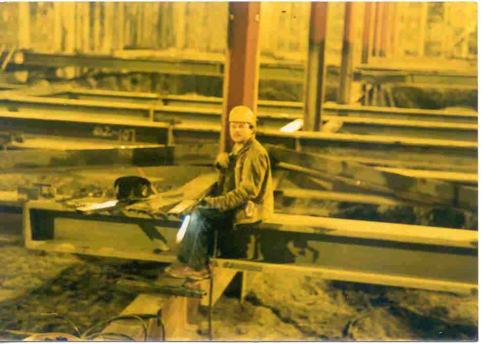

I think these were W14-inch x 311-pound beams. Something like 2 1/4-inch thick flanges.:D
I'll bet you weld that out "quick a minute":laughing:
Seriously, how long to fit and weld out a joint like that???
   / practicing with my new mig Question ? #33
A lot of variables to that question. If at all possible we would try and weld everything flat, (roll it).
It's been so long now I think that job was in 1987. I would guess 5 to 6-hours, if everything went right.:rolleyes: :D
Not as long as I thought it would take, we recently put in some 12" sch 40 steam main and that was about 3 hrs per joint, B31.1 of course.
