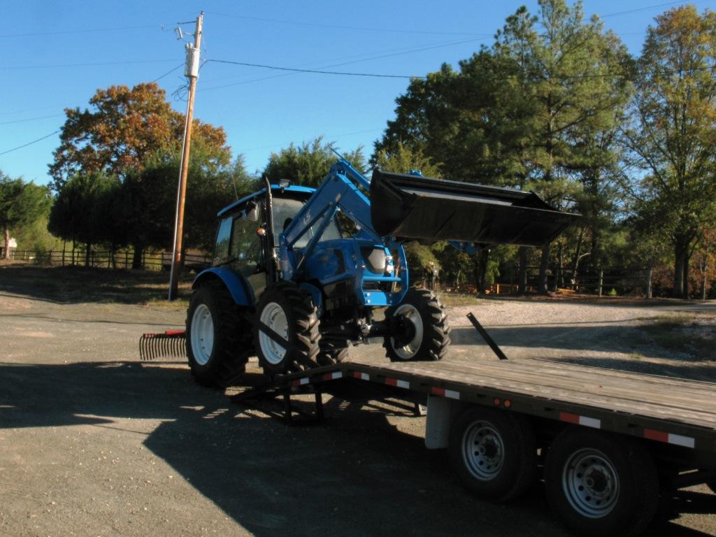

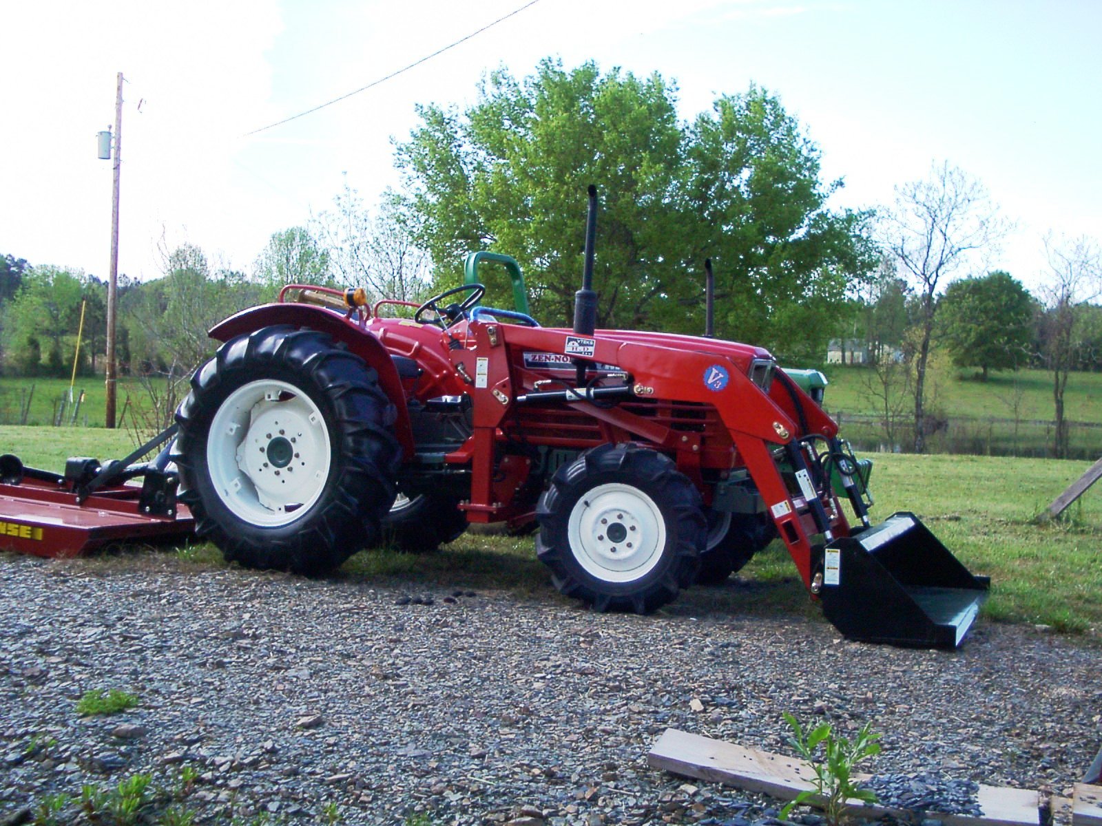

Mine LS bucket has no holes anywhere. It is water tight. So was my V3 loader on my graymarket Yanmar until I drilled the 2 holes for the tooth bar in the 1/4" thick side plates
