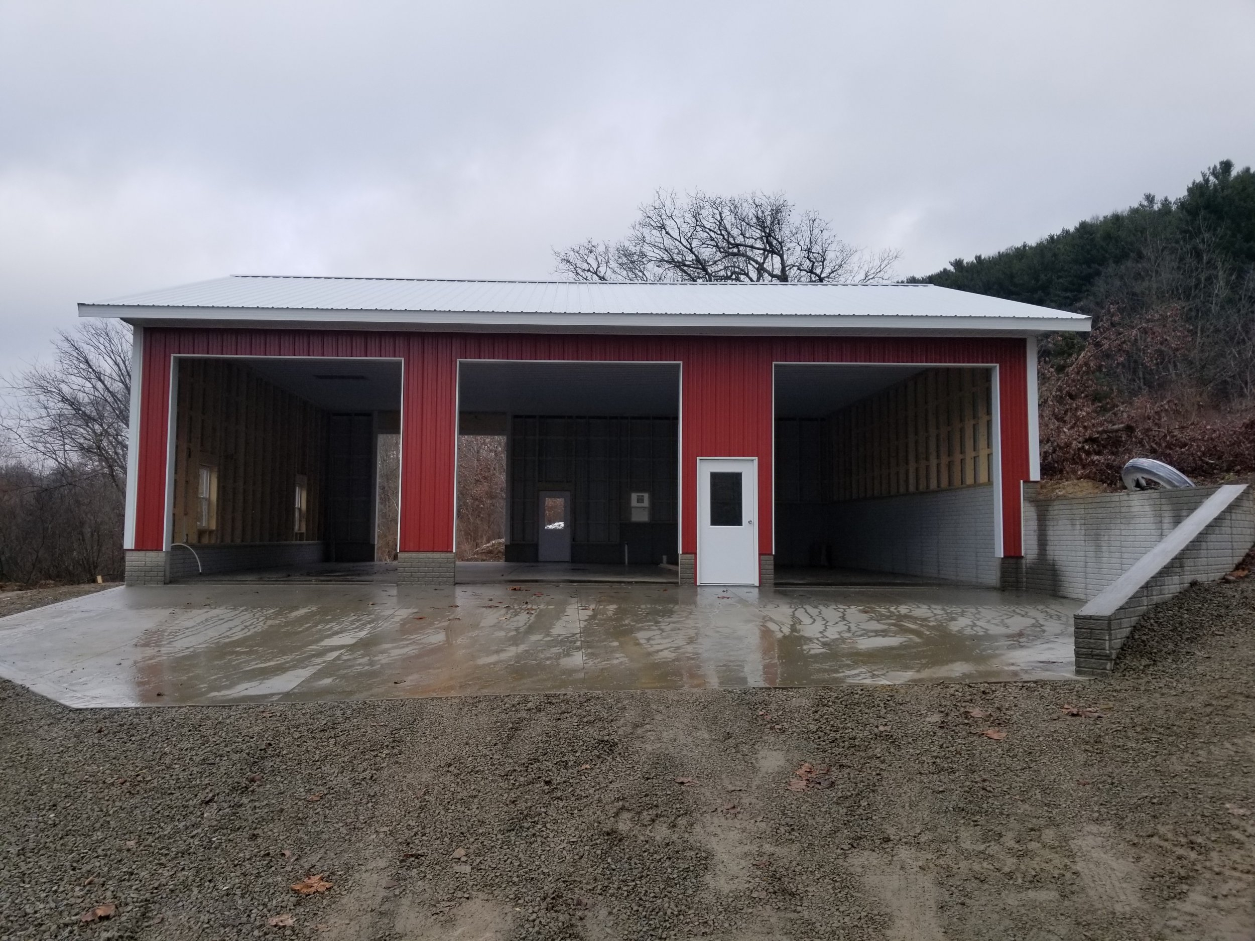

When buying trusses you need to spec the live load you intend to put on them, ie the weight of insulation and ceiling. For a house they will probably include live load, for a barn probably not. If you spec floor space built in, it will have at least 30 psf built in. It’s up to you to specify. The trusses will come with the paperwork to show the inspector IF you pay for engineered stamped drawings.
That is good to know. Probably will not need storage or insulation but there will be a ceiling, lights and probably some fans.
   / Pre-fab trusses for shed style shop? #43
I'll amplify the guy who said to get larger overhangs than you think you need. The taller the building the larger the overhang. We built a 40x60 3-bay outbuilding last year, three 14ft tall doors, with a 4 foot overhang front and back and it ended up perfect
And don't bother building your own trusses. Too much time and frustration.
