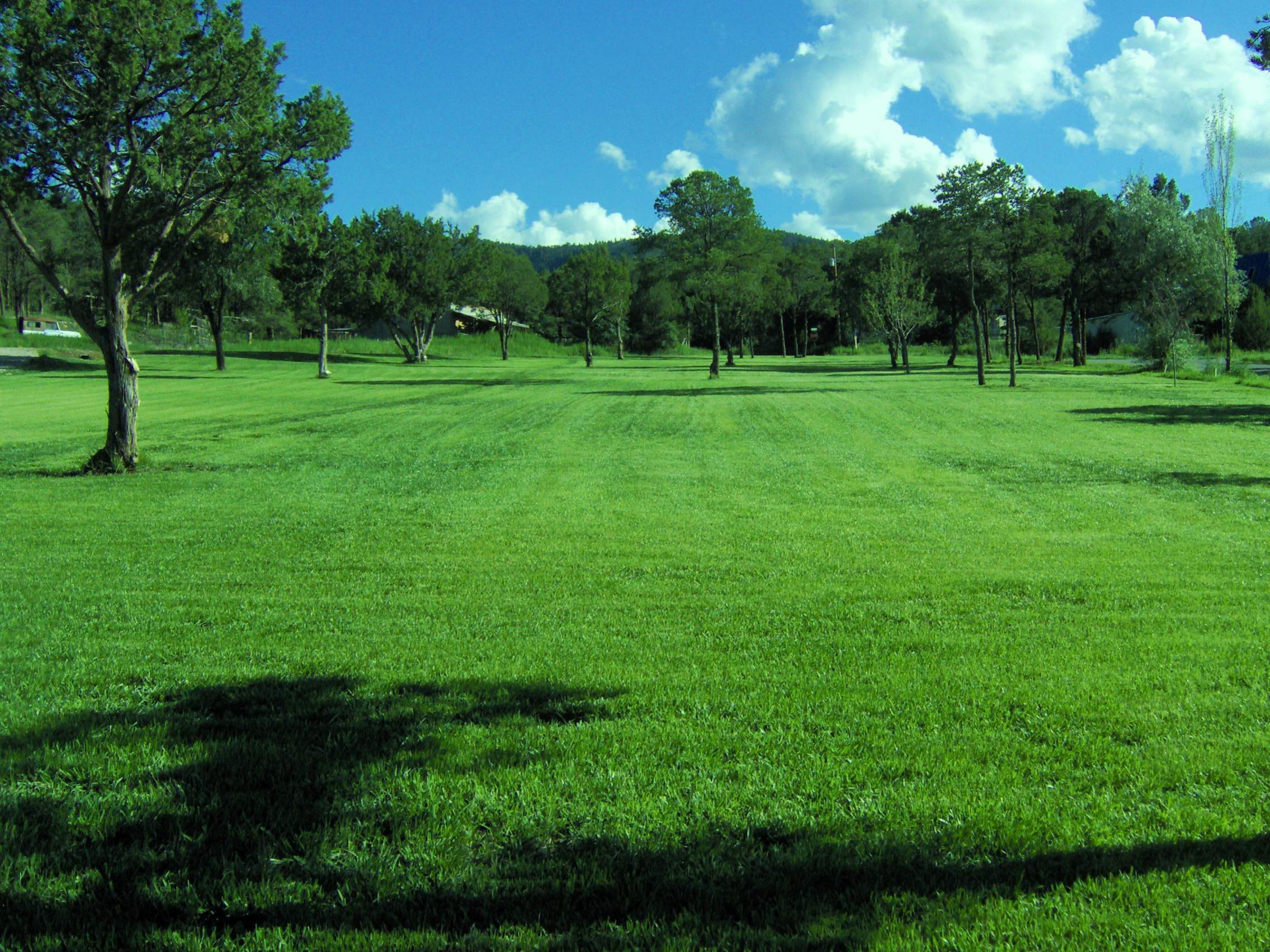

My lawn below was seeded at 350 lbs./acre in tall Fescue. Planted in late August and used sprinklers to get started. Never had any weed killer on it. It has had starter fertilizers, root stimulators in the fall, Ironite once a year and some Nitrogen based fertilizers as needed.

Thanks everyone for the advice provided, very much appreciated.
Jenkinsph,
Your lawn in the picture looks great. So my plan was to wait and till a little bit closer to fall. Hopefully by doing this the seeds that are brought up will die over the winter. Can you explain your thoughts around broadcasting annual rye? Did you mean to do this this year? What exactly will this do and do I just till it up again next year prior to seeding the grass?
Wished I had that grass here n Texas.

I don't think you ever get rid of all weed seeds, ain't happening. But it is possible with proper timing and grass seed density to grow grass roots that will limit the weeds from coming up. I suspect in Canada you could plant earlier maybe August 1st. and have a better head start on the grass and root growth. Irrigation is important for my locale (in southeast New Mexico) and suspect for good results is important everywhere as it allows timing the application for optimum root growth. Most of the weeds I have to deal with seem to come up in May but if tilled up in mid August will not come back until the following year. The key is to get the grass and subsequent roots growing to block the weeds before next May.
Over the winter at least in my locale the grass may brown out but the roots are still growing. I do what ever I can to promote the root growth from Dec. through Feb. applying root stimulator and watering. I also promote the importance of getting a good soil analysis early on in the project to see what amendments are needed prior to planting. Some of these amendments need time to work and that should be accounted for.
I prefer tilling prior to planting, I have had better results with uniform seedbeds this way. I have spent the last few years improving my own skills in finish grading and smoothing. Combining a smooth, tilled, and rolled seedbed helps quite a lot with the end result a smooth lawn without bumps or any ponding with good drainage. This makes mowing and maintaining the lawn so much easier to do.
I suggested rye grass as a cover crop to provide a more respectable appearance over the winter months this year. It also helps provide a little organic growth which can be helpful in many areas. Rye grass, local grasses and weeds can all be tilled under prior to planting your new prepared seedbed. The green manure helps more than some might think.
