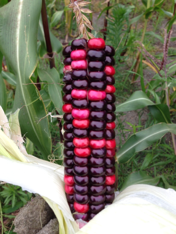

One of the many color combinations, for those curious.

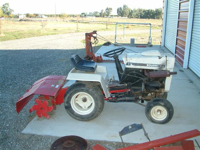

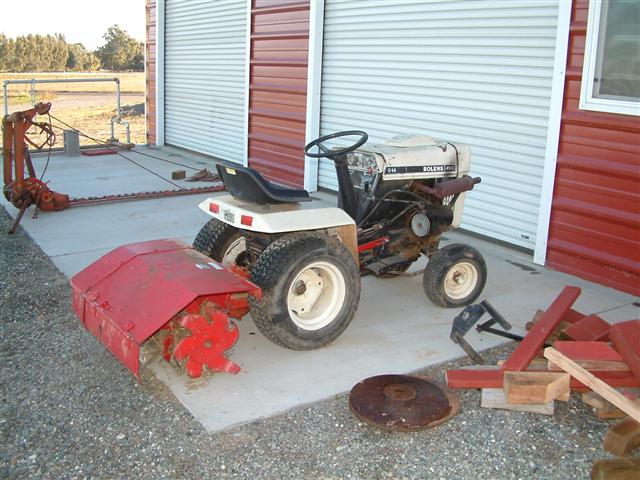

You could step up to a garden tractor with pto driven rototiller. I bought a 1970s vintage Bolens G1453 GT with rototiller locally off Craigslist for $600.
Good luck
