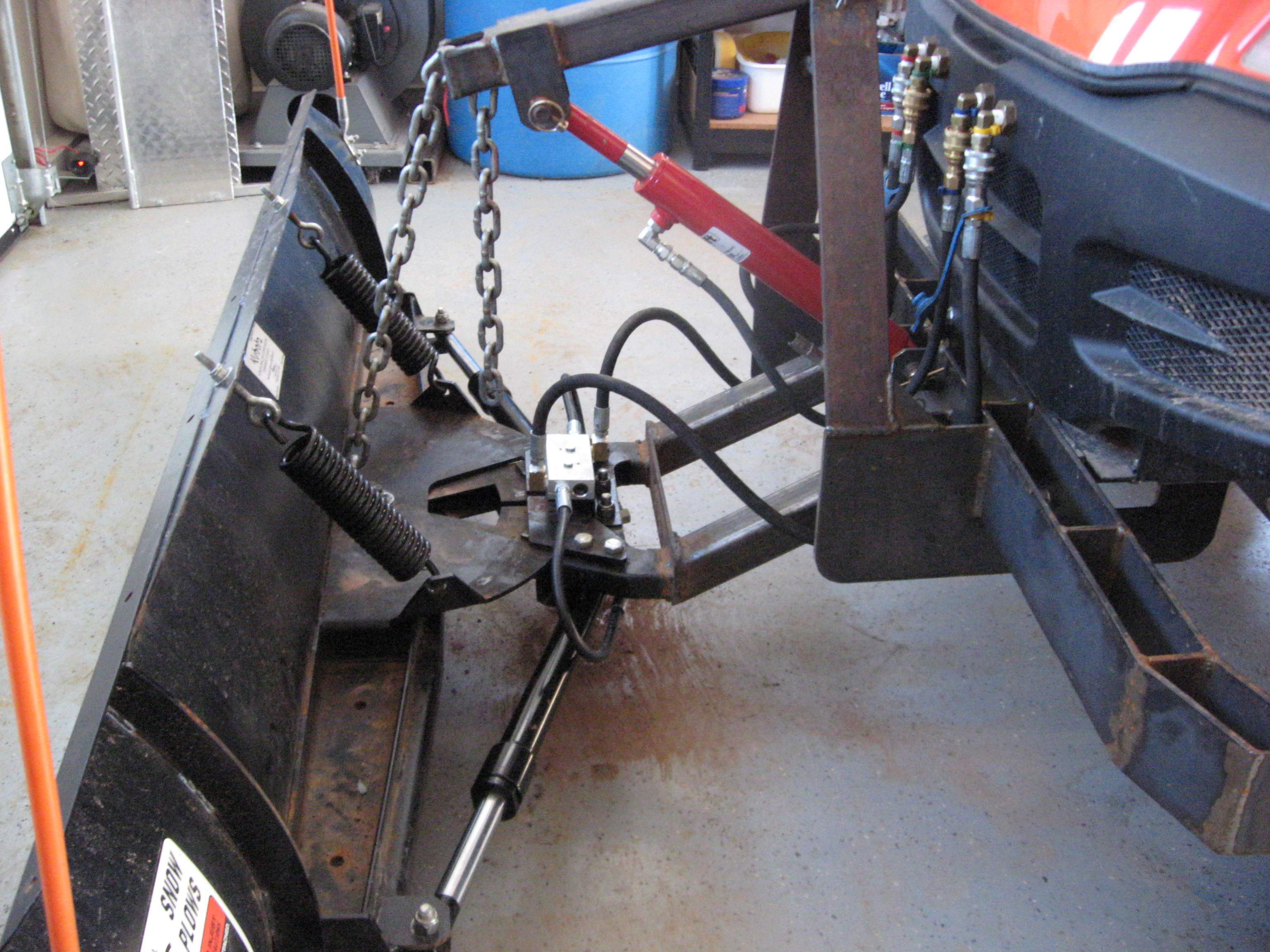

Well it looks like I'll go with my #6 post conclusions.
Re-install the pressure relief block for the two sa left/right swing cylinders.
Good protection for shock loads.
I only took it off when trying out the 12v selector valve and didn't realize the benefits of a pressure relief block. And it was removed because the selector valve was out on the plow not in under the hood. When I switched this system from my old 900 to the 1100 I moved the selector in under the hood and forgot all about the relief valve. Until the other day when I spied it in my junk box.
I didn't mean to create such a flurry of activity. But all very educational.

Most truck plows use 2 single action cylinders and the valve (crossover valve) would dump the excessive pressure load over to the other line.
The unfortunate thing is that only the leading plow corner is protected, i.e. if angled full right and U hit a curb with right corner of blade, there is nowhere for the blade to go.
If blade is square to the front, then both corners are protected.

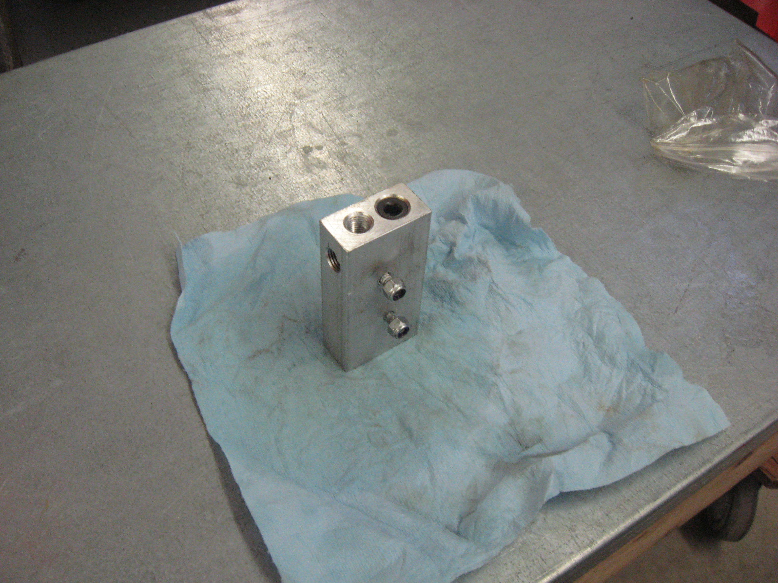

The valve in the picture looks to me as a straight PRV and not a crossover valve as a crossover would have 4 ports (2 per side)and the one shown can only have 2 from the PIX.
   / Pressure Relief Block, Curtis plow
#27
The block does have 4 ports.
The other end looks like this one pictured here.

Well I got my pressure relief block back on the curtis plow and my welder finished the last modification to the a-frame. Plowed another 4" of snow this morning, works great.:thumbsup:
Thanks for all the input.
