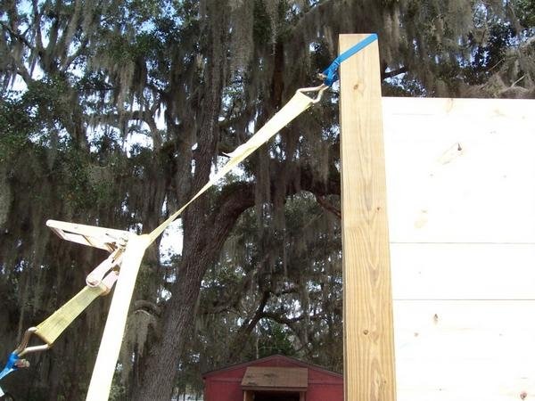

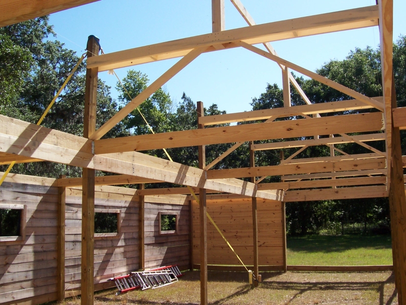

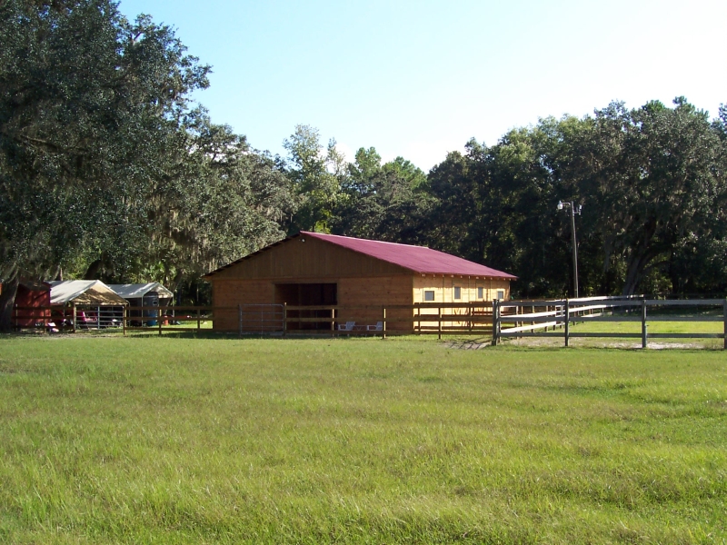

I am with you... I started work on my pole barn and it took over 6 month to get it done, my post were a mess and to make matters worse, they were 4x6 post. What I ended up doing was using tie down straps, placed here, there and where ever else to make the poles true again, while strapped is when I added my 2x8s to keep everything true. It worked, thank God, because I thought I had a bigger mess that I wouldn't be able to fix. I'll post a few photos for the heck of it.

And a photo of the inside...
:thumbsup: congrats!
Looks like everything turned out really well!
