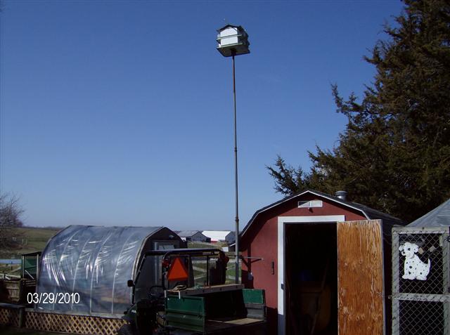

grnspot110: great garden. Having a greenhouse sure would be nice. Im figuring if i do a raised bed, i can make arches out of PVC and cover with poly... to make a poor mans greenhouse.
That's what my greenhouse is! 10' x 10', 4' x 6' CCA sill, 1 4x4 post on the south end, two on the north, a 2x10 ridge board down the center w/holes for the 1' schedule 40 pvc pipe, 1/2" rebar through the sill & up the pipe a ways. Used aluminum storm door on the north. double wall (greenhouse film) plastic has to be replace every couple of years, inflated with a small dble. squirrel cage fan, pulling air from outside. ~~ grnspot
