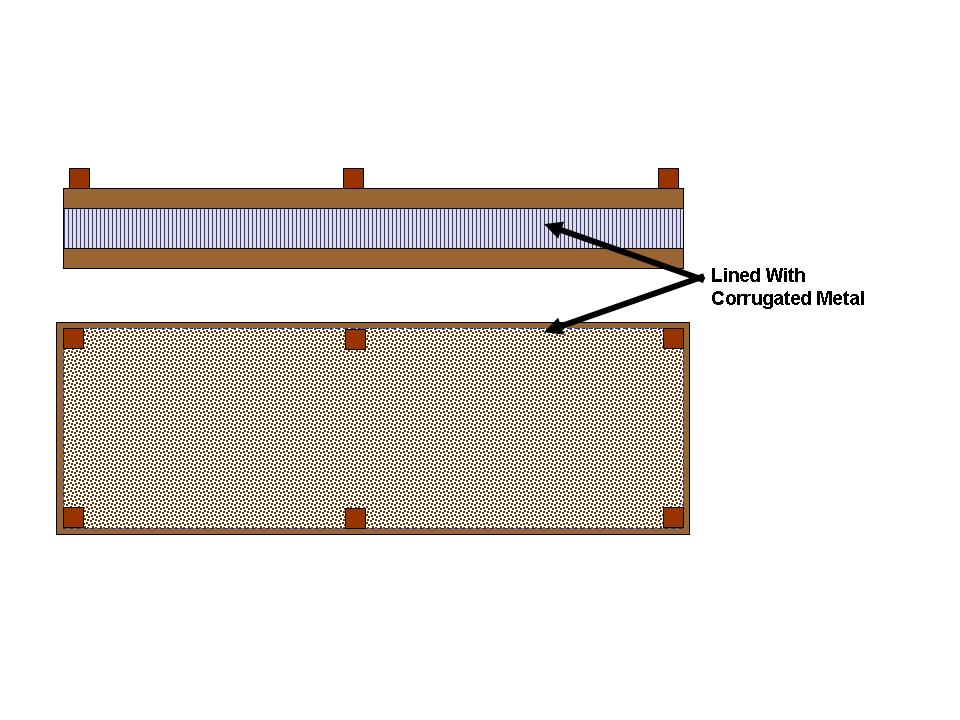

   / Pressure Treated wood for Vegetable Garden? #36
I'm thinking about a raised bed that is lined with corrugated metal as shown below. If the metal is screwed to 1x4 cedar, it will add strength/stiffness to the wall structure. Place a few short posts at the corners. These don't even have to go into the ground. You can lift the structure off the soil once growing season is over. I believe this type of structure would be fine for small flower and/or vegetable bedding. The hardest part will be cutting cross-sections of corrugated metal and screwing them to the frames. Once sides and ends are built, they can be stood up and bolted/screwed/nailed to the posts.
That is a good idea. The corrugated metal here is in 8 and 12 foot lengths and 26 inches wide which would make a decent sized raised bed. Course one could use the colored plastic corrugated roof panels as well. Build a wood frame to hold the panel to make it look batter and cover the edges. That would work real well. Great Idea. :thumbsup:
