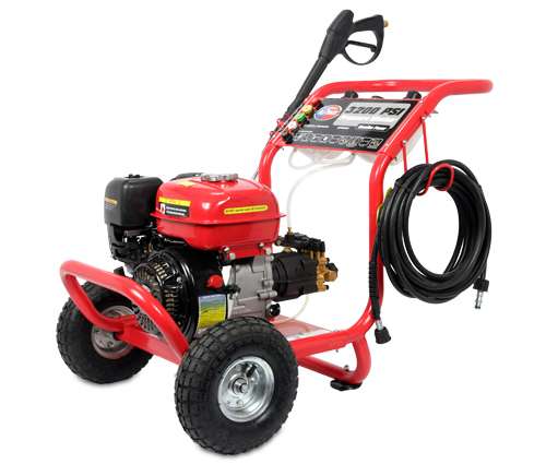

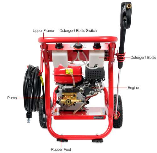

Does anyone know about this product? ( all power ) I guess because I've been doing research on pressure washer, and also because I search Tiger direct electronics, This product pop-up on their site for me to see..... the pressure washer specs look decent 3200 psi / 2.7 gpm, No engine brand or size given, only that it is a 208cc , even though the price of 299.00 is the winner , Not ever heard of the name brand, or could I find any review on it, Could this be another one of them China built stuff ?

At 25 cc per HP, that would equate to about 8.32 HP. They usually de-tune the engines for longivity.
Also, a pump pumping about 2.7 GPM's at 3200 psi would require at least a 6 HP motor.
