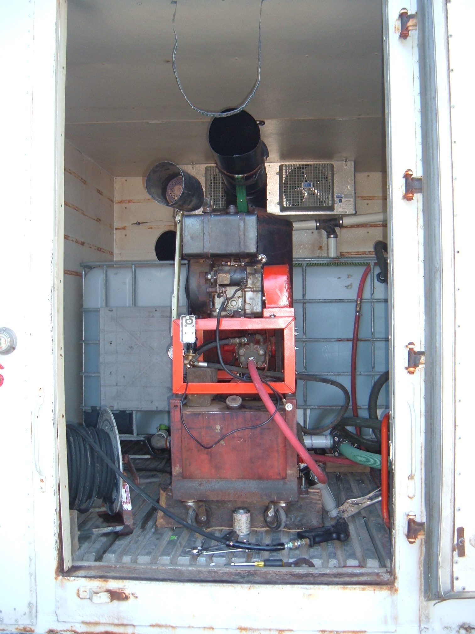

I put together a unit from scraps in a refer truck, it has super insulated body and keep it in the storage during winter and calc it cost about 15 or 20$ to heat. Keeps it out of the way and there is another pump to the right of the door runs at 50+ gpm for a fire hose. 500 gallons of water on board. After I spent an extra 75 or so on valves I found some.
Worked so well that we havnt had another frozen pipe call since I built it.
/ Pressure washer #2
Made smaller one wid pressure cooker & turkey cookin burner somebody threw out cause dey couldn't understand new propane tank wid trilobal valve. Was gonna use a propane can for steam boiler but pressure cooker was 5 bucks in garage sale cause dey couldn't find safety weight.
Did a few water lines and pissed people off how easy steam works. Had more offers to borrow den offers to pay so it sits comfortable on shelf waiting fer payin work. Does make a nice steam boiler for wood bending too.
