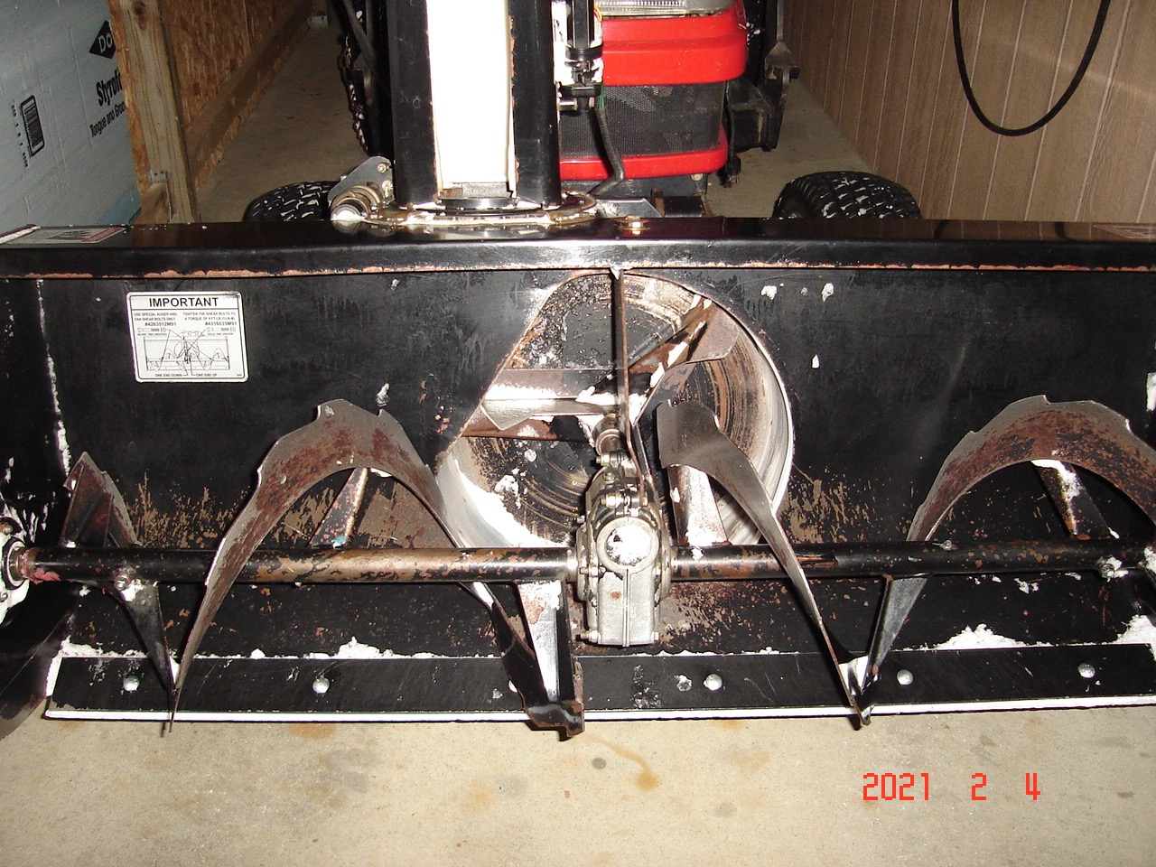

Yep, these things happen. In a couple years you probably won't even notice it -- but for now, you could use a flat body-shop dolly (or some other heavy, flat piece of steel) and hold it behind, then hammer that dent flat.
Here's what mine looks like, now on its 13th season -- (Yes, for some reason mine came in black....)
I certainly wouldn't let you work that ugly nasty thing on MY property.
How can you even publish pictures of something so unsightly?
   / Pretty bummed out ------> UPDATE: All Fixed #22
Well, my driveway's paved now, but initially --and for several years after tractor purchase-- it was gravel.... and we live on a dirt road. That blower's had a pretty tough life, for sure, but it still works! (Man, can that thing shoot rocks!!) :laughing:
