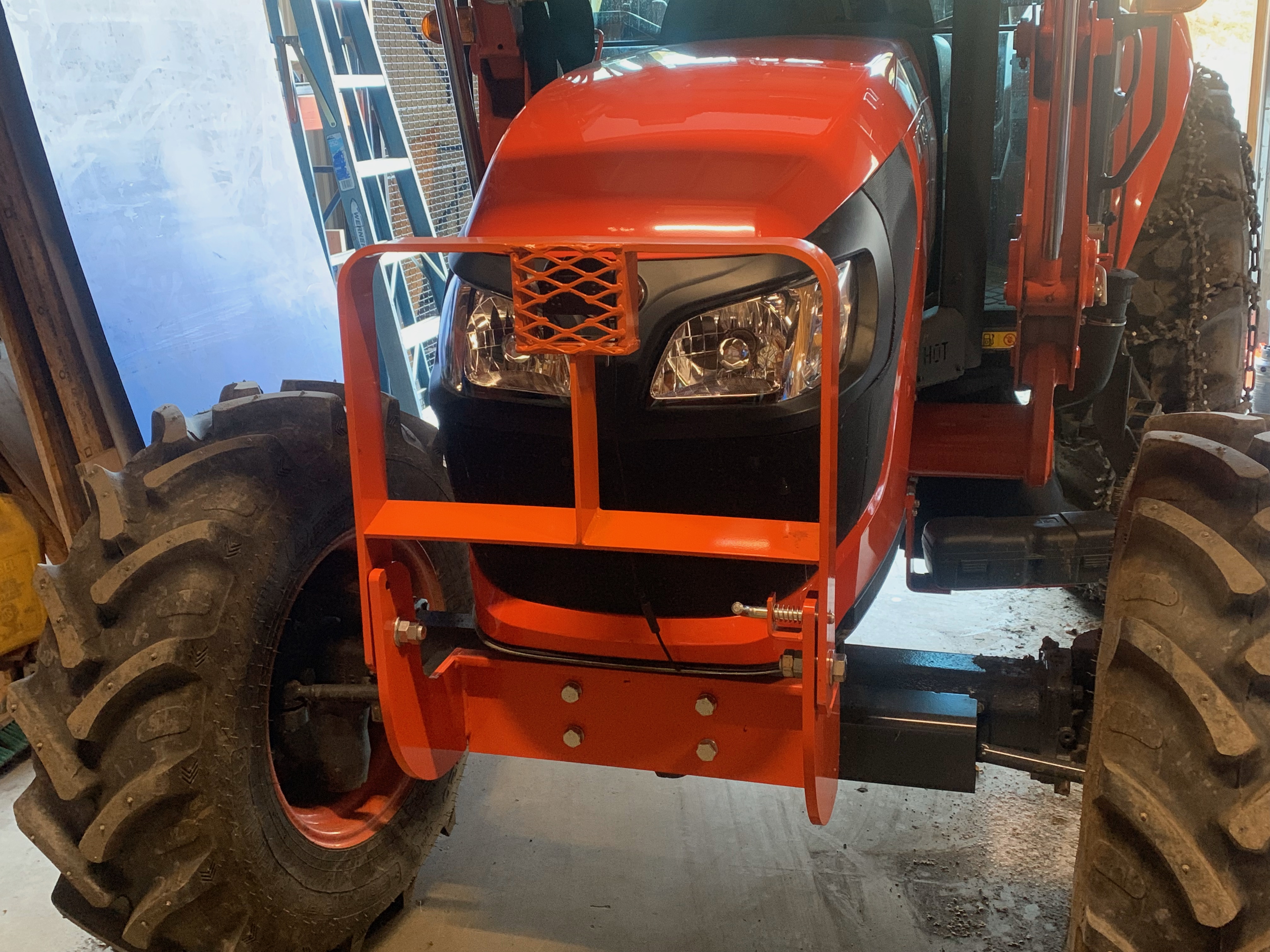

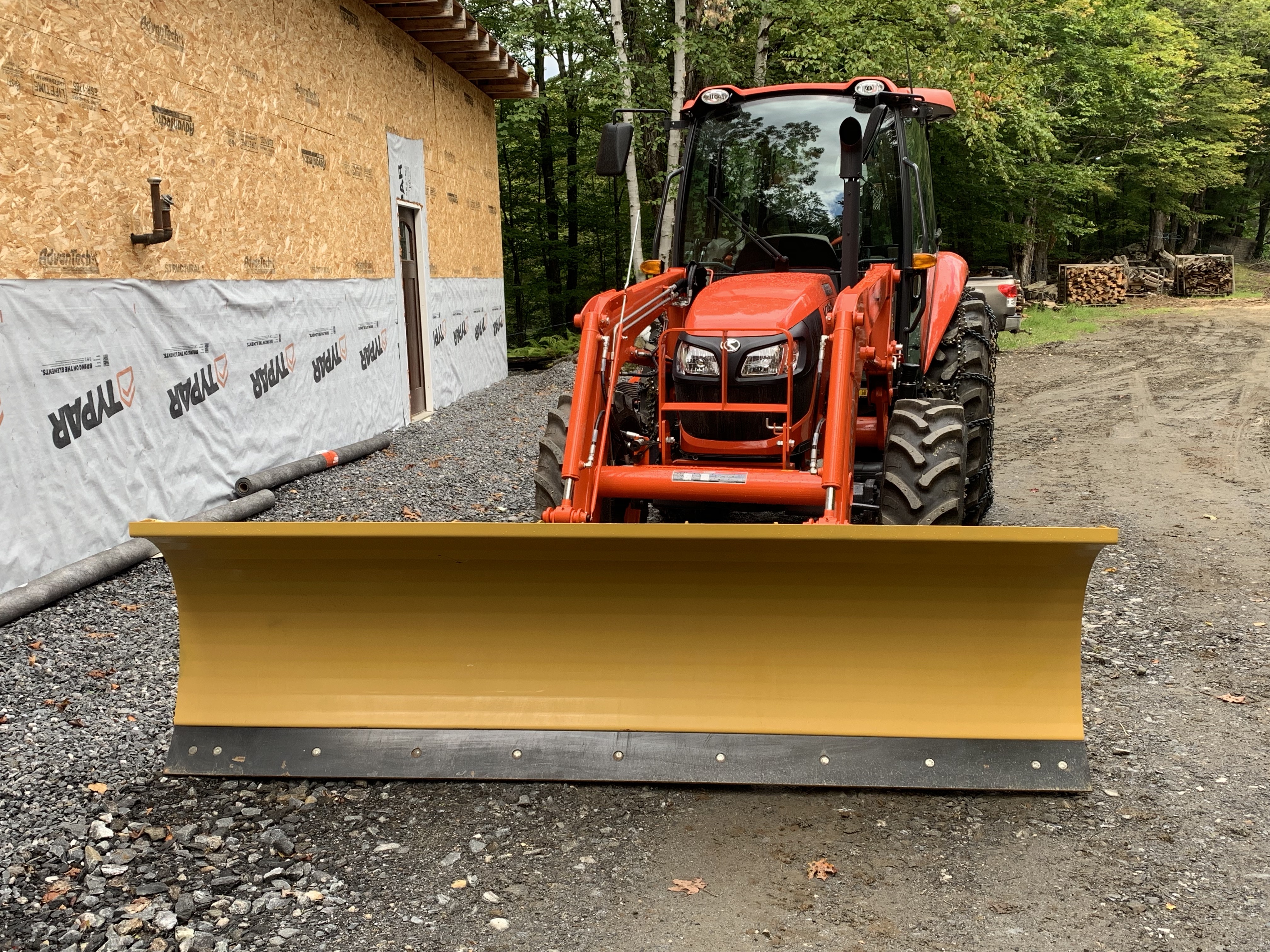

We traded a L4240 for a M7060 Cab a few months back. The M7060 has the R1 tires, chains on the rear, studs in the front, cast rear rims, and filled tires. It has the third function on the loader and a total of three remotes on the rear. The interior has the air seat (awesome) and bluetooth radio.
The upgrade was made to get a tractor with more weight to handled the loads and provide more traction for snowplowing. The cab was added to keep out of foul weather, especially winter time. Our woods have good established trails and new trails can be installed with enough width to avoid issues with a cab in the woods.
I am very happy with the M7060 with it's weight handling (5' tall x 6' long skid of 42" wood), comfort (the air seat, temp control, and radio), and maneuverability. I am in the process of adding a front and rear camera. The front camera will help with attachments and fork placement. The rear camera will help reduce the amount of turning around when using the rear blade and power rake.
Here is a picture:
