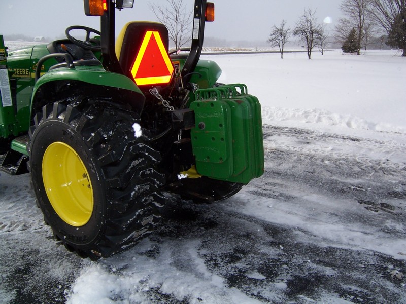

   / Price of JD Ballast Box New - Used? #12
Yesterday I bought a new JD ballast box for $206.00 in Manassas, VA

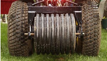

   / Price of JD Ballast Box New - Used? #13
My home made ballast.Some old plate and the remains from an old car lift head,best part is I dont need the tractor to move them since the heaviest weight is only about 100 lbs,total a little under 800 lbs.It also doesn,t hang on the hydraulics its solid mounted to tractor with 3pt arms removed.

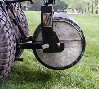

   / Price of JD Ballast Box New - Used? #14
Get a 15-25 gal plastic drum and fill it with cement. Same idea as the box but the plastic will stay in better shape. Lay it on its side and cut holes in the ends or use it straignt up and down. Run a draw bar thru it to attach your arms to. 25 gal of concrete is just under 500lbs. I've got the formula if anyone needs it.
