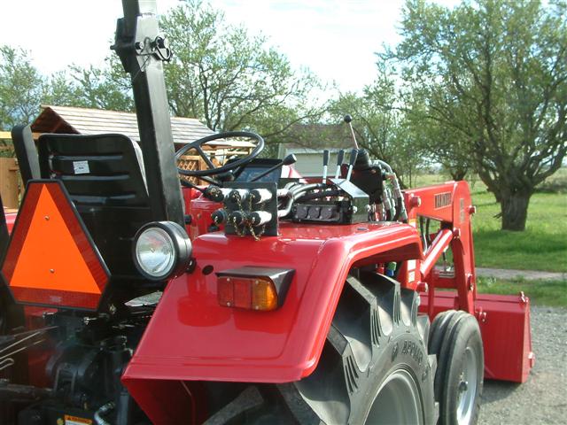

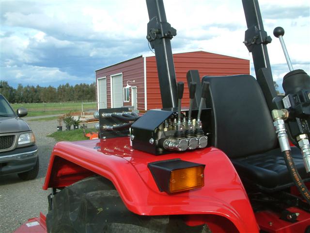

My Mahindra 5525 has dealer-installed triple hydraulic remotes--cost $700. Bought the remotes as part of the tractor package and is the dealer's own design.
This tells you right away--your dealer is marking up the cost of the parts and is really socking it to you for labor. The parts for my setup run about $600 (valves, hoses, quick disconnects).

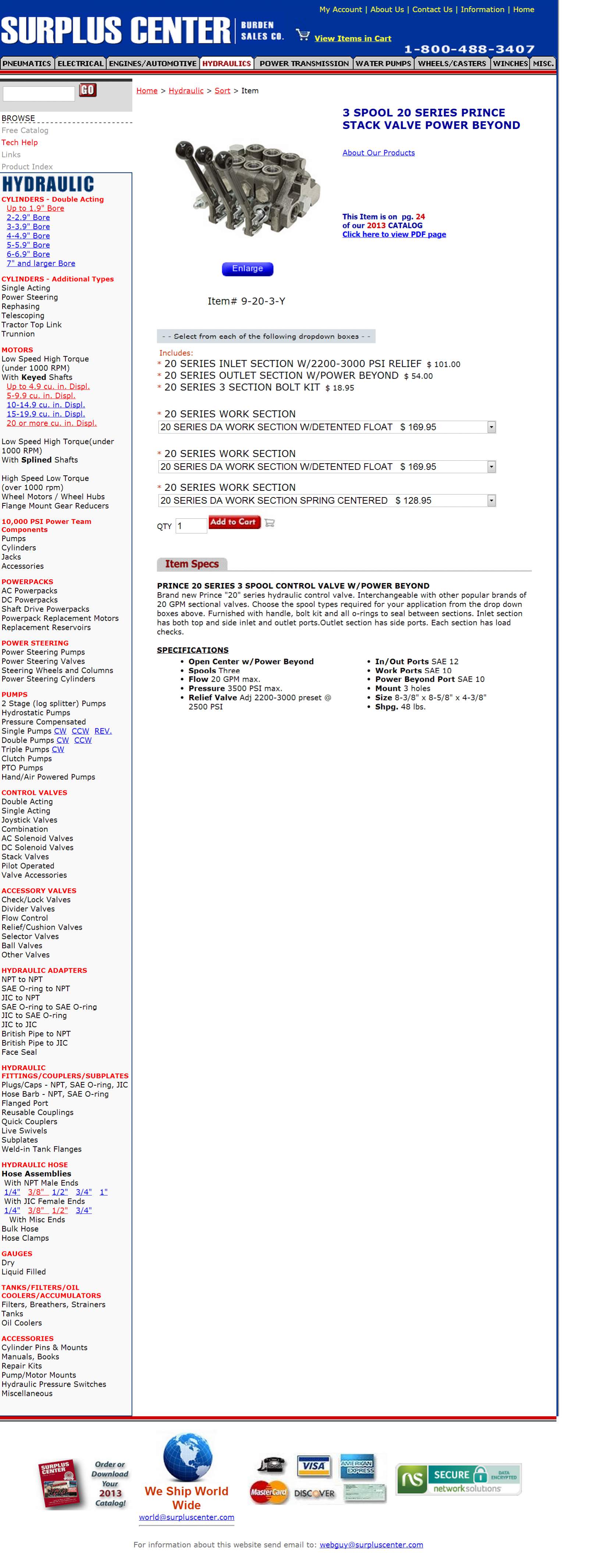

You can do this if you have any mechanical ability.
Not only will you learn, you will know how to take it all apart and fix if necessary.
Order this kit if you want 3 spools, two with float for T-N-T, and 1 spool for spring center action. 4 spools will cost a little more.
Order a 3000 psi hyd gage also.
No way is this going to cost over $800.
Be careful, they/someone will spend your money real quick
Y&catname=hydraulic]Surplus Center - 3 SPOOL 20 SERIES PRINCE STACK VALVE POWER BEYOND[/url]
$369.90
Add some hoses, fittings, a mount for the remote , and some QD's, and you are done, saving bunches of dollars.
