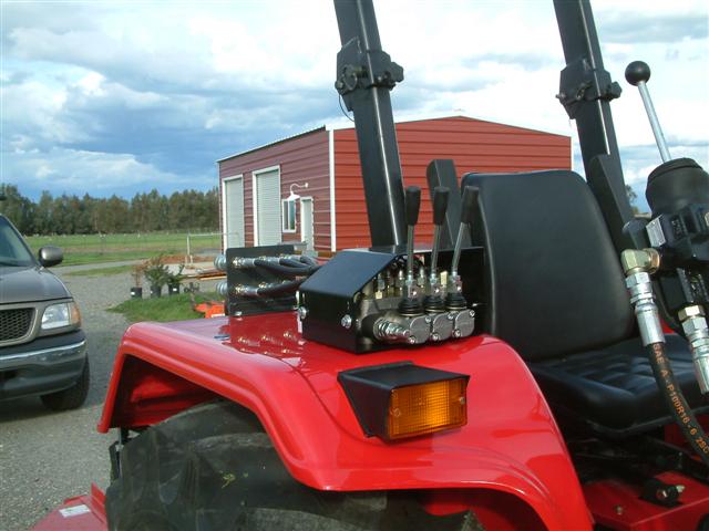

My Mahindra 5525 has dealer-installed triple hydraulic remotes--cost $700. Bought the remotes as part of the tractor package and is the dealer's own design.
View attachment 338352View attachment 338353
This tells you right away--your dealer is marking up the cost of the parts and is really socking it to you for labor. The parts for my setup run about $600 (valves, hoses, quick disconnects).
