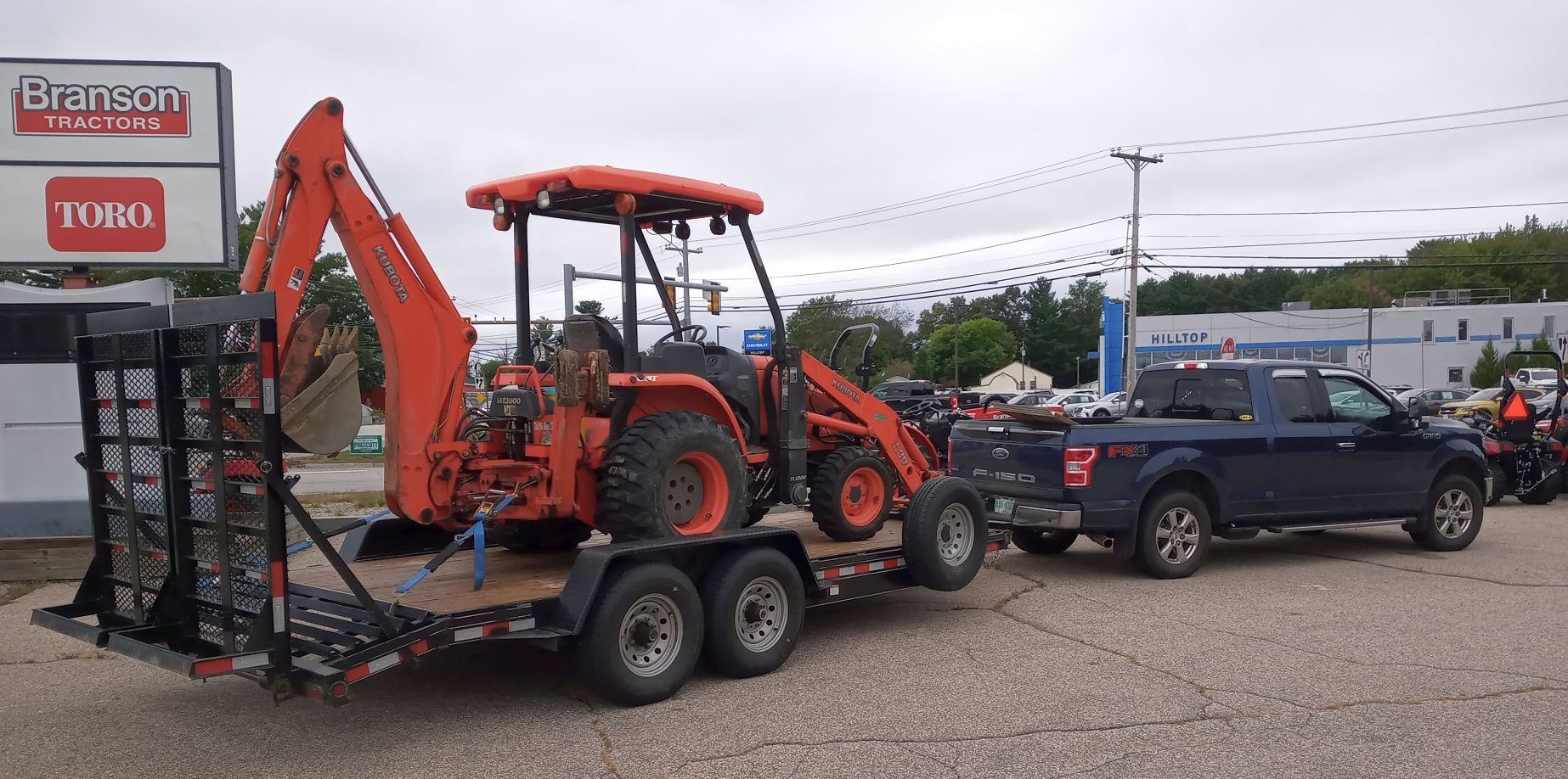

I tow using a 2018 F-150 that we factory ordered with a 11,300lb tow package. Added air springs also. F-150 bought off a dealer lot maxes out at 9,000 Lbs. with std. tow package.
Too little truck for hauling L47, etc.
Our F-150 and HD trailer handles the 11,000 lb load surprisingly ok, but glad I'm not in the Rocky's or towing on a daily basis.

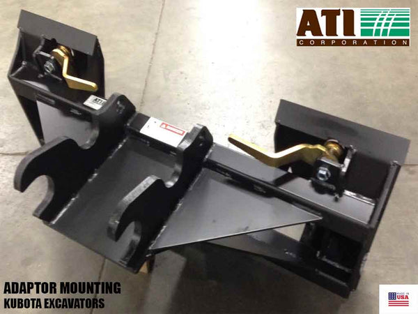

Mr M59 has figured out how to get the more popular and more variety of miniX attachments to fit the larger Kubota TLBs at reasonable cost with minor modifications. With his help I’m trying the same thing.
