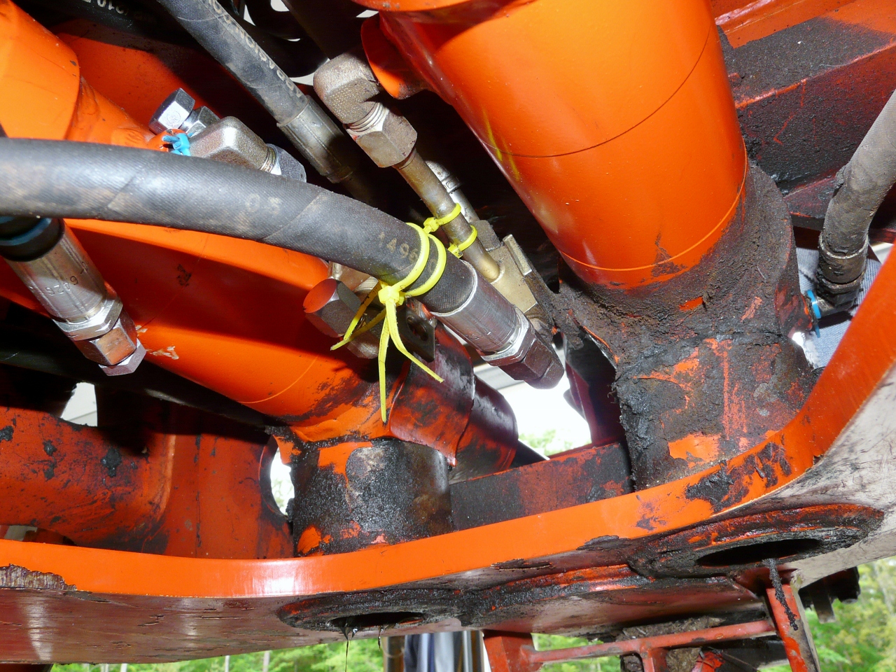

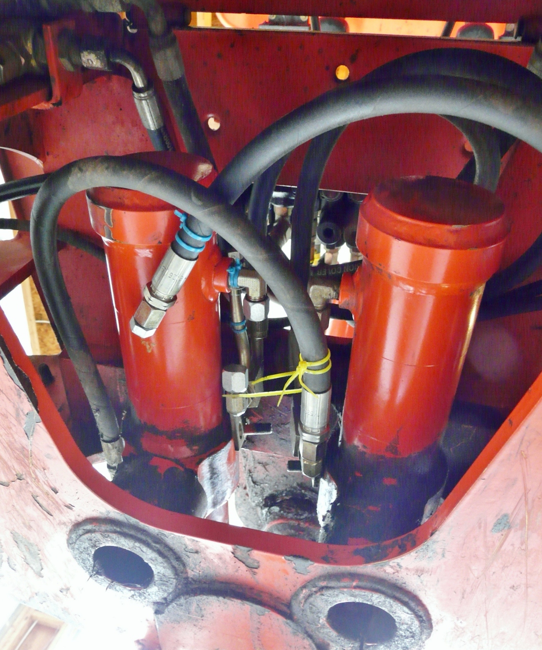

Update: Upsized Hydraulic Clyinders for Loaders, Started my L39 2000 Hr Hyd. Overhaul
I am having thw BT1000 Trunion Swing Cylinders rebuild, after sustaining piston damage in one swing cylinder.
I am using the guts from the loader curl cylinder and original rod from the lift cylinder to build a 60mm bore lift cylinder, upsized from the OEM 55 Mm bore. This alone will provide 19% more lift.
Factoring in I have the relieve set at a bit over 3000 Psig should give the lift capacity at ground level near 4,000 Lbs.
For the bucket curl cylinder I am importing from the UK a 66mm custom sized cylinder that will provide near 32% additional curl force.
If you think that is too much, note that I upgraded my Max 28 Mahindra curl cylinders with Mahindra curl cylinders form their 1526 tractor and gained 62% force. The bucket moves noticeably slower, but is not terribly slow. The Larger pump of the L39 will compensate a lot for the increased cylinder volume, as the loader on these commercial machines are relatively fast and strong compared to the general use farm tractors.
The L39 upgrade will also include new bushings and some new pins as well as some weld repair/reinforcement.
This is not going to be cheap, as the rebuild/upgrade turning out to be at least twice as costly as I anticipated, but I plan on keeping the machine for another 2000 hours.
Like i now operate the Mahindra, I'll do most of my L39 loader work in 2WD except in real slippery stuff to save the front axles drive components.
At +8,000 lbs operating weight, you will have trouble finding a tractor in it's size range anywhere as strong or capable.

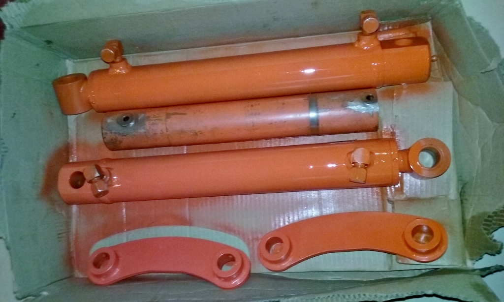

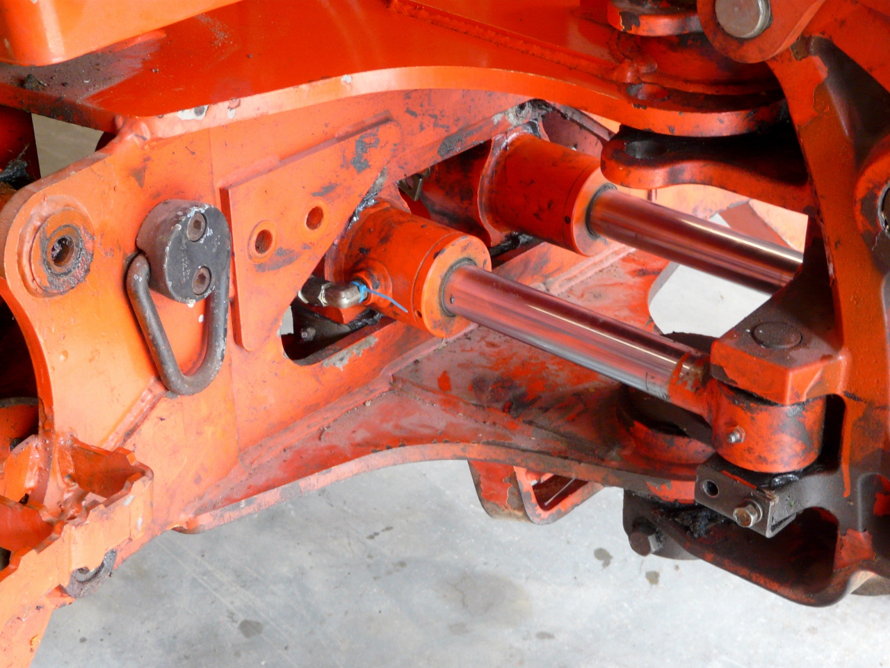

My up-sized Hydraulic cylinders for the Loader curl function are finally back from the shop.
The loader will be put together just in time to mount the Fisher plow. I might as well just put on the snow chains also.
I have the rebuilt BH swing cylinder and the up-sized 60mm Loader curl cylinders installed. Loader Lift OEM cylinders were 55 mm. Changing to 60mm increases hydraulic lift 19%
The 65mm up-sized from 60mm bucket curl cylinders will provide additional 26% curl force, handy for breaking out of a dirt pile. I have also set the hydraulic pressure a bit over 3000 psi. I'll keep it in 2wd, so not to over-stress the front axle while digging.
I've also up sized the bucket curl cylinders in my Mahindra Max28 and found it now digs better in 2WD than it did in 4WD with the OEM bucket cylinders. The Max28 has the loader capacity of a small l series Kubota.
The L39 should have the lift capacity of the old L48, maybe not an M59 , but close enough.

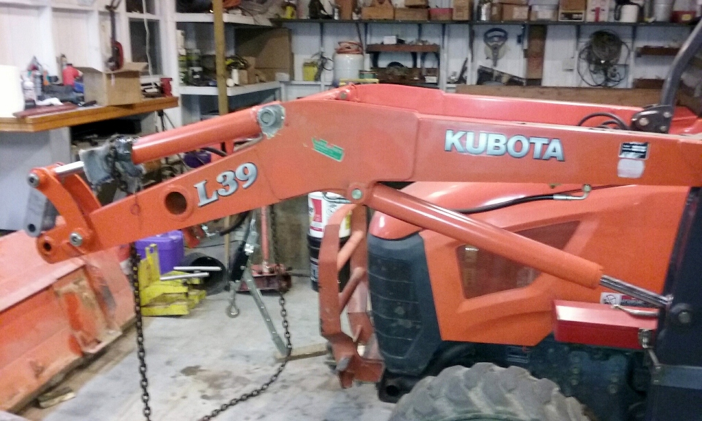

Re: Upsized Hydraulic Clyinders for Loaders, Weld, Paint and Bolt up.

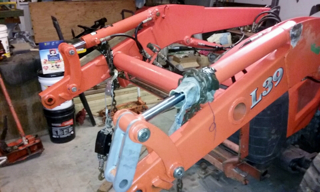

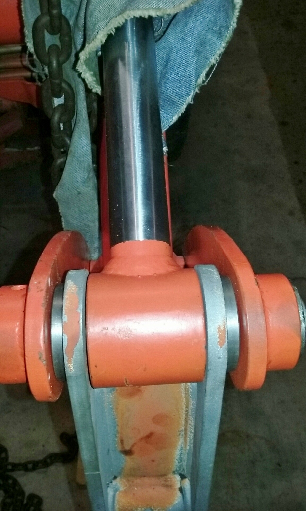

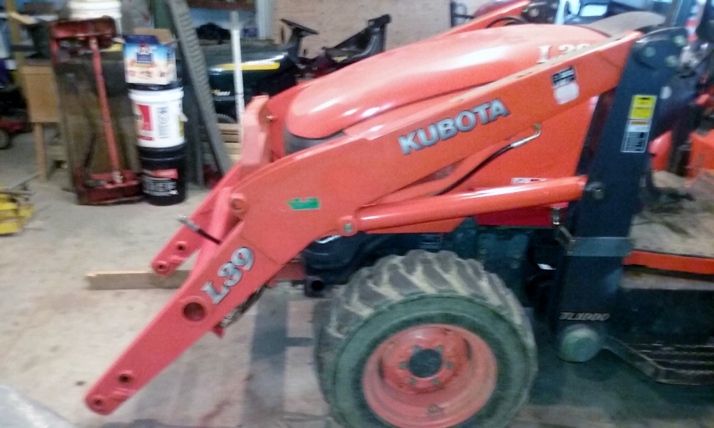

I noticed into a bit of a problem when I fitted the loader curl cylinders to the compensating links that go from the Rod end eyes to the QA.
Right side fit fine, but the let side cylinder angled to the left. I was going to give the cylinder shop an ear full, thinking that the pin ends were not bored square, but trying swapping the good fitting cylinder on the right to the left, same results?
Flipping the cylinder over same results.
Since new, the Kubota's boom loader pin holes were not aligned. The slop in the pin holes was allowing the loader to work all those years. So that explains the rub marks where the comp link and the QA touched. With the rebuild and tight fitting pins, I have a situation where the comp pink binds and puts side load on the cylinders piston rod. As this creates a situation that promotes rod buckling and premature seal failure i needed to fix it.
What a pain. I cut off the pin bushing on the loader boom, egged out the hole a bit wit a die grinder and used a come along to bend the other boom pin bracket. The shadow in the photo makes it look what I had to elongate more than it actually is. I removed less than 1/32" of metal.
Once I reweld the bushing, paint and assemble, I be ready to put the L39 back to work.

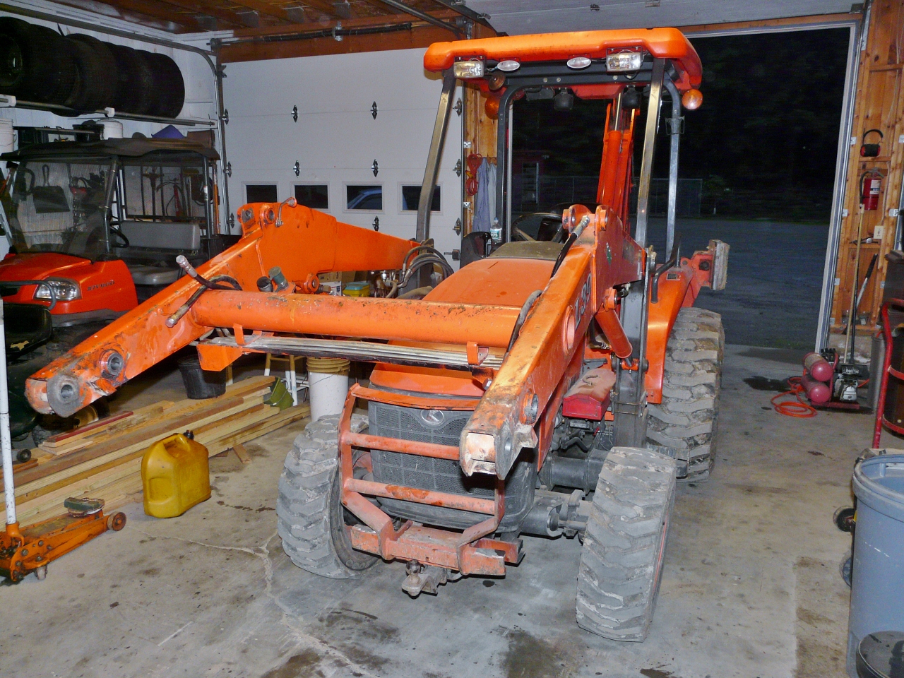

Well, The L39 is finally back together. Loader bucket and QA is all bolted up and painted nice orange.
Maybe I should change the decal on the Loader to TL1300 now, as it actually will lift 1300 Kg. In my case the 1300 Kg rating is close to a true lift capacity 500mm forward of the pins, not at the pins., Naw, why brag.
I have a weeping hydraulic hose to replace, and out to change the engine oil before the snow hits. What a relief to get this over with!
Maybe I have time to do a little dirt work before I hang on the Snow plow.

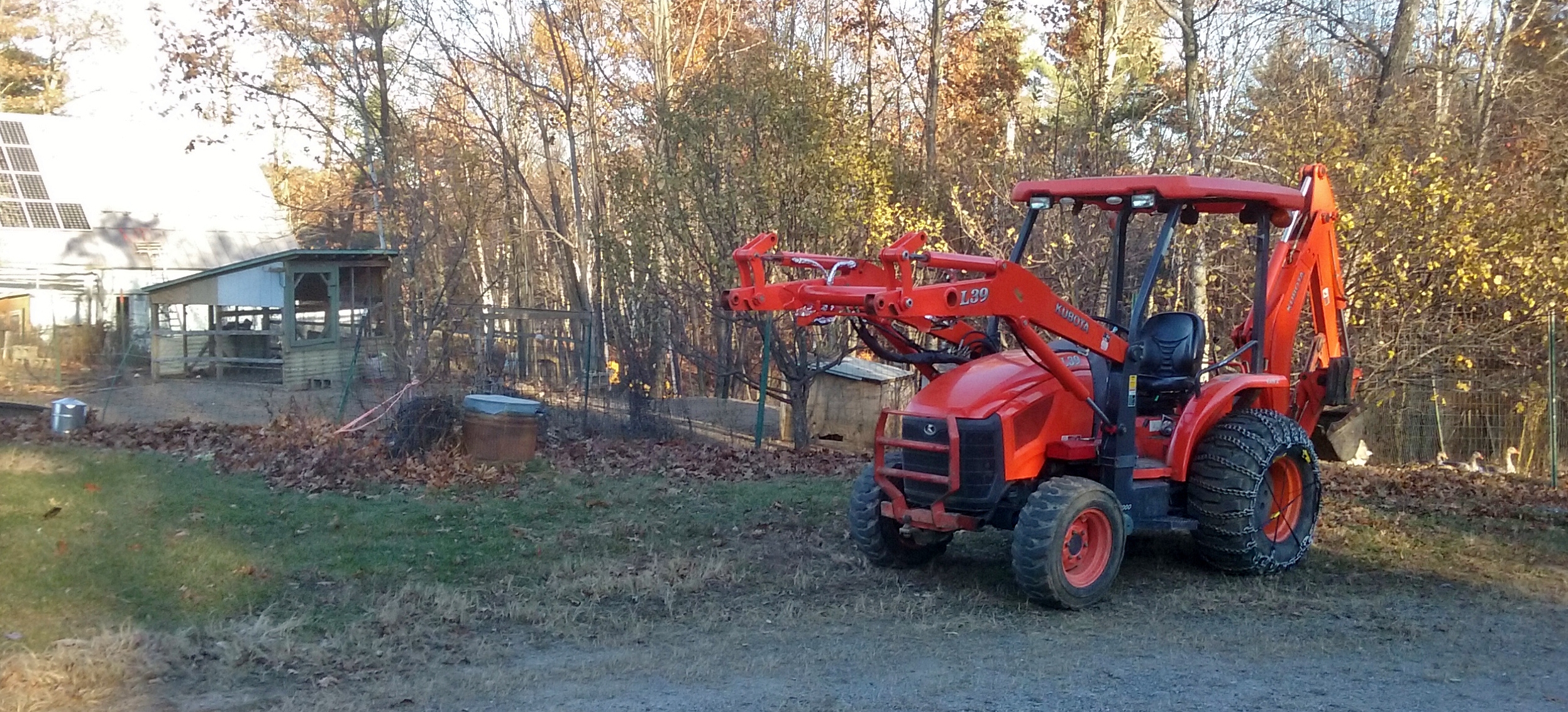

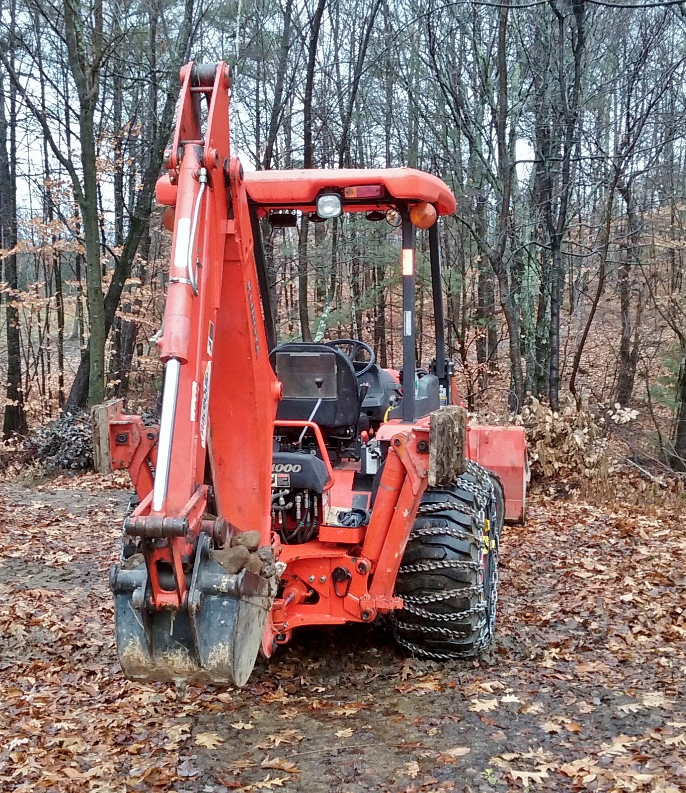

#40
Up sized Hydraulic Cylinders for Loaders, Back together & had to go play in the mud

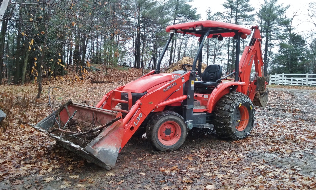

Rotten raw day out and almost got stuck dumping over the edge of the hill, even with chains.
I pulled a small stump on the trail I put in this summer on the right side of the pasture with the Max28.
L39 doesn't look bad for +2000 hours, 11 years old.
