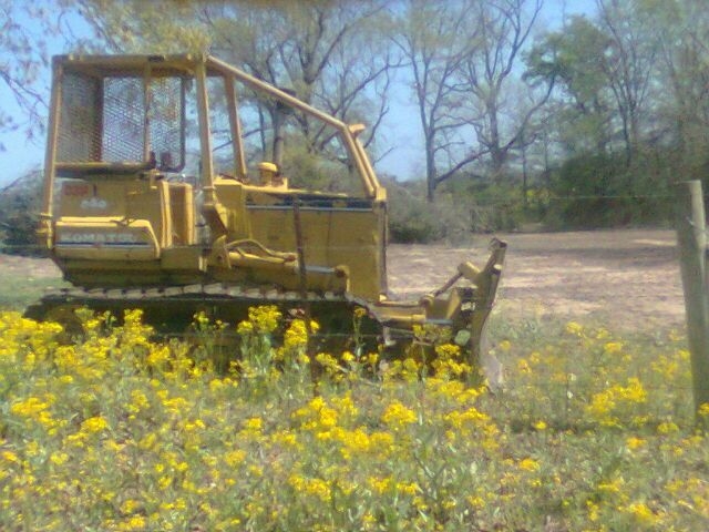

Roughly around $100 an hr for small dozer and 10hr minimum. I bought my dozer for $6500 cple years ago. I cleaned up 1ac.cple weekends ago and it took 2days and it was thick,so im going to say 5/6,000 if you burn the piles yourself and dont take out the big trees. It takes alittle longer to keep the dirt out of the pile having to roll the brush and everything,so pay attention if you get someone to clear it with dozer that he isnt just shoving crap in the pile.

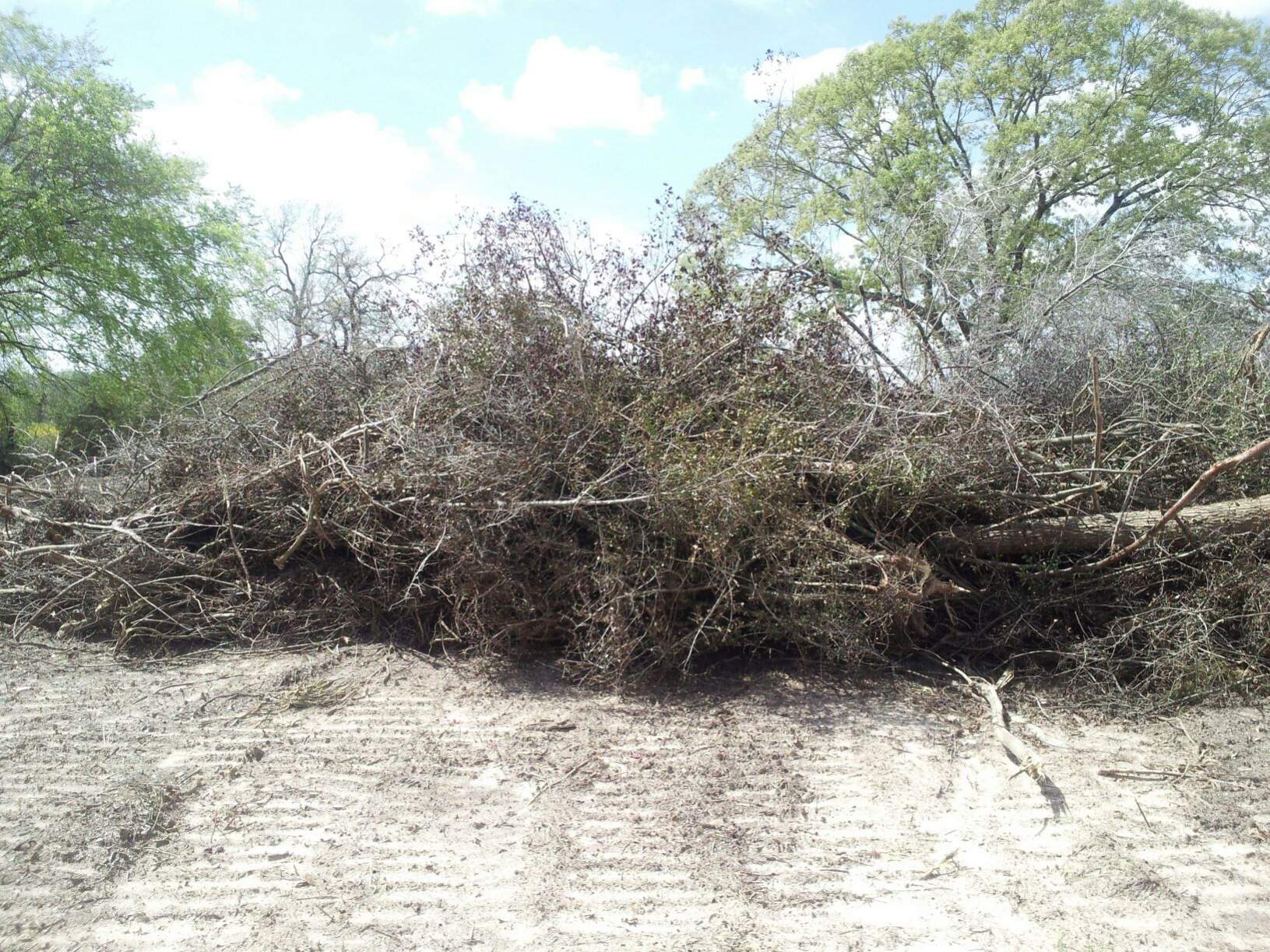

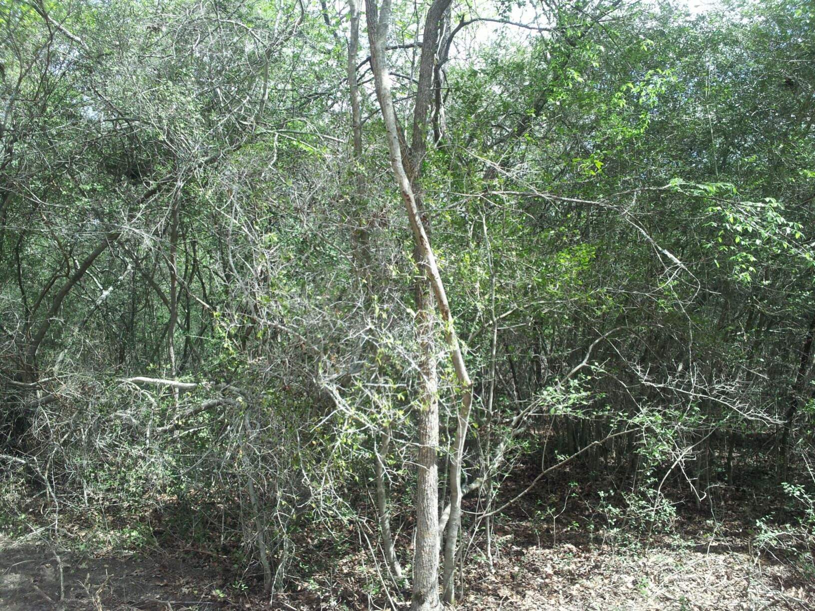

Yeah,its also alot of clean-up after burning it,I can get some photos of mine later,if you wont of how my pile is,should burn up 99% sometimes the bigger tree stumps have alittle dirt on bottum and dont burn up completely. I'll take a picture of my neighbors piles what not to do,when making brush piles(what you can look for. Just give me alittle bit for pictures..
