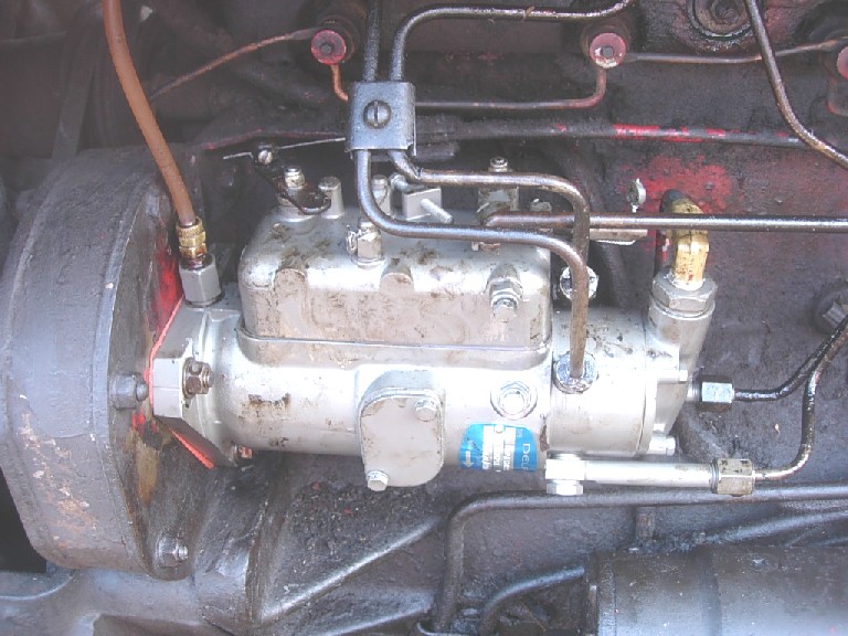

Richard, can you take a few pump close-ups and post them ?

Ok, I took some time out to get a couple pictures.
First picture is of the pump with the fuel lines to injectors attached.
As you can see by the state of shine.... this pump didn't originate off this tractor :eek:

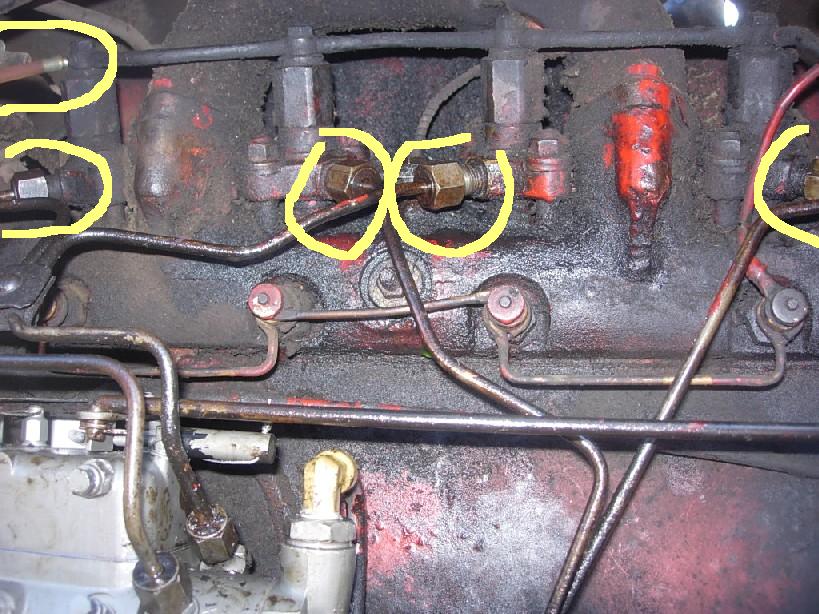

the second picture shows the injectors. The top left circle is the fuel return line and you should be able to ascertain red fuel in there which tells me the pump is pumping SOMETHING??

The end of this pump has a splined shaft, doesn't it ?
Was it splined so it would only fit one way ?
Reason I ask is if it isn't timed correctly, priming it now will be just for practise.
Any hoot, we need a good flow out #1 bleed screw with key off.
DO NOT crank with #1, #2 or any connection between injector pump and fuel tank open. All your going to do is suck in air.
If you can't get full flow from #1, work your way back to tank till fault is found.
The drive shaft has more of what I'd call a keyway. It will only fit in side the drive head one way. It's a slot and pin kind of thing. IF it was out of time, then it would be (I suppose) only one rotation out of whack. The guys at the service shop told me this could NOT happen....that as long as the two were mated properly, there could be no mistiming.
to clarify your instructions above... would you suggest that I tighten down ALL the lines to the injectors or leave them open for a crack of air to bleed out?
I'm beginning to think from what you say, that I need to seal up the entire system and ONLY then, try to bleed that lower port. I'll admit that I do not think I've accomplished that specific goal. I think I've always had the connections at the injectors themselves cracked open (best case) all the way down to totally removed (worst case)
I'll have to give it a try tomorrow. Thanks
