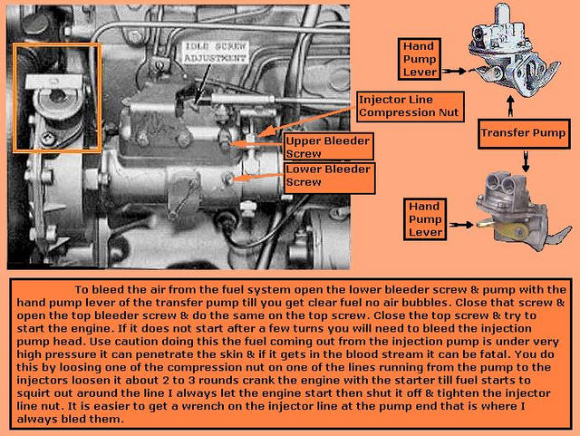

I had exactly the same problem I think. Massive amounts of air in the lines.
open lower bleed . Hand pump untill stream is clear pump some more to be sure. Close lower bleed, open upper bleed and repeat. Close upper bleed
crack one high pressure line at injector open nut one turm. Crank until it starts. 30 sec max at a time. Probably have to use jumper cables from a running engine. Or use the gas trick in my previous note
Picture is typical.
