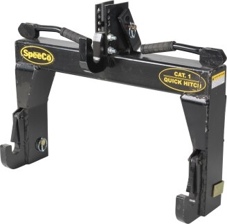

Hi, following the Harbor Freights quick hitch thread, I looked around in Princess Auto (Canadian HF) and they have this type of CAT1 3-Point Quick Hitch. It's quite more expensive than HF but seems more sturdy. Anyone tried it?

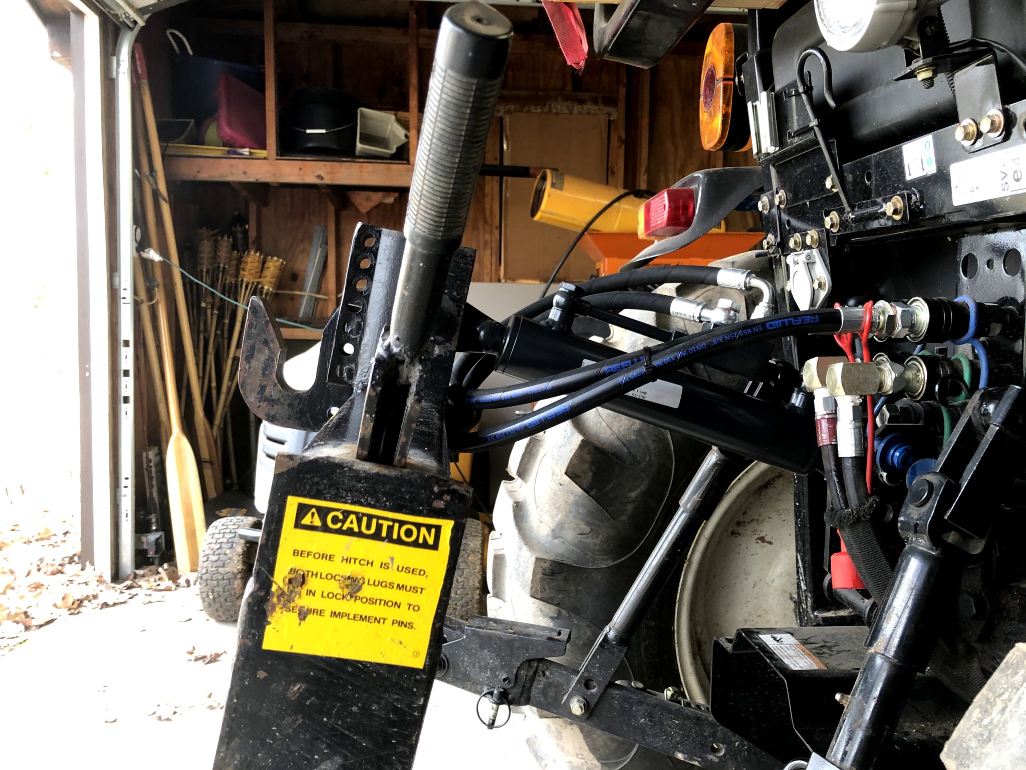

I have on old SpeeCo my Dad gave me. It works fine but, Cat 3 bushings fit nice in all 3 hooks so I put Cat 3 bushings on all my implements and everything fits nice and snug. Make sure the top hook extends far enough out so that the bolts don't hit your implement. I had to take the bolts out of mine and spot welded 2 pins in instead. Maybe the newer ones have the extended top hook?

Hmm, odd. That SpeedCo in the video doesn't require the Cat1-Cat3 bushing yet the one at Princess Auto requires them :confused:
Hitch in video is non-standard. All QH's built to the standards require bushings. It's my opinion that QH's didn't exist until tractors became large enough for cat3 3pt. Farmer's with cat2/cat1 wanted the benefits of a QH - easiest way was for manufacturers to build cut down versions and sell bushings (more revenue)

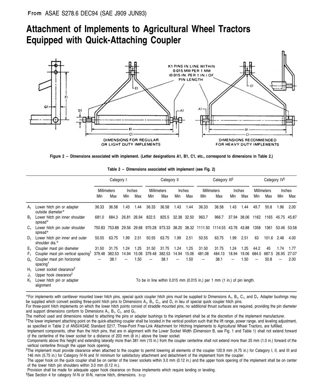

Ummm.... According to standard all lower pins are 1.43 inches minimum and 1.44 inches maximum... All upper pins are 1.24 inches minimum and 1.25 inches maximum...
Dale
Those are implement standards - not QH standards

I have one from princess auto. Got it on sale one or two years ago. No problems with it but it does need bushings unless you can put up with the slop. I changed the bolts to universal clevis pins so no tools are needed to move the top hook around.

Have used my HB QH now for two plus years without an issue. All five of my implements fit, pins as well. I did have to extend the hook however. Like someone said, most QH come from China so quality can't be much different from one to another, especially in the $100-150 price range. Land Pride may be better than most, they also cost more. Not sure if theirs in Chinese or made here. The QH is a terrific invention.

I'm convinced nearly all of the brands - HF, Princess, TSC etc that look alike are in fact all clones made to the same specs. Perhaps by several fabricators. The only difference is some need bushings while some are limited to Cat 1, due to smaller openings in the lower hooks.
It is well worthwhile to buy the 'extended' upper hook from Speeco or others. And replace the upper hook bolts with removable pins. This old post has photos describing this.
So long as the tractor isn't near the maximum hp specified then any brand of these generic Qhitches will work the same.
Deere's expensive Qhitch is the only version different from the generic clones, that I have seen.
In summary if the tractor isn't near maximum hp recommended, then just get the cheapest Qhitch then add the extended top hook and the pins to adjust the top hook height. And modify any implements that don't already have the standard dimensions described in DL Meisen's post #7, above. Some implements might be impossible to modify easily, adding washers or something, so you might not be able to use the Qhitch for everything you own.
