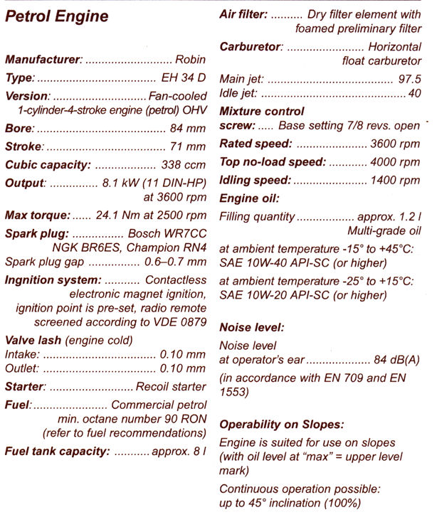

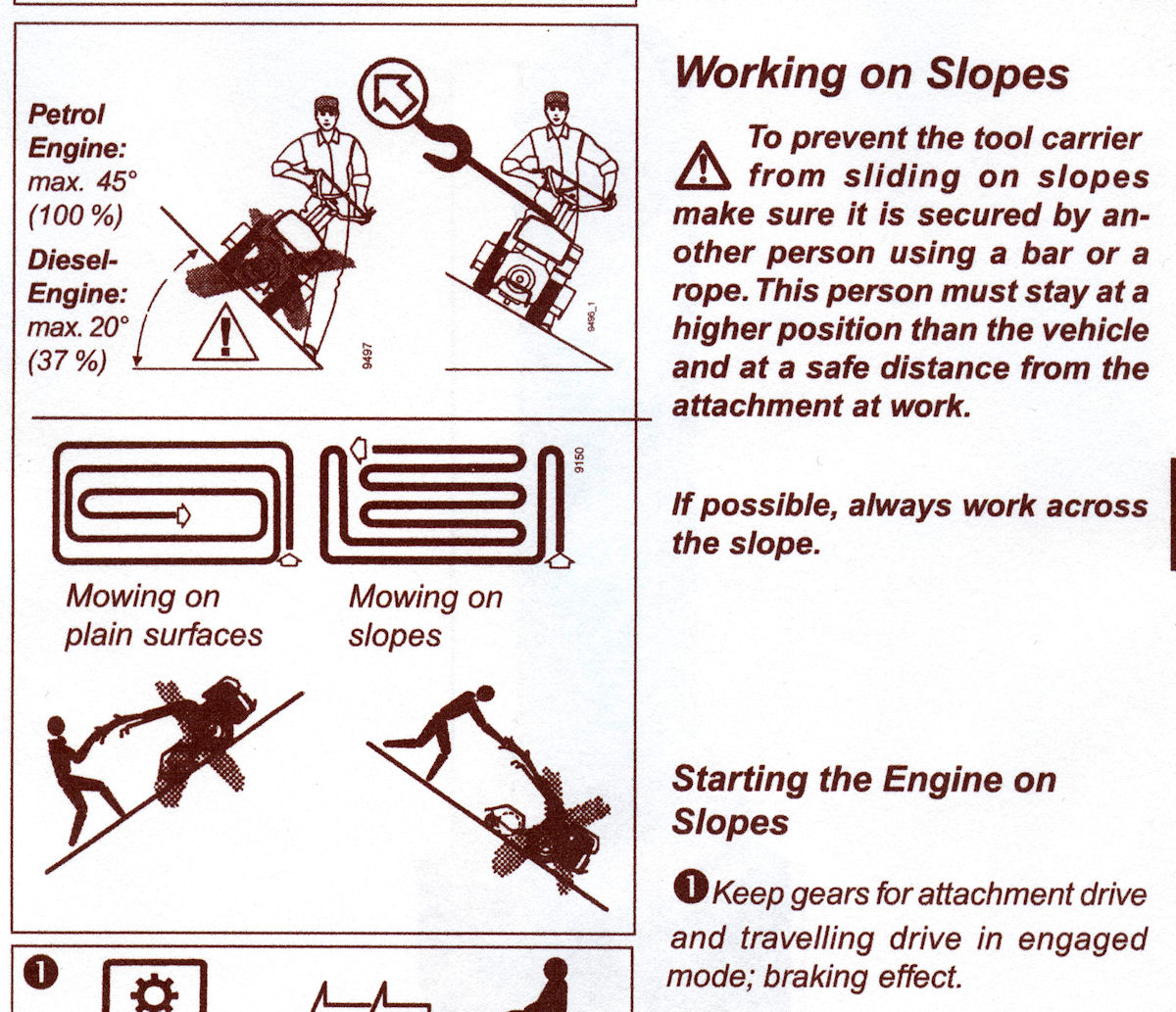

Hi! I think you need one adaptor and a new clutch for fit a new engine on your BCS. Any way also with Honda engine. AGRIA use a ROBIN EH 34D 11 hp DIN gas engine on Agria 3400. I thank Agria for the operating manual. I add picts Good Luck ! Oldmech

Thanks. They told me the clutch also fits the Honda.
