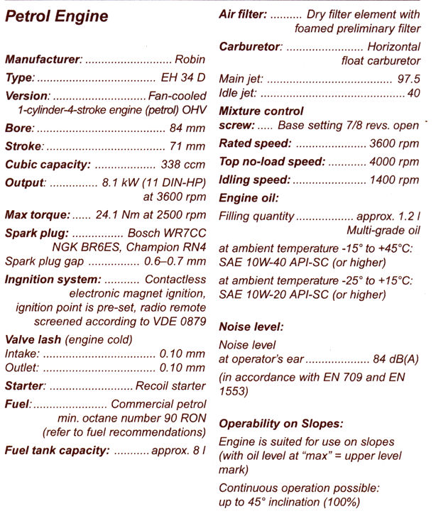

Hi! I find a special industrial engine ROBIN EH25D . This engine can run 100% duty or continue at incline 45 deg. The best I seen. Gas engine 8 hp Din This engine is on AGRIA two-wheels tractors and others industrial machinery. Good Luck ! Oldmech
Thanks, I'll start watching around for one. Any idea if mounting will be a bolt up deal, or more complicated?
