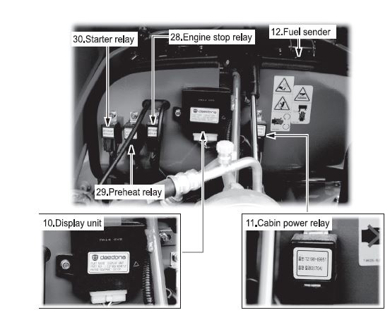

I am hoping someone can help diagnose my starting problem on my DK40. For the last year, it has been a pain to start. Basically I have to hold the gas pedal down for about 20 seconds "after" it starts, if not it will die. In other words, it will start but not keep idling. I replaced the positive battery cable (but not the negative or ground wire) 6 months ago and it seemed to help out somewhat but on very cold days I will run the battery down before I get the tractor to run or idle on its own without stepping on the gas pedal. Could it still be a battery cable problem. On some occasions, it will click but not turn over unless I move the key the stop and start several times. Has anyone experienced a similar problem with their DK40? I bought it in 2012. I currently have about 225 hrs. Thanks, Boomer

First is the way it is supposed to work:
Turn key to on and glow plugs will automatically come on for about 20 seconds & the glow plug indicator light in dash will be on.
Once indicator light goes off, crank engine to start then release key to run and glow plug light will come back on for another 20 seconds (approximately) to add post heat to cylinders to help fuel atomizing.
Your problem sounds like voltage problem either through battery connections or key switch or possibly both.
Battery ground is often overlooked and has been reported here more frequently than positive cable. While battery cables are off, have the battery load tested just to make sure it is not weak battery. Clean all cable and post terminals and follow the ground cable to where it fastens to the frame. Take the bolt out and sand frame paint to bare metal, reinstall cable and repaint it.
If still having problems the switch would be next to check or replace. Key switch on these, especially older models, have high failure rate too. many have had luck cleaning the switch, others simply replaced it. I have read on TBN that Kioti has a new part number change on the switch.
If the intermittent cranking problem gets resolved but still have to keep extra throttle added to warm up then check the glow plug function. May have bad relay or weak glow plugs.

Come to think of it, there is a "post heat" to the glow plugs also. Even though the glow plug light goes out and you engage the starter and the engine starts. the glow plugs stay on for about 15 more seconds to keep the combustion chamber warm until normal combustion continues to heat it up. I had forgotten that.

DK55 was having the same starting problems. I was also having problems with the stop engine solenoid not working. In the process of trying to fix the engine stopping problem, before paying $100 for a new solenoid, I replaced the safety start relay, it's a common 5-pin relay available at any auto parts store for less than $15.
The new relay fixed the starting problem which I think must have been a lack of power to the glow plugs. (It didn't fix the stop engine solenoid problem. :()
Good luck
I should add that the glow plug, dash light was doing just what it was supposed to do, so there was no indication that the non-working glow plugs were the problem.

On my Dk35se the glow plugs do not come on if the block sensor is above 86 degrees F. Min never smokes on startup, and starts every time with just a bump of the key. Easiest starting tractor I have ever owned, and it is number 5.

I looked at service manuals for DK50, DK45s, and DK50SE, which are have similar glow plug controls and should be like your machine. All say the glow light should come on with coolant temp below 60 C, which is 122 F. Sounds like you have a glow control problem. In all cases, the glow plugs should get power with the switch in the glow position (light or no light) if the relay is OK, which is probably the only reason it started at all. Maybe you just have a bad light? Measure the actual voltage at the glow plugs with the switch in glow and immediately after start. The glow control circuit only has three parts (temp sensor, preheat controller, and relay) so it's easy to test and diagnose. It sounds like you have already thrown a lot of expensive parts/work at this problem. Check out the glow power before more parts swapping.

My glow plugs quit working once years ago, the glow plug timer box (Controlled) whet bad. (Light would come on but no power to the glow plugs)

Good point. The light and the glow plugs are controlled by different circuits inside the box. That's the reason to measure the actual voltage at the plugs vs trusting the light.

Then I think you need to check (as in test, not just replace) the glow controller and associated coolant temp sensor. If the plugs glow (as you say) with the switch in the glow position, then the glow relay is OK. I assume ambient temp is below 122F when you don't get a glow light, so that indicates a problem. The glow controller should continue to power the glow plugs for several seconds after you start the engine; maybe this isn't happening.

The "post glow" is about 15 seconds after the start. You can see it with your dashboard digital voltmeter. The voltage pops up a couple of tenths of a volt when the post glow cycle stops. I highly recommend installing a dashboard digital voltmeter. I sure like mine.
