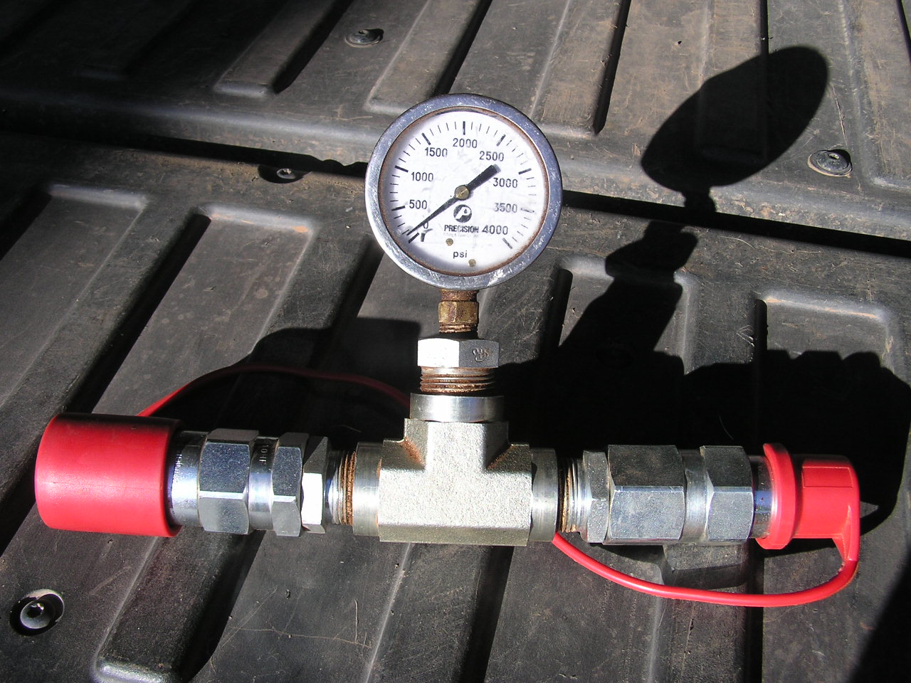

A pressure gauge on a QD would be very useful for this problem.
Mine is on a Tee, so that I can check deadheaded or inline.

A pressure gauge on a QD would be very useful for this problem. Mine is on a Tee, so that I can check deadheaded or inline. <imgsrc="http://www.tractorbynet.com/forums/attachment.php?attachmentid=453224"/>
Yes a gauge would be helpful. I have unhooked the hoses and pumped fluid into a bucket. There is good pressurized flow on one side of the valve and decent volume but no pressure on the other side until the detent is reached then there is no flow at all. I am going to pull the seat today and see if there is anything obviously amiss with the valve or linkage.
