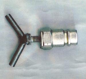

Try to build something like these

I have always used 75 psi/°F change in pressure in a closed hydraulic system. If my rule of thumb is correct, the pressure changes can be pretty significant.
