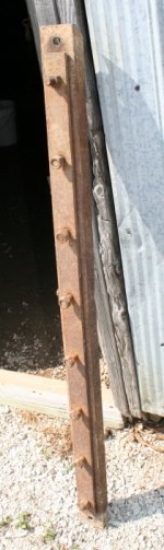

   / problems stretching fence #27
Here is a photo of my fence stretcher for anyone interested. We find these at farm auctions on a regular basis around here for between $5 - $20. They are a bit of a pain with all the bolts.
   / problems stretching fence #28
I built something like that using 2X4, three 3/8 inch bolts with wingnuts and two pieces of chain. Worked great!
   / problems stretching fence #29
Instead of 2 pieces of angle iron, I used 2 2x4s with bolts through them about every 6 inches. Tighten like crazy. I put angle iron at the back so the chain would pull evenly and not break the 2x4s. Tight like guitar strings.
This is all you need. The knots in the wire make an impression in the wood which keeps the wires from slipping. The only thing I do different is drill a hole in either end of the 2x4's to run my chain through.;)
