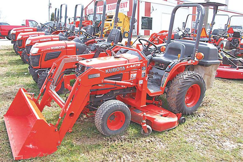

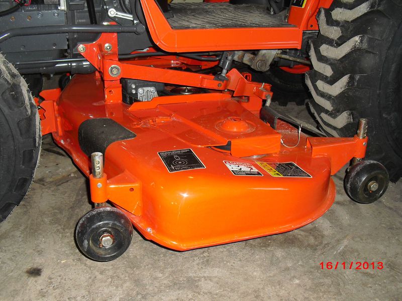

Hi,
I have a neighbor that has a BX, and I have a B2710HST that uses a RCK60-27B, (which is the exact same deck as the RCK60-29B deck that the O.P. referenced, with the exception of the mounting hardware that it hangs from, as the RCK60-29B is for a B2910HST tractor) and the 27B/29B decks are very different from the BX decks. While the decks used on the BX series hang fully suspended from contact with the ground, the RCK60-29B , (when lowered in the cutting position) maintains full contact with the ground while it is actually, "towed" by the tractor. I'll try to attach a pic of the RCK60-29B mounted to a B2910HST to give a better idea of what I'm talking about.
along with a pic of the other type,
which shows that the B2620 has a lot more in common with the BX series than the B series.
Hope this helps .
