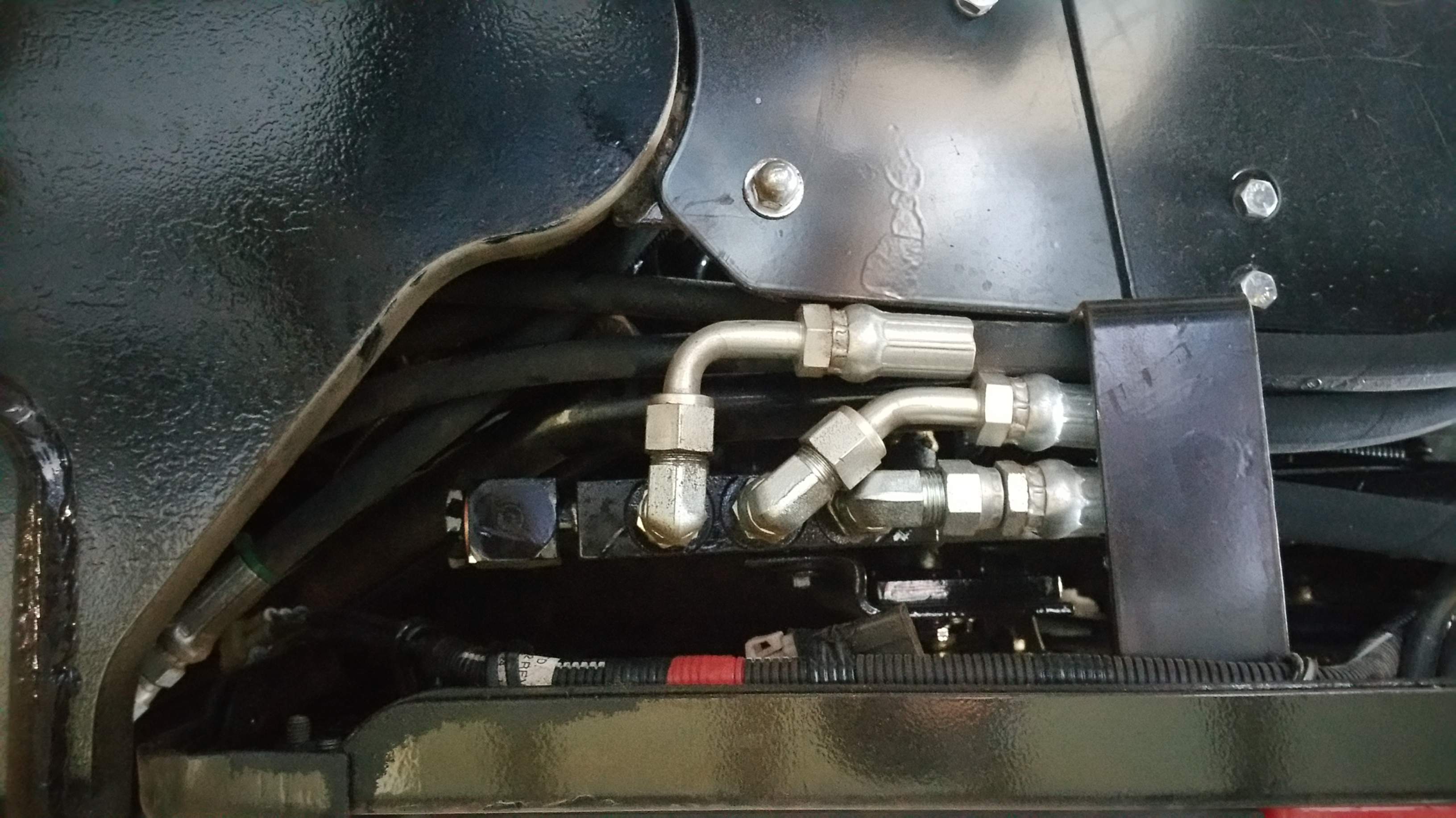

Hello Everyone,
this thread developed in the buying forums, but since then it has morphed into more of an owning/operating issue. I am moving my posts and updates to this section and will provide updates on this thread from now on. Below is a brief synopsis of what I have been dealing with for the past two months with my new 4035. Please understand that I love the tractor. It really is an amazing machine. That feeling is somewhat overshadowed by the CONSTANT hydraulic leak that I am dealing with. The tractor has been to the dealer four times for the same issue. During one of the visits/repairs the dealer tweaked the cruise control (causing it to no longer work properly). The mechanic does not know how to fix the leak or the cruise control. Out of the two months that I have owned the tractor, it has been out of service for about 75% of the time (leaking so bad it can't be used, waiting for the dealer to pick it up, at the dealer for repairs, or waiting for it to be brought back and dropped off). The tractor currently has 33 hours.....

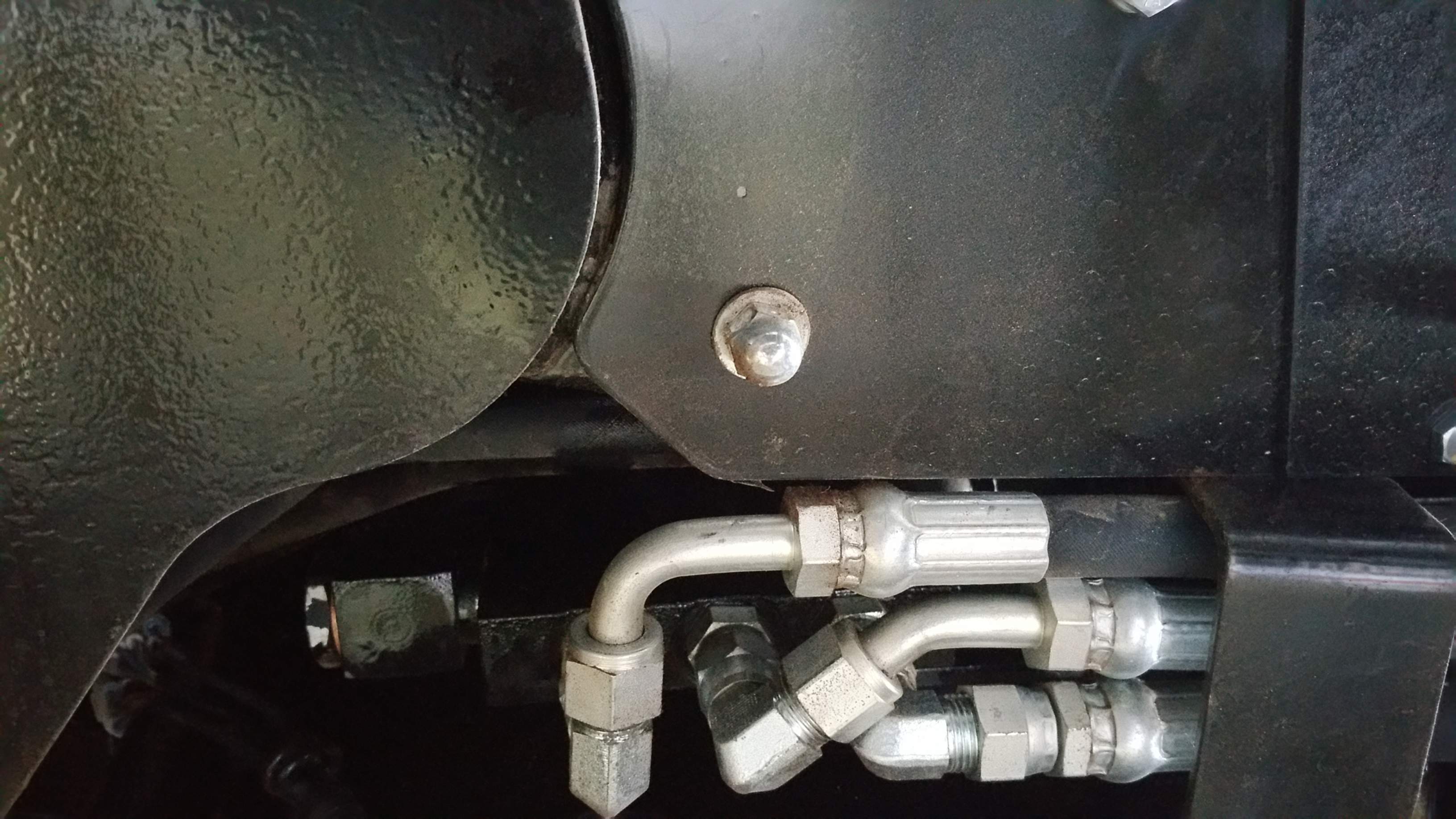

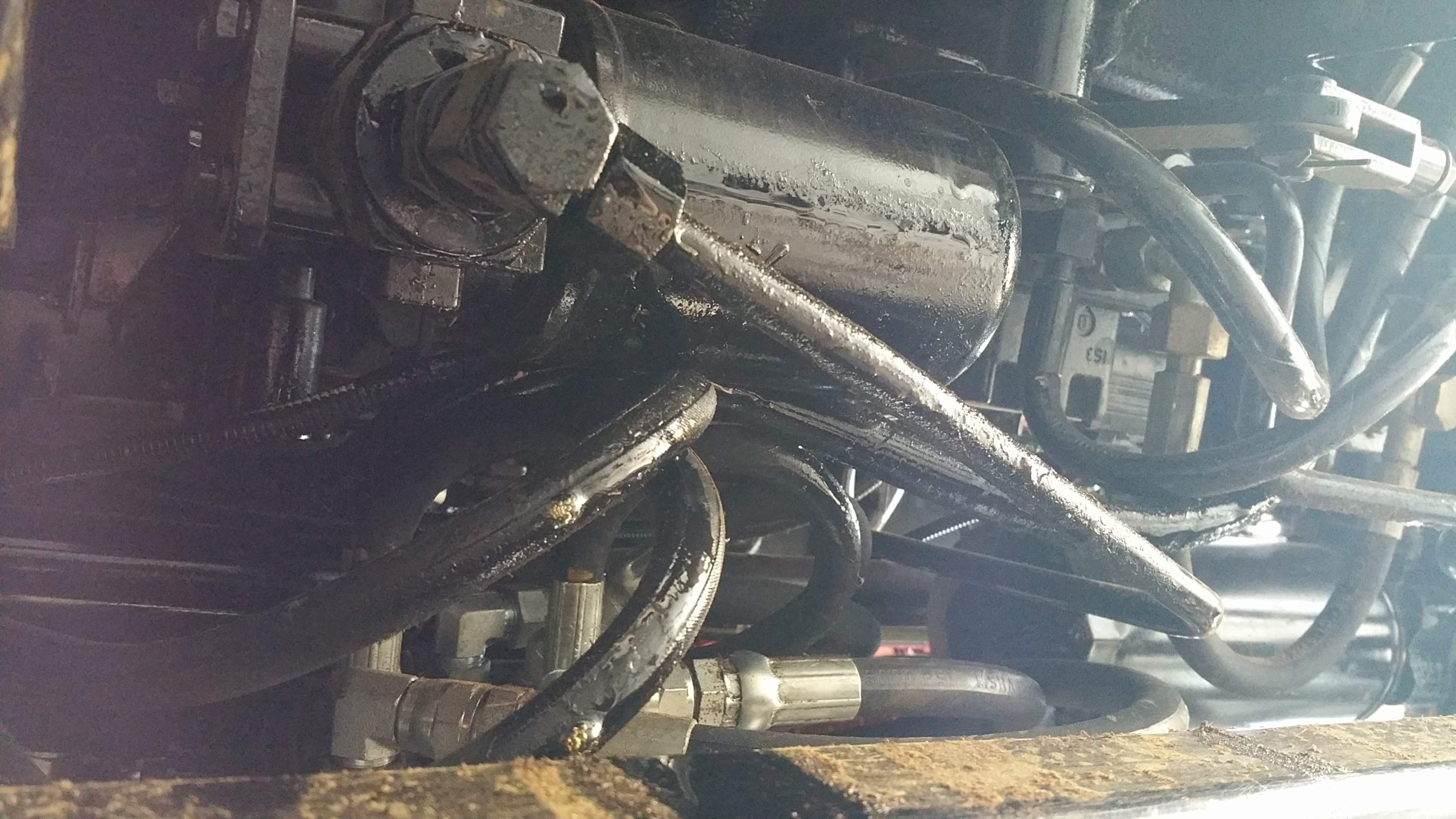

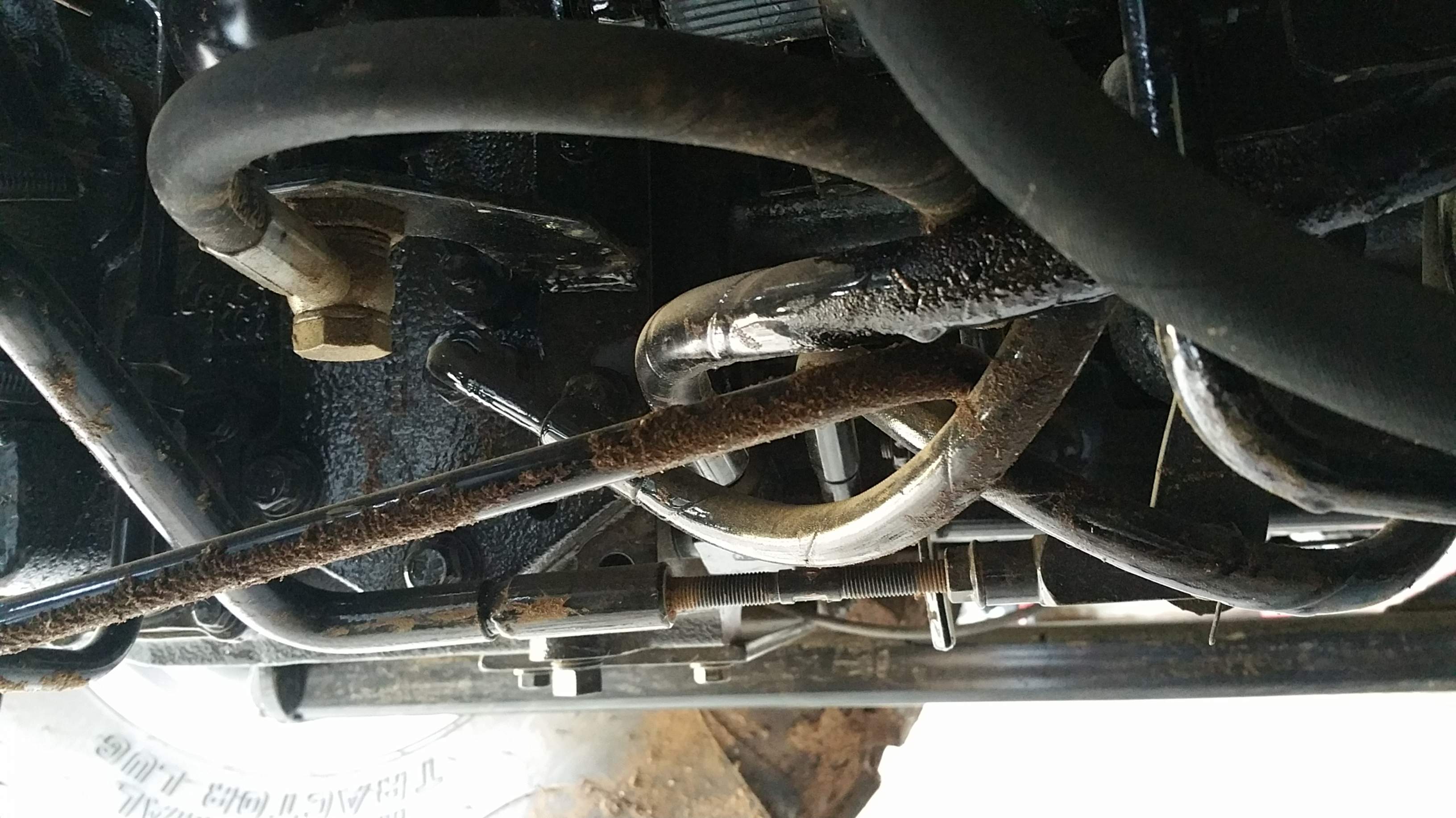

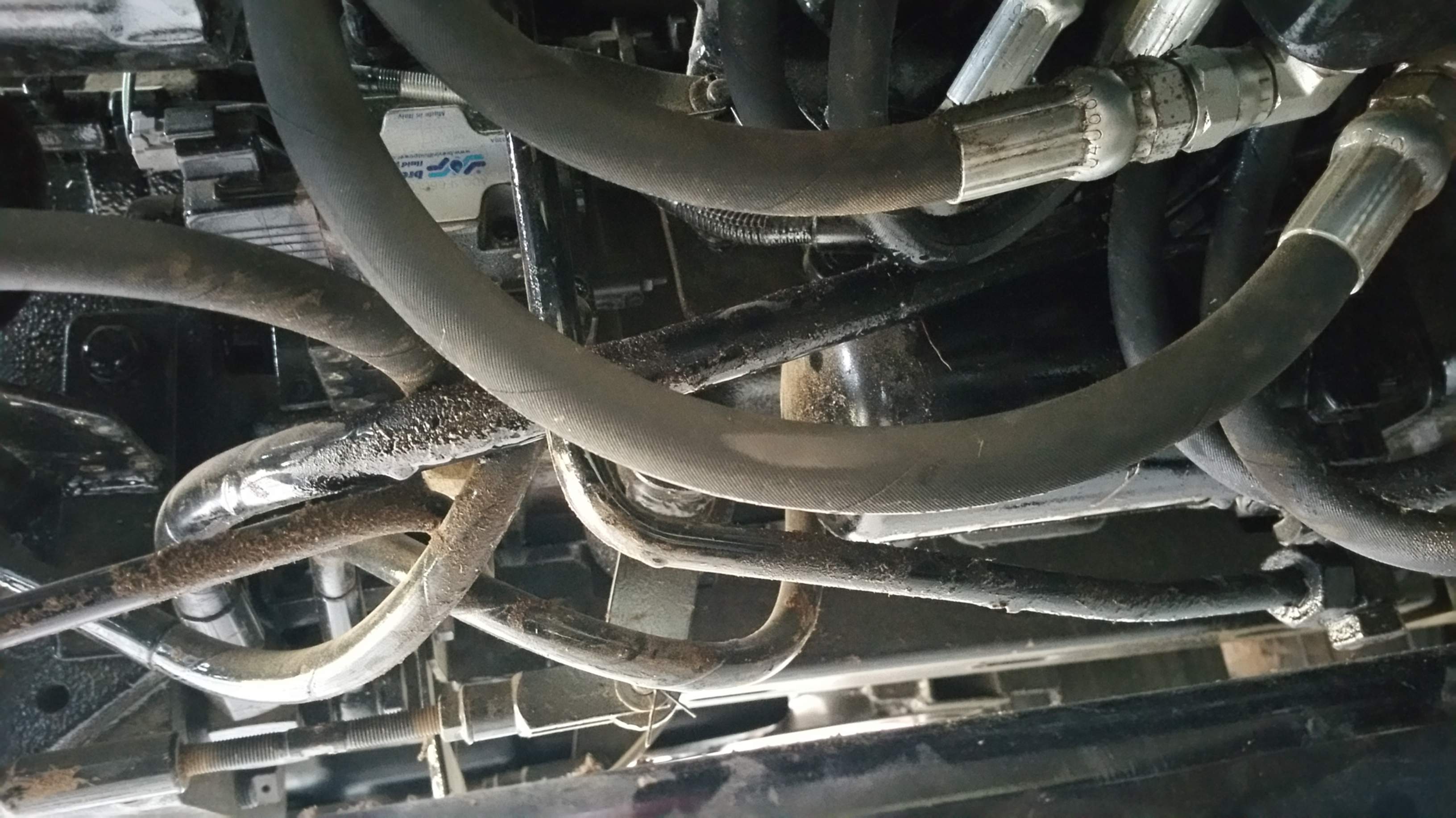

Here are some photos of the trouble area:

As for the hyd leak. If you look at the first picture - on the left side of the picture there is a nut with a copper washer. The leak now seems to be coming from around that copper washer. The mechanic called is a crush washer. I don't remember seeing a copper washer there when the tractor came from the factory. Maybe it was an attempt at a fix by the dealer?

Pic 1 .....That fitting was desighned? to be screwed in until u reached the nothreaded part (where te steelwasher is) and on the inside must be a 0-ring.....then that loose nut must be locked onto the casing ......sqweezing te o-ring !
Remember .......always look for the leak at its highest point !
Pic 3.......can do with sum dowtywashers ......get the right size !
Pic 4 and 5 ......follow that pipe to its highest point !
