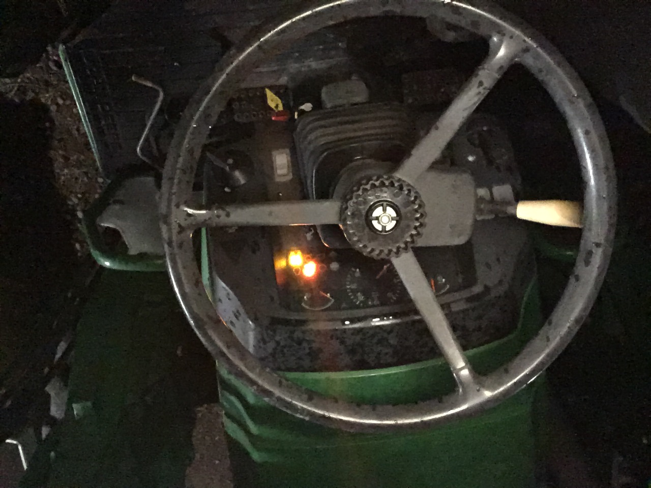

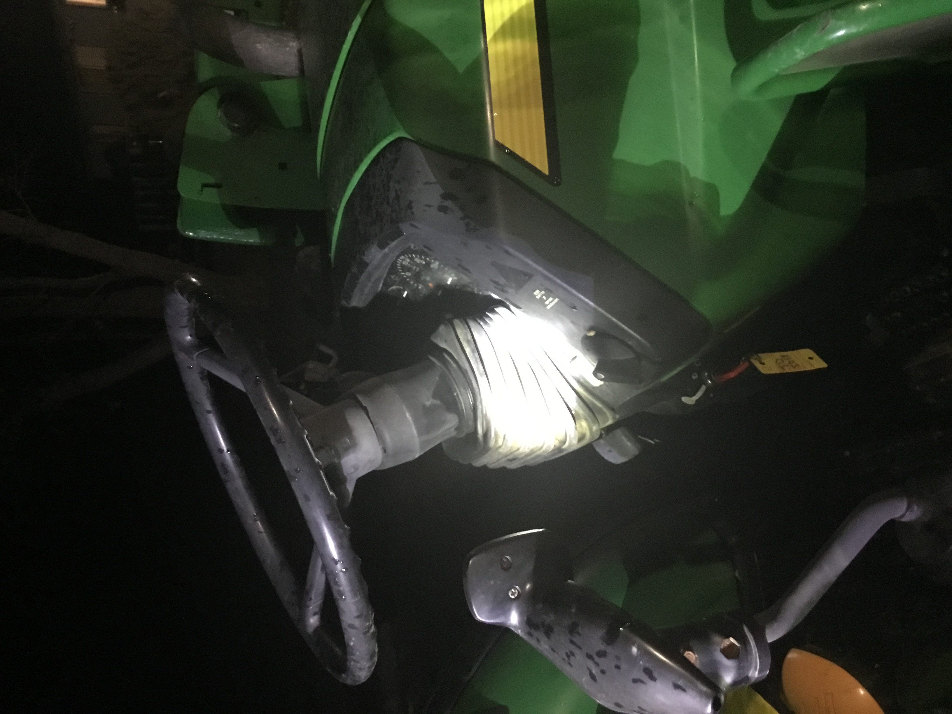

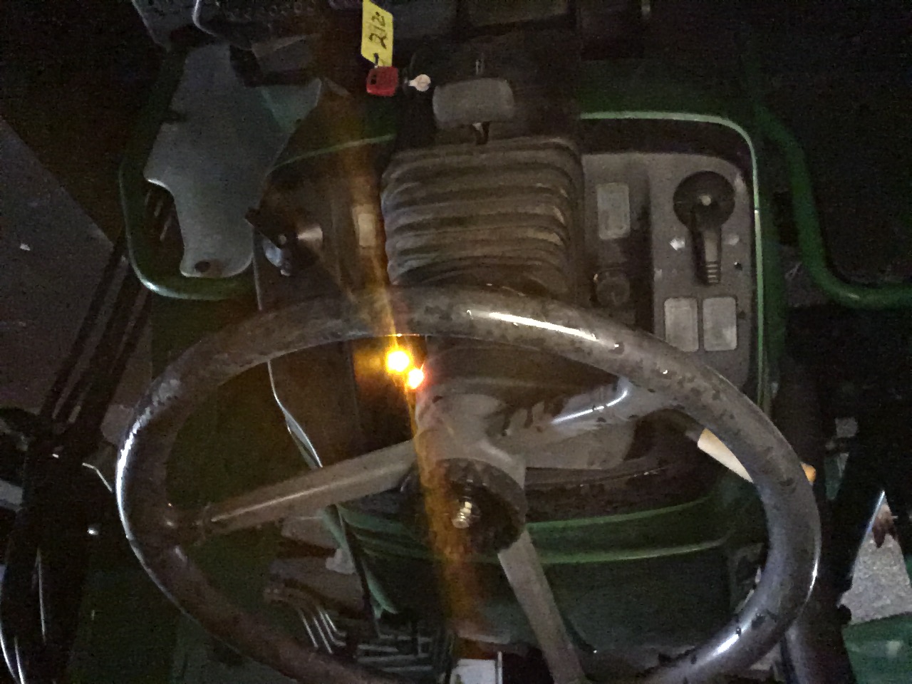

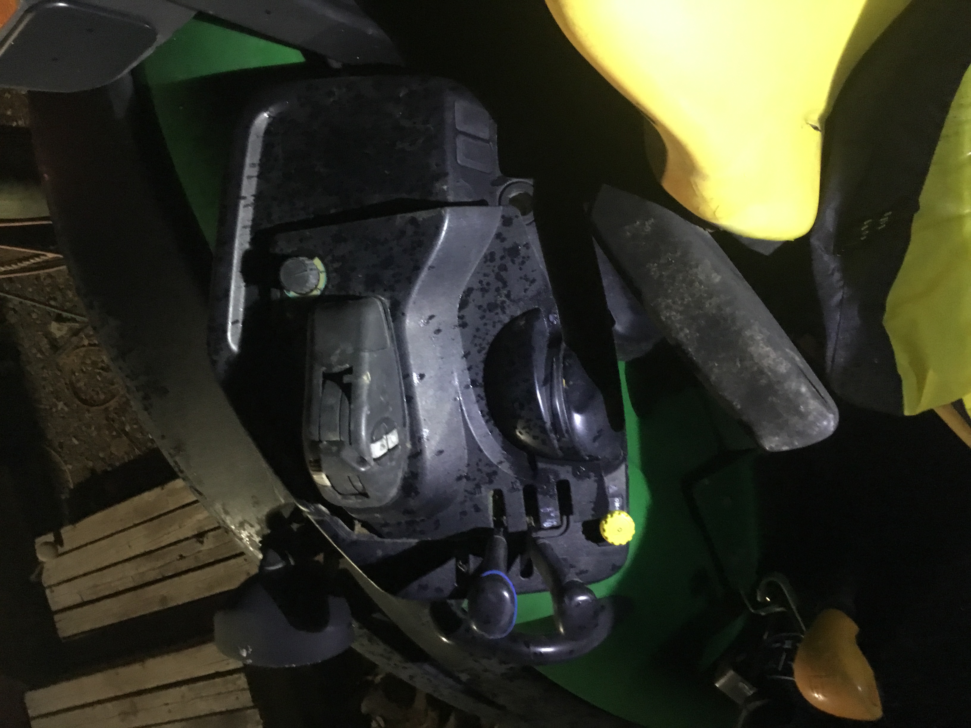

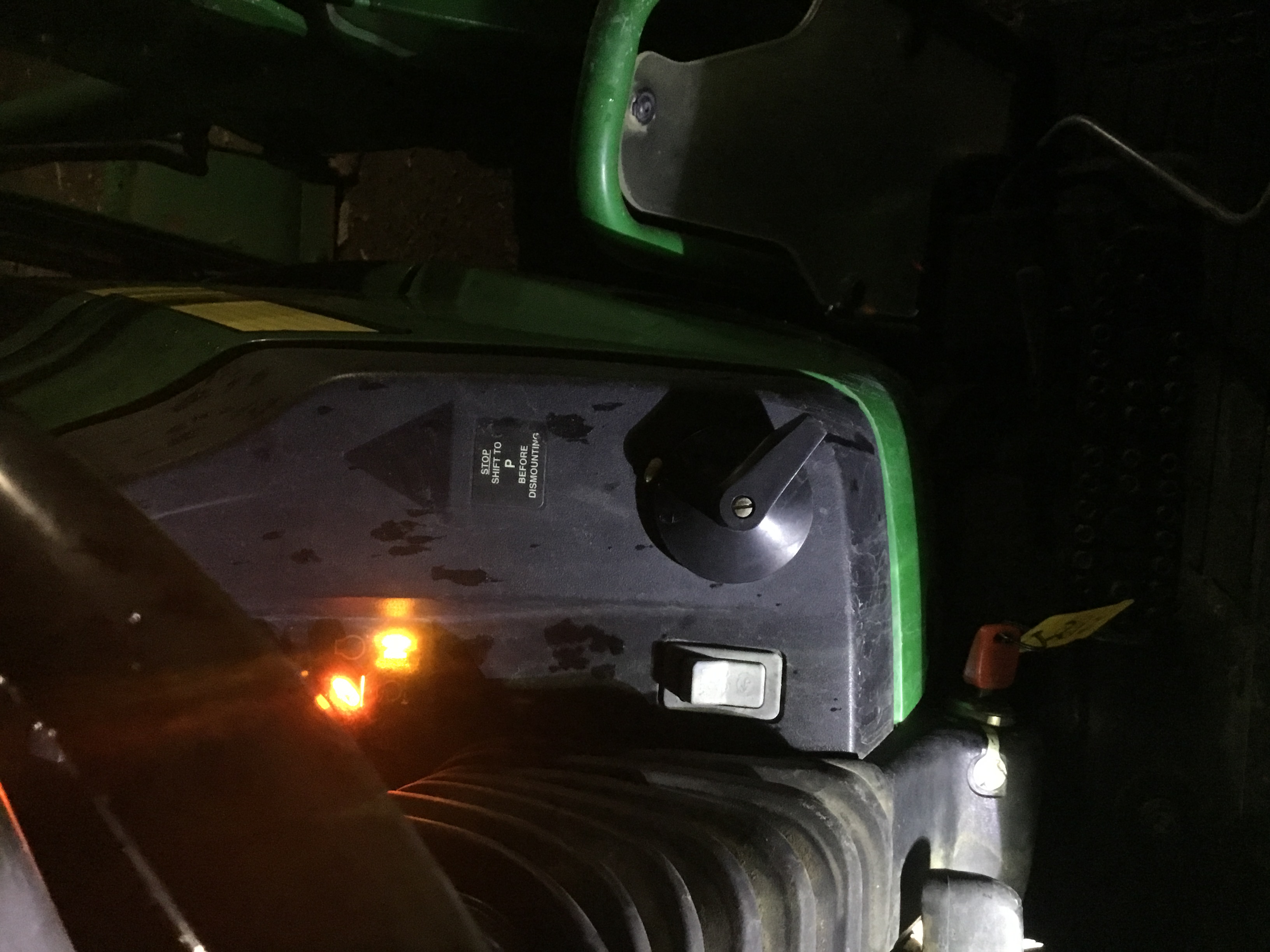

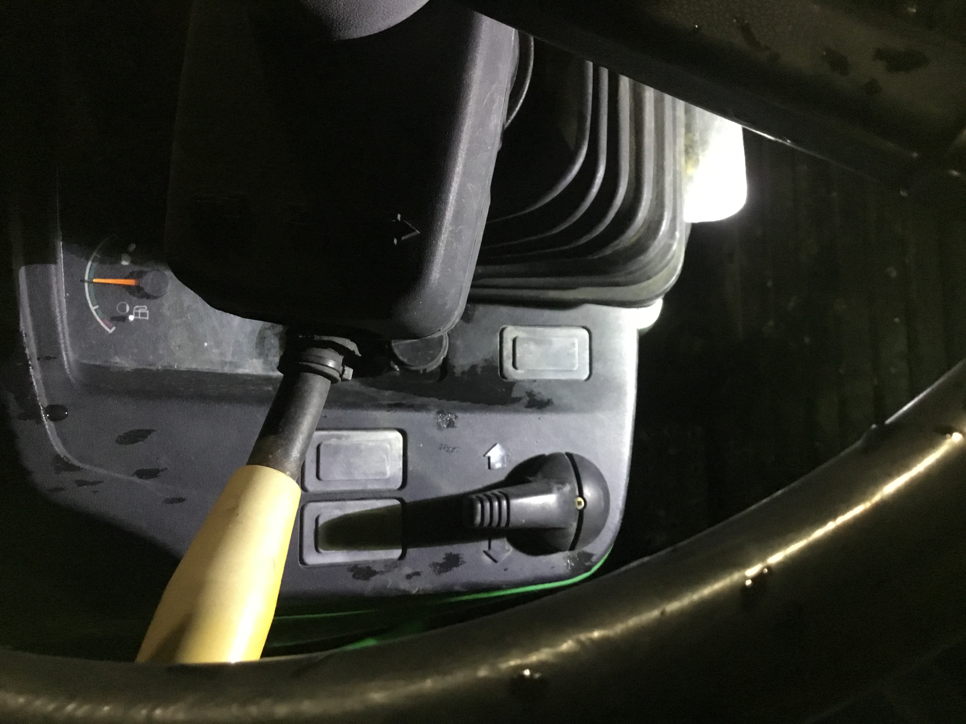

What switches do you have? (There may be a substitute.) Is there a lever behind the throttle?
A photo of your console may help.
   / Problems with new, used 5085m #12
Do you have an ARC? What switch is on top of that?

Sorry, ARC?
   / Problems with new, used 5085m #15
ARC = Arm Rest Control. AKA, Joy stick.
   / Problems with new, used 5085m #16
Unfortunately it looks like you have no way of reading codes on your tractor without dealer computer. I believe that was not available for your model until a later year model. THe Service Advisor connection on your tractor is behind the seat. There should be a panel behind the seat held down with 2 thumbscrews. Remove that panel and on left side under cover is a large round black connector. That is where you plug in to do diagnostics. There is a performance monitor that can be bought to plug in to do diagnostics and calibrate hitch. Monitor and wiring harness to plug into diagnostic plug runs near $2000.00. If you have diagnostic manual, it will tell you how to use monitor to diagnose.
