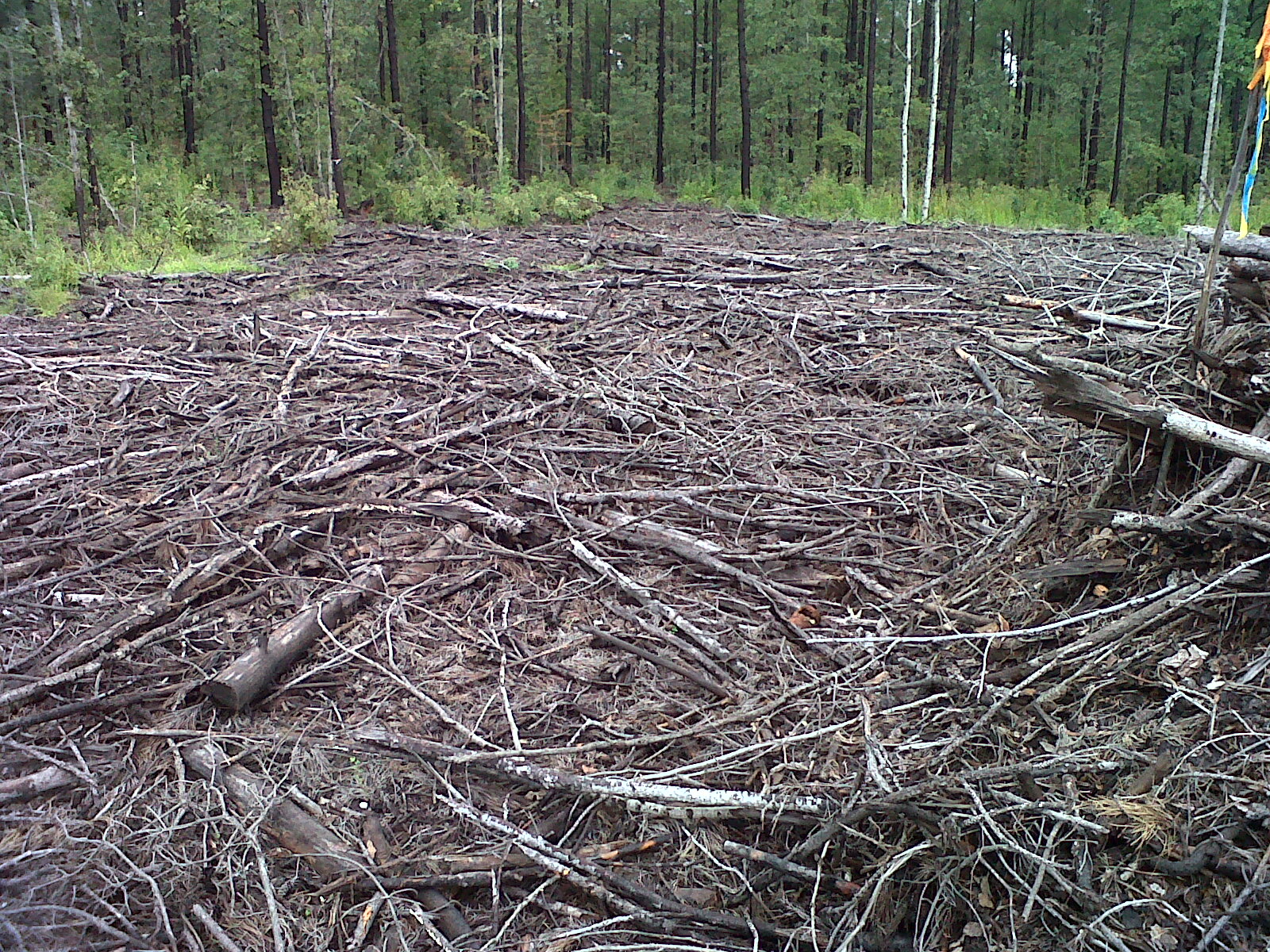

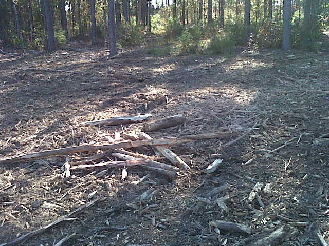

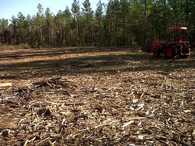

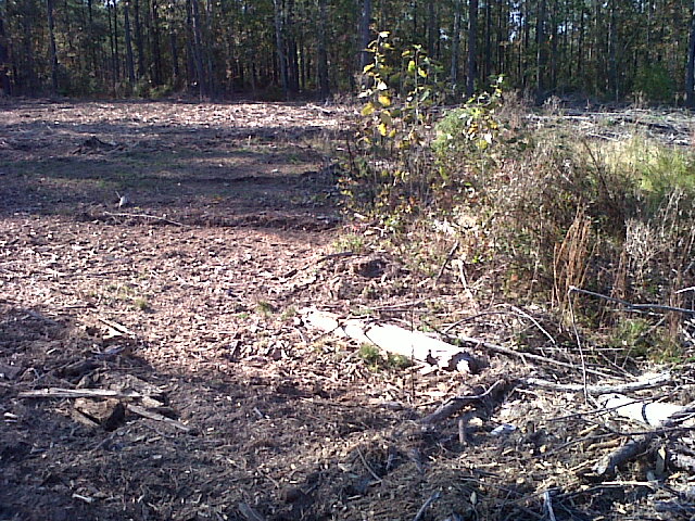

Should I just disc the mulch in or rake it up?
How thick is the mulch?
Mine ranges from the first pic to the others in size...
Be well,
David

Mine is a combo between picture 2 and 3. I know i'll have to get the bigger pieces up.
I switch between the rachet rake on the bucket, and my root grapple.
The burnable sized stuff I grapple to the burn pile, the littel stuff I spread around and shove to the edges outside the fence line (inside the tree line).
David
