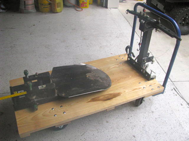

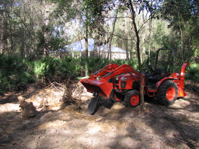

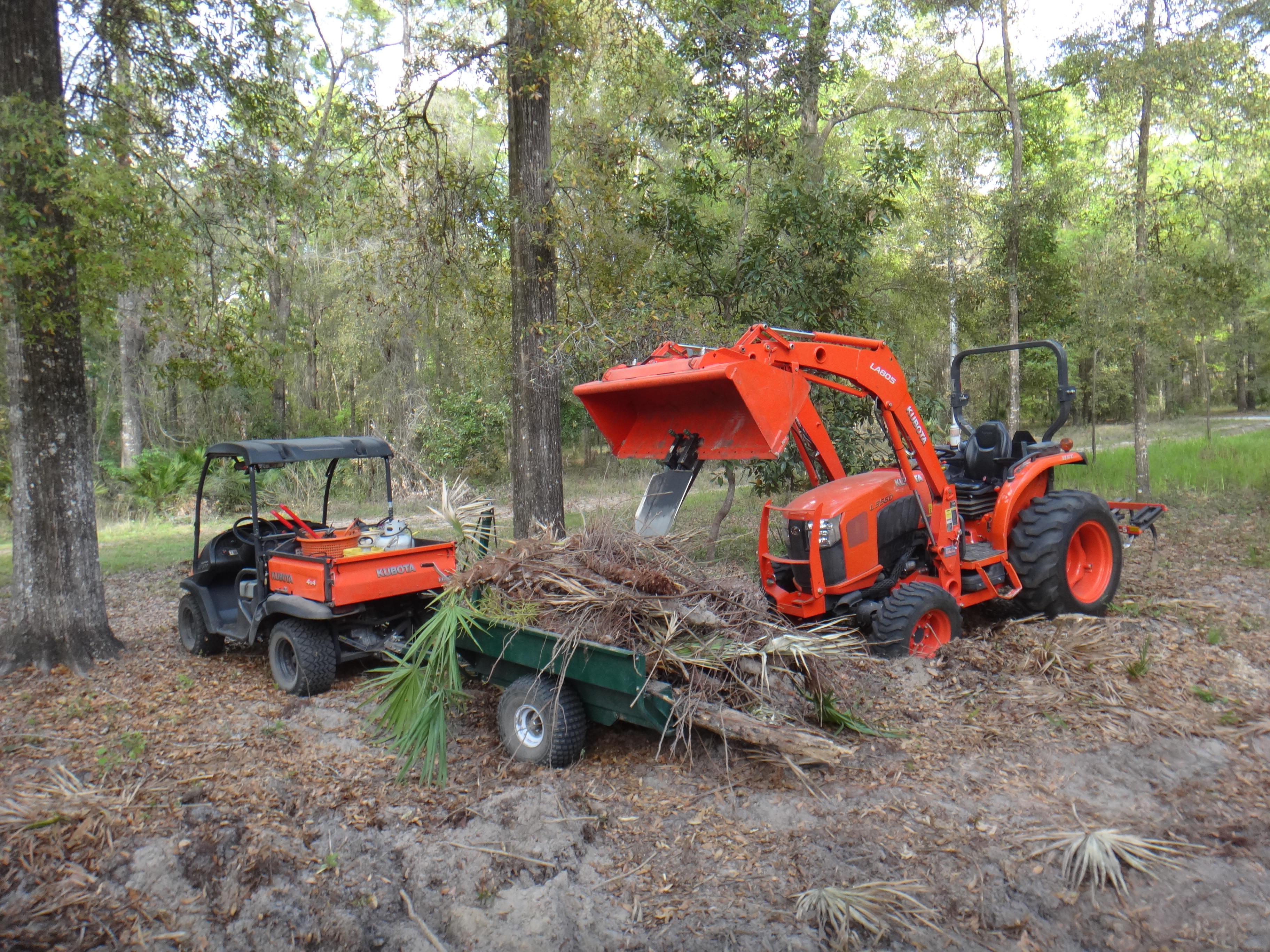

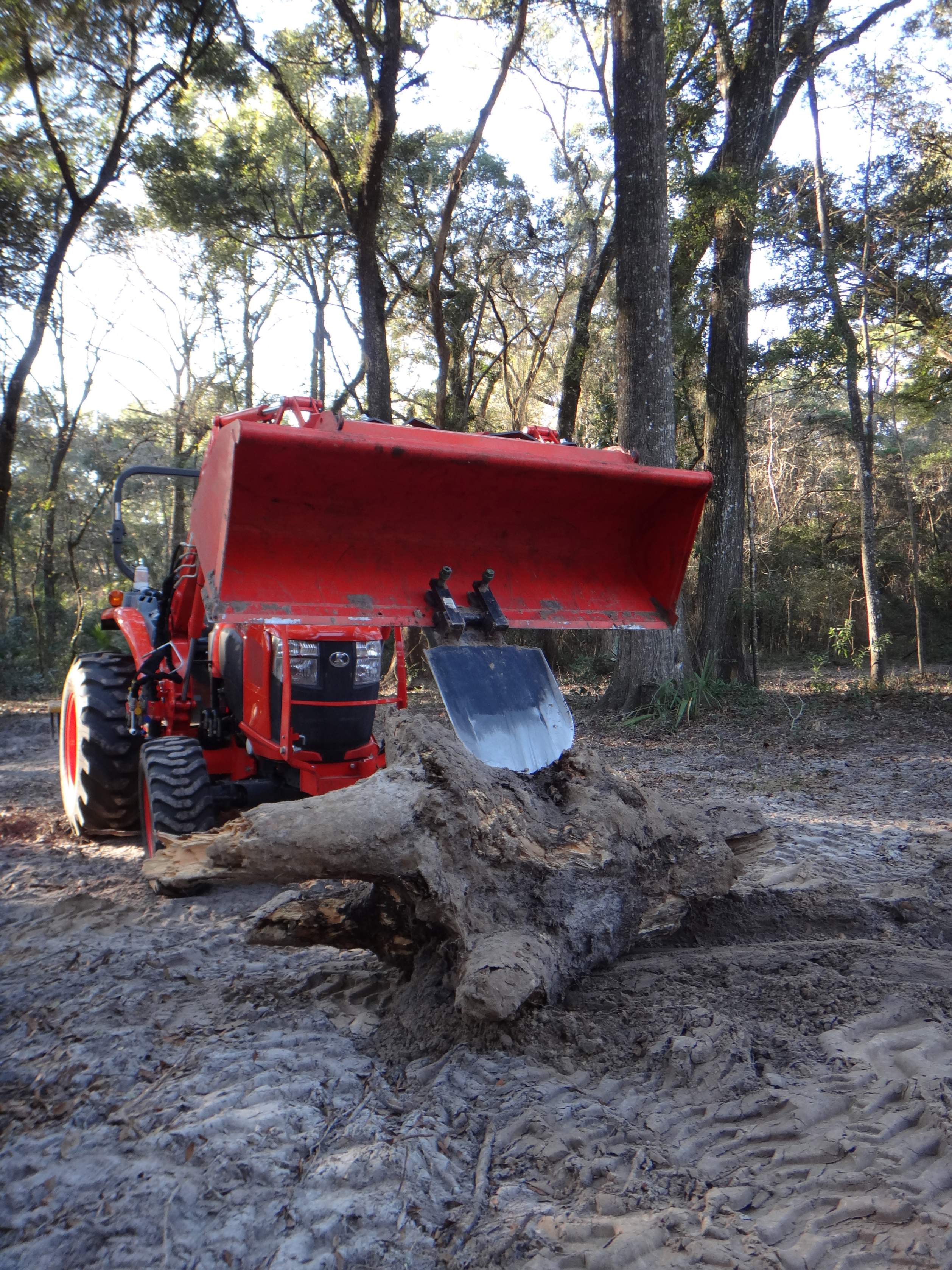

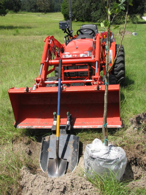

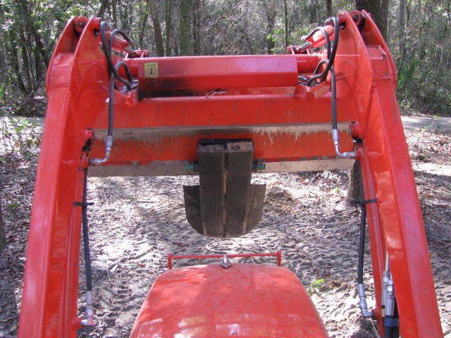

For digging multiple holes for trees, I originally looked at the backhoe attachment, but the numbers $$ just didn't work for me.
If you purchase a tractor with a bare tractor weight of 3,800 pounds or more, then option in a Front End Loader, A $450 clamp on bucket spade is all you need for tree planting.
VENDER: Tractor and Skidsteer bucket spade shovel

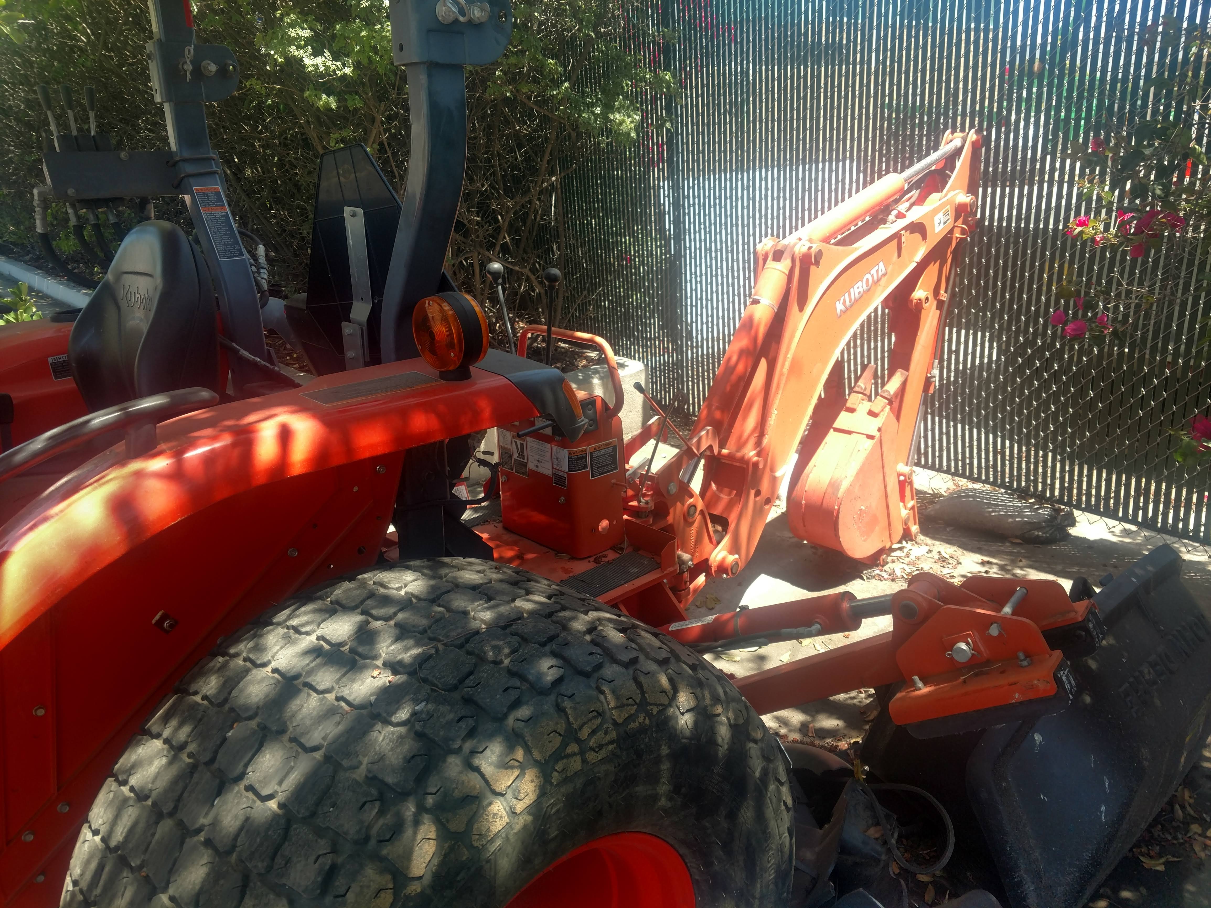

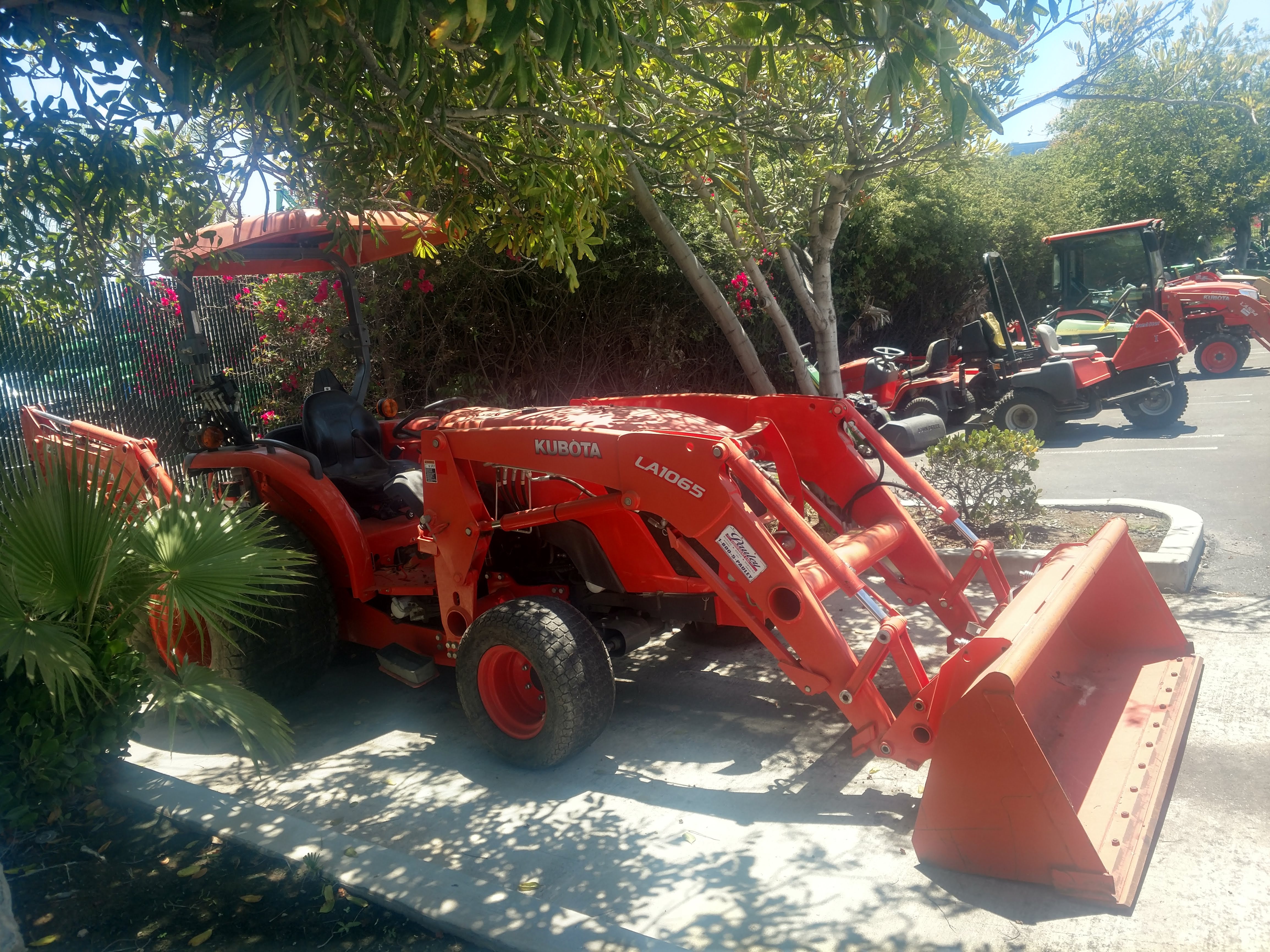

Funny you should mention. If I can attach the picture of an MX5200, 250hrs, with backhoe $29k. It has 3 aux hydraulics. I just have to get the dealer to swap our those turf tires.....
I also just noticed in the part number it is a MX5200-DW, which I think is manual transmission, not HST. Clutching then, I guess. Any advantage to this version? I was inclined to the the HST. The Serial is 54308 and engine serial 7EY3422, which I get is 03 series engine, year= 2014, in Dec 3422 off the line.
It was a trade in, I may be demo'ing it at our place, but I would appreciate comments.
   / Process in buying your first tractor #18
Funny you should mention. If I can attach the picture of an MX5200, 250hrs, with backhoe $29k. It has 3 aux hydraulics. I just have to get the dealer to swap our those ag tires.....
View attachment 616632View attachment 616633
That's not only got a disadvantageous transmission, but it's been sabotaged with turf tires! Stay away!
Unless that's what you want.
