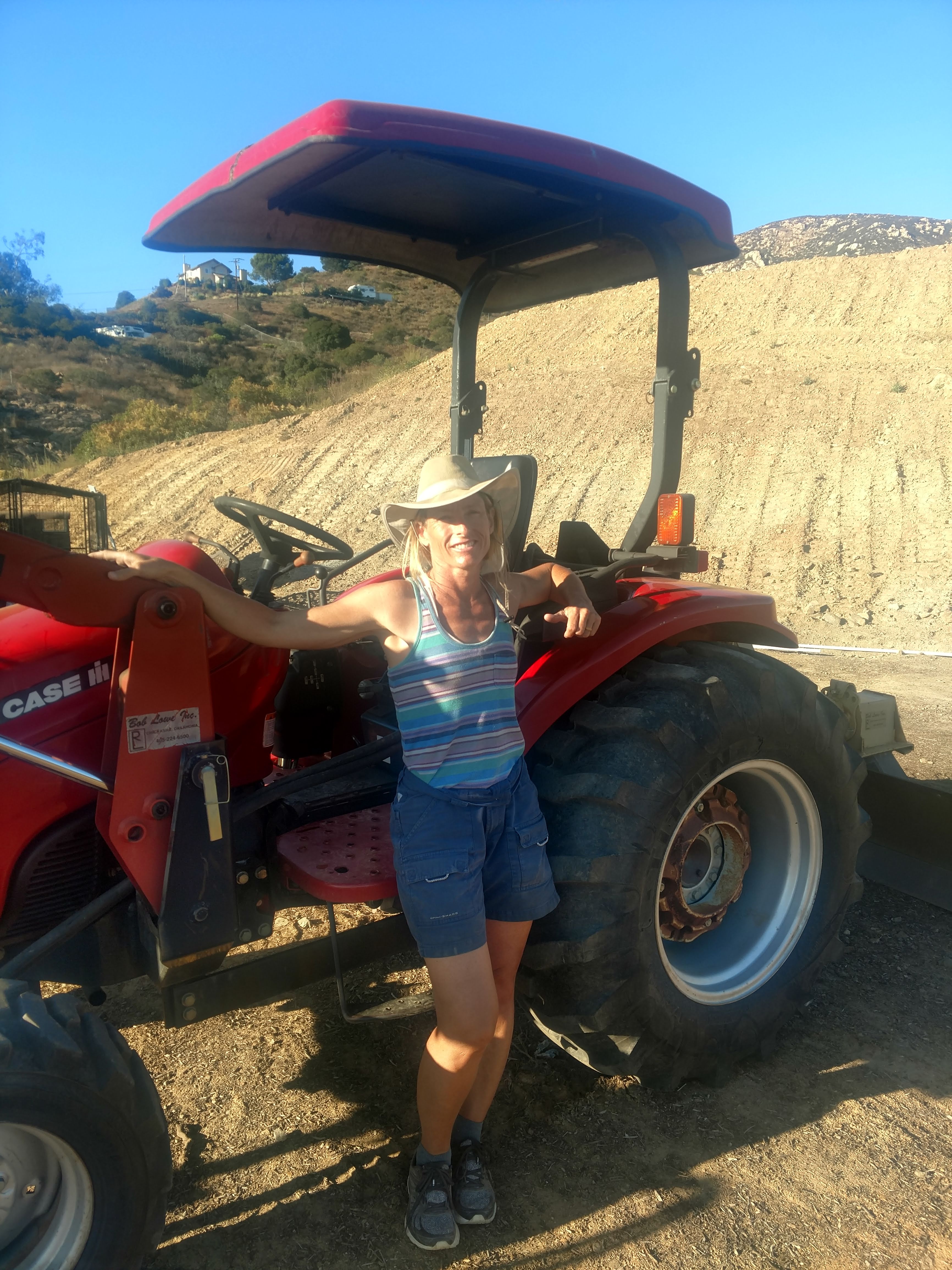

Sorry for the hiatus, but I chose to get the Case D45. Super nice guy selling the tractor. The ad on Craigslist had expired, and he said he held off relisting until we came and saw it. So far so good! We just got a Versatube shelter for it ordered, the sun out here can be merciless. I now have to learn how to use the rhino auger. I have been playing with it. Youtube here I come.
Thank you to all of you that weighed in(that was for you Jeff) on my selection.
   / Process in buying your first tractor #30
Well done, SDAnnette. :thumbsup: Good luck with your new toy... er, tool.
