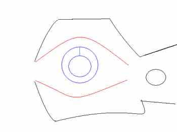

Someone mentioned getting the connector in the right direction - this is critical, and very often overlooked.
If you look into the end of a crimp fitting, you'll see that it is a rolled tube. There is a seam running the length of it. You want that seam at 12 or 6 o'clock with respect to the crimpers. That is, you want the crimpers jaw to come down directly on the seam. Otherwise, the seam is likely to split open, and you'll have a MUCH weaker crimp. You DON'T want the seam pointing to the jaw opening, or back at the crimper's joint.
Attached is a pathetic attempt to illustrate this. The blue is the connector, seen from the end (and without insulation). The red are the crimper's working surfaces. It's a lousy drawing, but perhaps it's enough to show what I'm talking about.

Oh bother - the file didn't attach. It was too big. This is great forum (because of the people), but this is sure lousy forum software!
