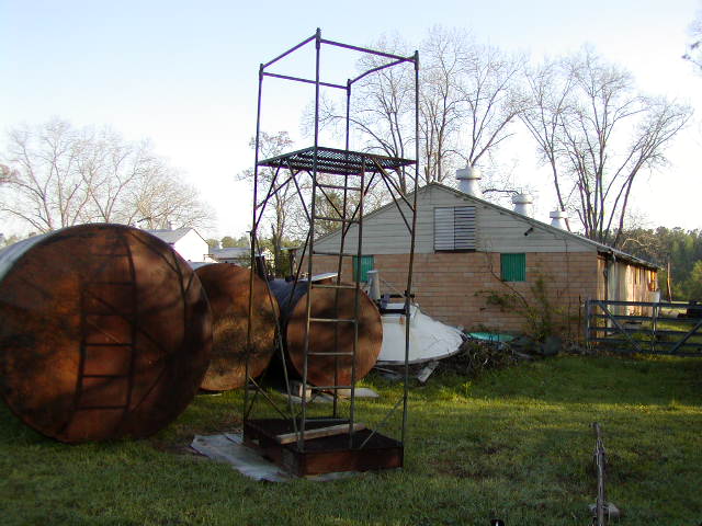

If you are going to build one, I will try to throw more ideas your way. Mine is multi-level, for when the fel won't reach high enough. Removeable banister rail around top, Can open up any one side, or remove the complete banister if necessary. Has ladder built on side, for one man operation. Just throw a short ladder on the lower platform to transport to work area. Set ladder off, raise platform to work area, lean ladder up to bottom of platform ladder & up you go.
I think I have about 9' between platforms.
Will attach an image if can find it.

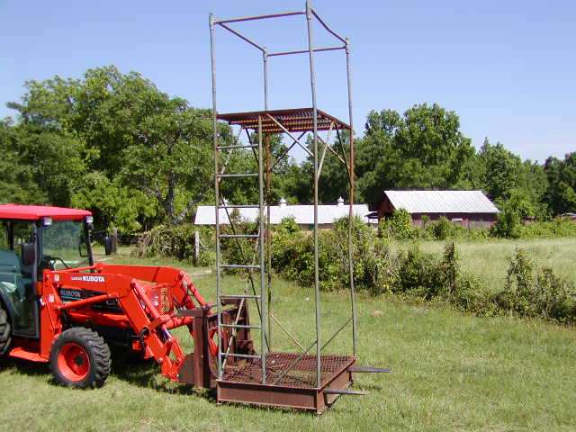

OK, PJ
I took more pictures today of my work platform.

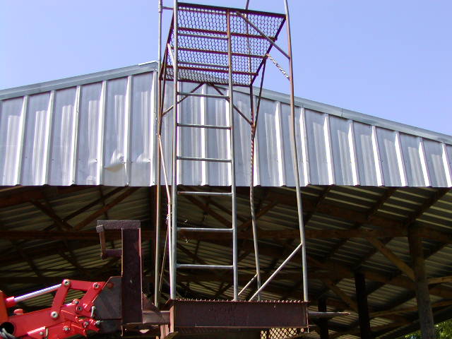

Platform in the air. I think this hay shed is approx 21' to top

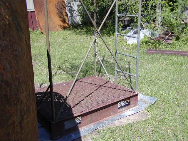

Bottom frame is out of 6 & 8" Jr I beam. Corner uprights are 1" galv pipe.

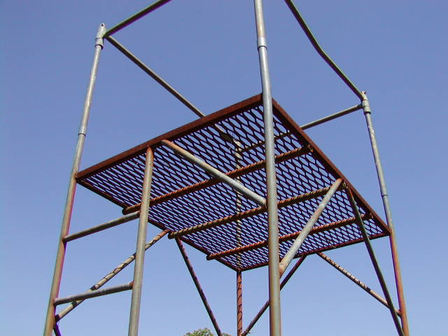

Upper view
