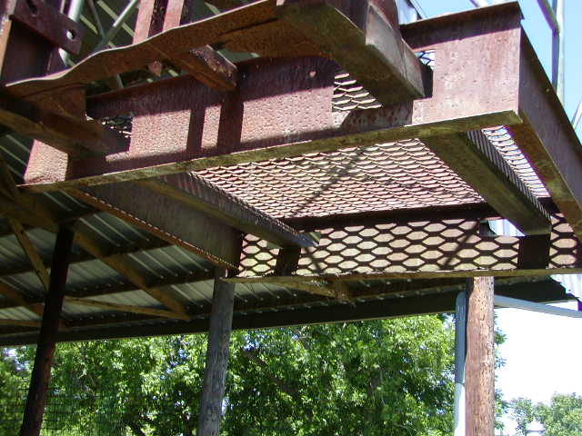

Underneath view

Re: Progress on my tractor\'s new home
I suppose with a few changes, you could build it in halves, then set the top half on when extra heighth is needed. I just didn't run into that need. Already had another platform to set in rear of trailer truck, for unloading cargo. If I need a low platform, would just grab it.
Very impressive, thank you.
It appears the working height would be around 16ft? Just trying to figure how I could use this for working on the side of my home (20 ft).
The close ups really helped me understand how you constructed, great job.

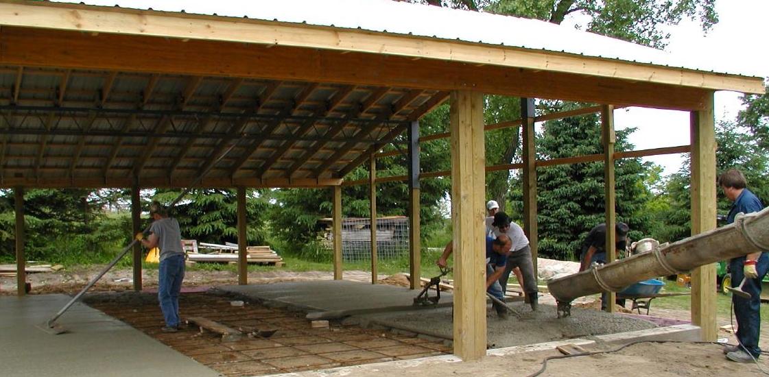

More progress. Roof is on, minus cap. Here you see the floor in progress. Turned out pretty good. Used a power screed, first time for me, it has some advantages and disadvantages, but makes the work MUCH easier. 15 cubic yds. 4000 psi, air-entrained, 4.5 inches thick, #4 rebar wired together on a 2 foot grid, plus extra on the edges where the conc is thicker.
Very nice, very nice. They should be pouring the basement to ours next week. Seems kind of odd but as soon as the foundation is capped they want to pour the basement floor asap.

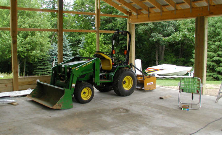

New photo, parked tractor in shed for first time. Major milestone, considering most all labor for this shed has been mine and world's best wife (mine).
