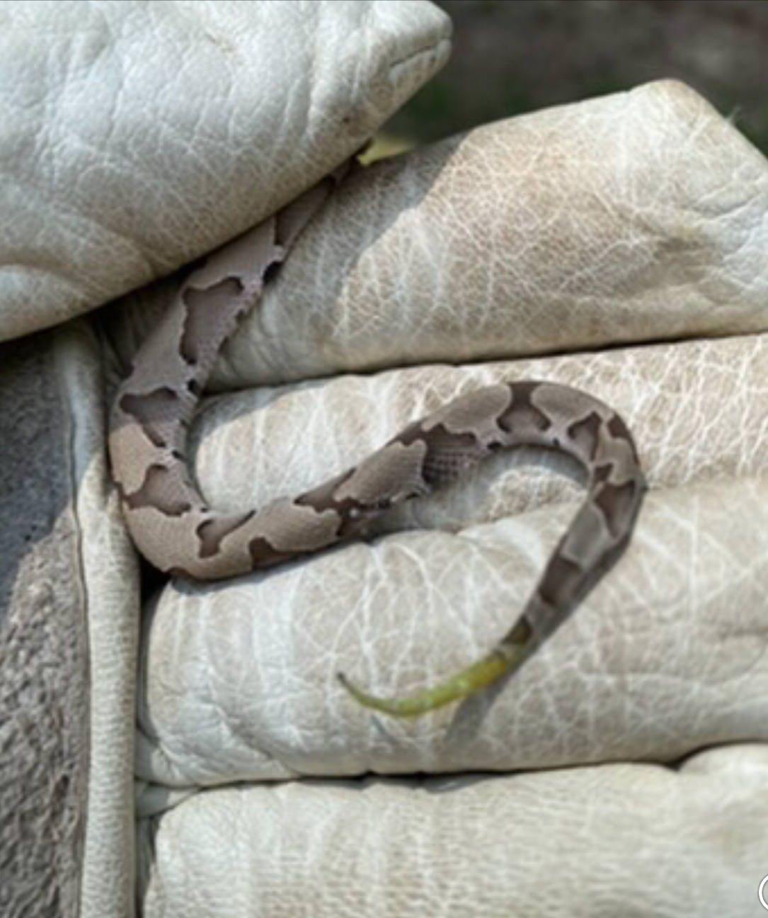

Watch out for green tails!
Baby copperheads have a green tail until they are about a year old.
