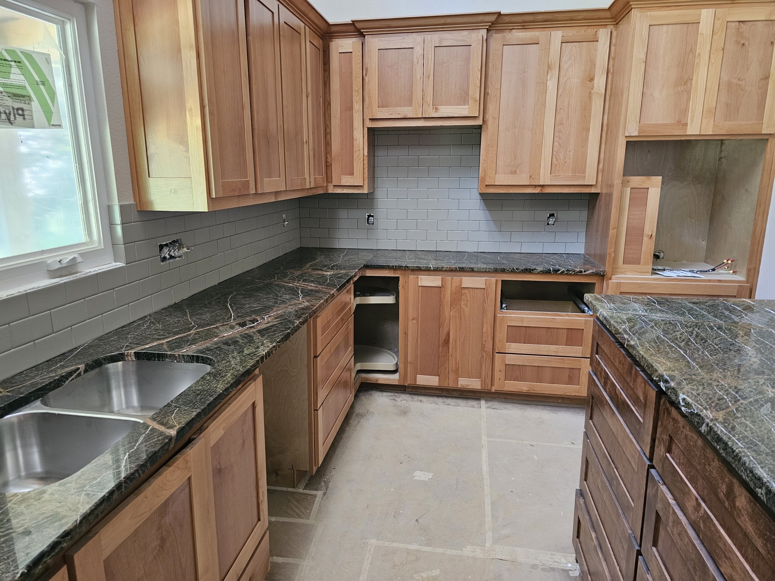

Just got back from hauling more stuff out there. Here's a shot of the backsplash. Still needs grout.
   / Progress!
#183
Doesn't the label say "Ruud"?;)
The counters (and indeed the whole house) look gorgeous!
All the best, Peter
Thanks. It has taken way too long, but I did the design myself. Some great input from some of the sub contractors (electrician is a good guy).
