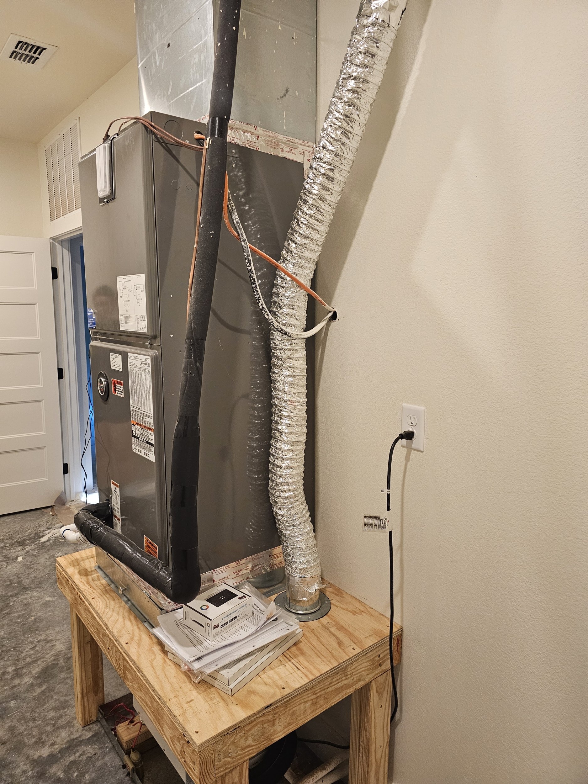

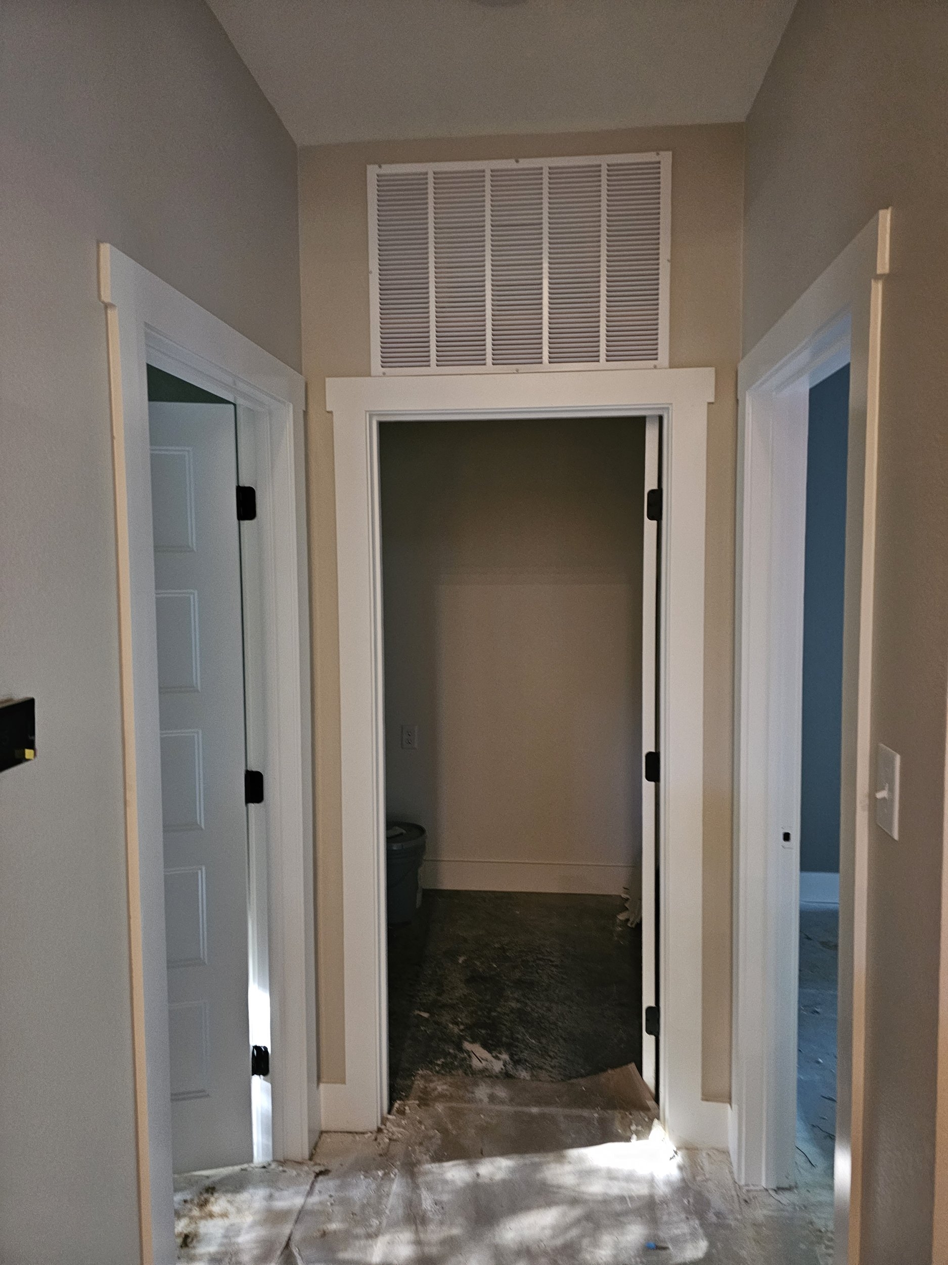

AC update: return is only coming in the above the maintenance door:
The dehumidifier is stand alone, not connected to air handler.
Here is a better shot of the unit:20230809_083013.jpg
   / Progress! #206

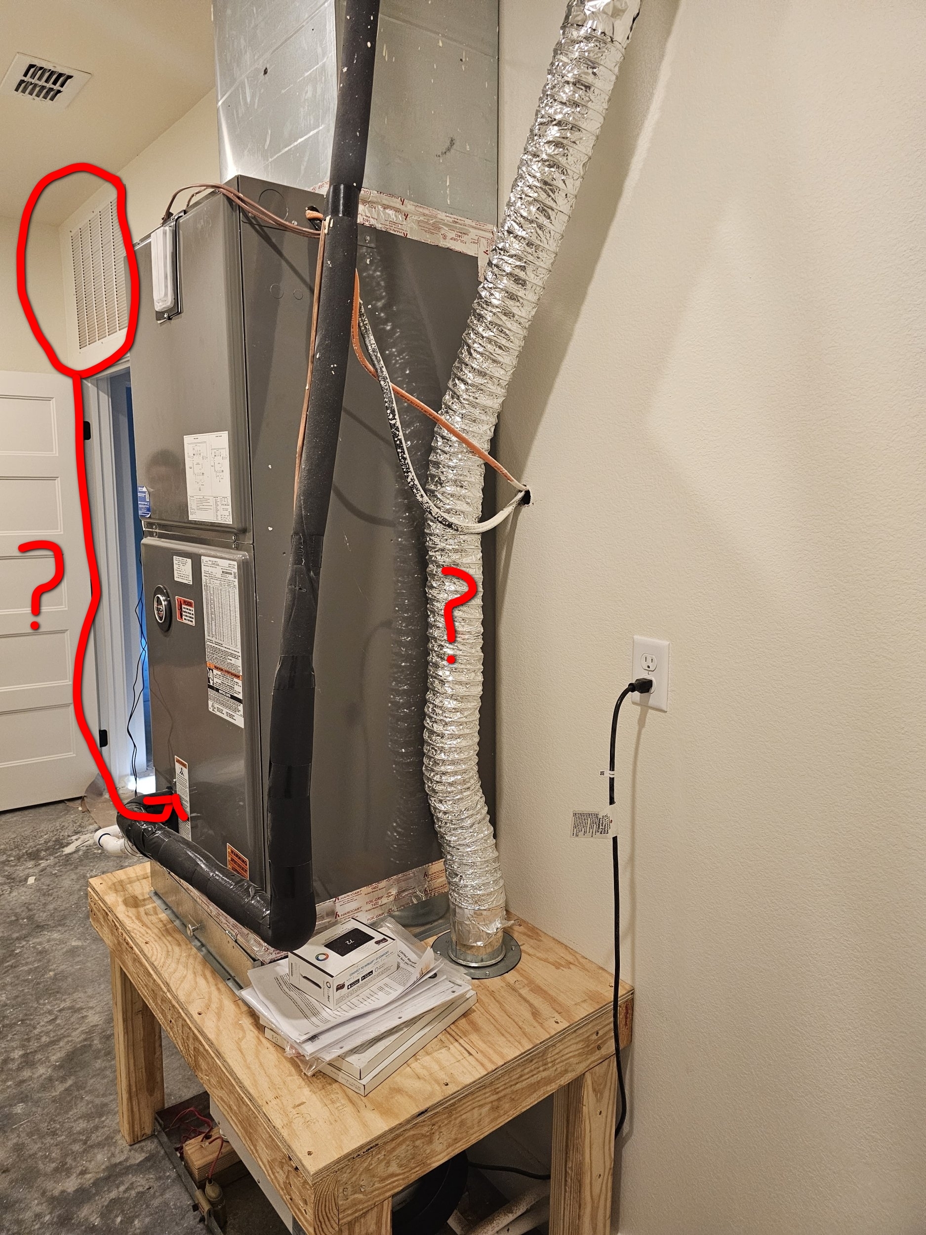

Trying to understand what's actually happening.
So they installed a return grill over the maintenance door in case the door gets shut and then the return air is being sucked into bottom of the air handler sitting on the wood platform?
When the door is shut and the air handler is running, are you noticing much noise?
What is the purpose of the metal foil duct to the right of the air handler?
Somehow the dehumidifier is supposed to suck the moisture out of the air flowing past it into the air handler return?
Is the dehumidifier actually doing anything to remove moisture beyond what the a/c system is removing?
   / Progress! #207
I thought it was up and running so they could work on the interior in the cool instead of the heat and humidity?
I haven't dealt with installing a dehumidifier in connection with an air handler. I'm scratching my head wondering why the air handler isn't just going to pull nearly all the air right into the air handler and hardly any is going to flow through the dehumidifier while the air handler is running?
Another thing that concerns me is having the air handler right next to the drywall because that could amplify any noise or vibration if the drywall acts like a sound board.

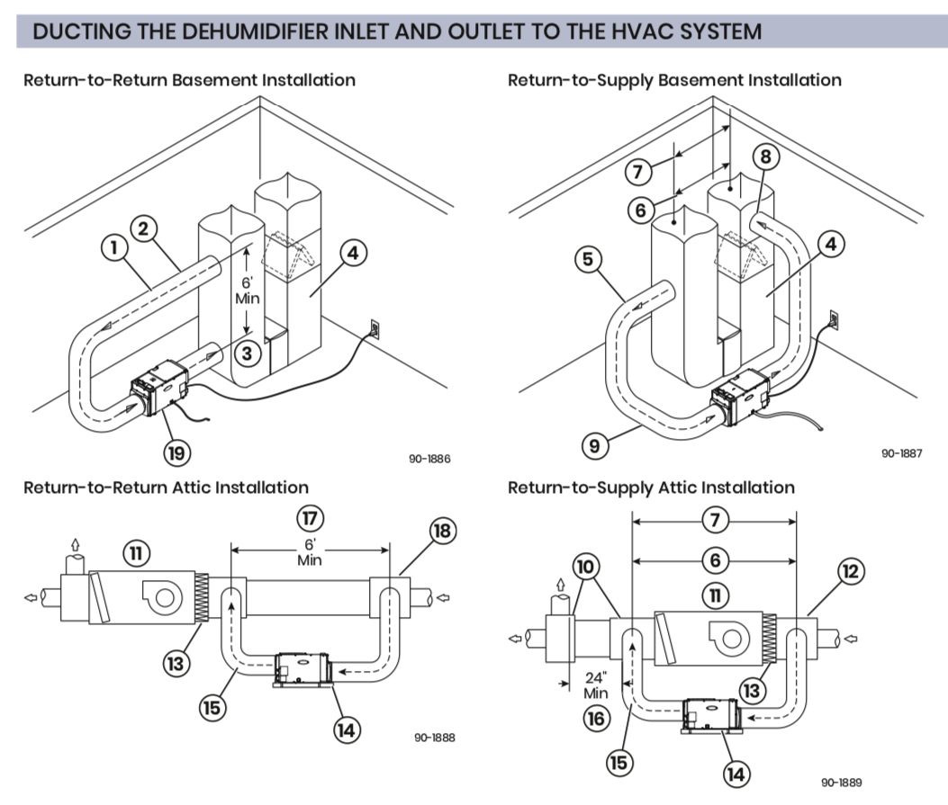

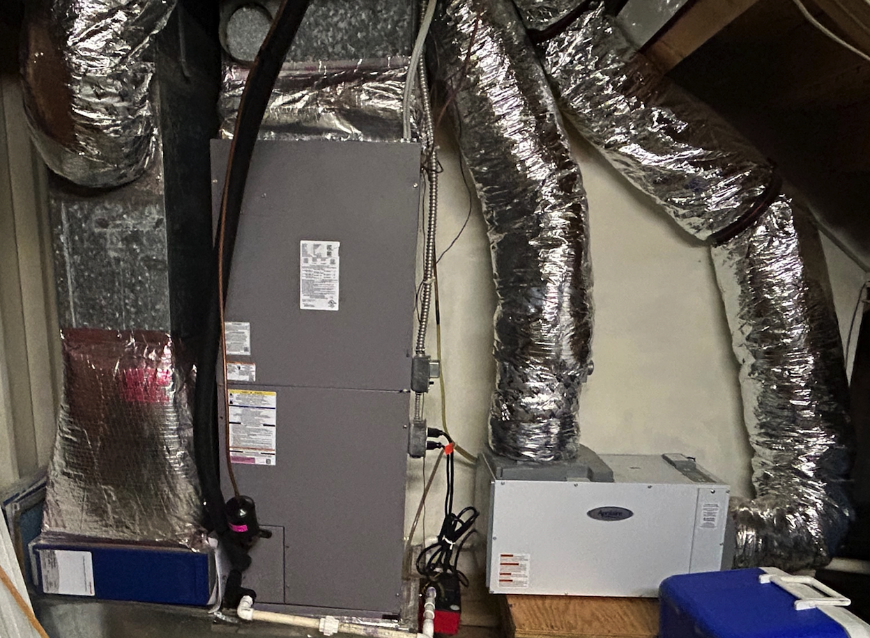

Dehumidifer in my basement.
The prefered method is return to return, but the ductwork was installed in 1988 and I tried to keep it simple. Keeps the house at 40% which is low, but the way I like it in the 3 hot and humid summer months.
I put in a new system in 2007, and this system was put in last year because it was worth it to me vs the repair. 15 years was a good run IMO on the first system I put in, but was able to run extensive tests with the dehumidifier with a single stage X-13 system, and finally could run tests with a 2 stage variable speed air handler system installed here.
Per Apriliare instructions (not Santa Fe).
   / Progress! #209
So the recommended method is to hold the air captive in duct so it can't skate past the dehumidifer like it would in an open return.

Haven't been there enough since it has been running to notice any noise. It seemed quiet enough this morning. I could see water coming out of the pipe outside, so the dehumidifier is doing something. Exterior unit was spinning away. I took a shot of it, but it didn't turn out well. For what it's worth, it is called a "Achiever Plus". Means nothing to me.
Normal operation when we move in will be door closed 99% of the time. My wife wanted the cat box be in there. It sounded like a bad idea to me. I'm working on a 'catio' setup that will keep their mess outside, but allow them access. As is, they are MIA right now, so I have more time to deal with that eventuality.
