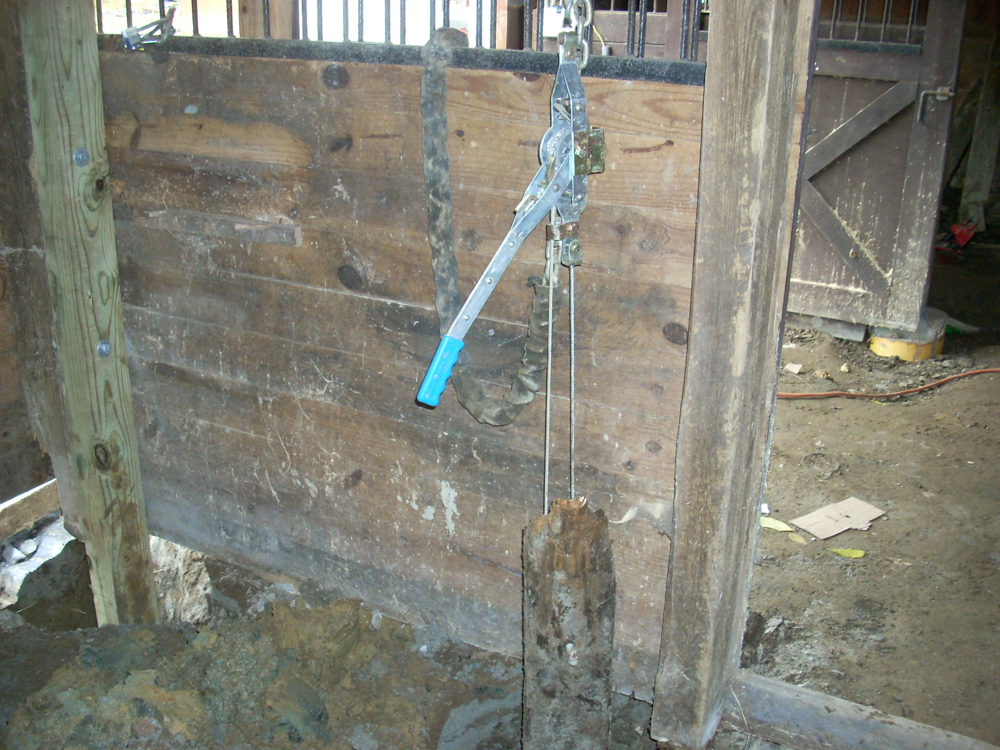

I was amazed to see how healthy the posts were below ground. Stating the obvious, but it takes moisture/drying cycles to rot wood.... just above ground level is where the damage is done.
In picture below you can see a sistered post. I added another one to that same posts since it is one of the direct support posts for the 2nd floor beam on the front wall. The come along was the tool to extract the posts. Couldn't have done it without the "high torque" version.

Thanks for the tips. I've never done anything quite like this and don't know if I would have thought of a come along or not. The eye bolt is genius.

Scary part was trying to keep the barn from collapsing while removing load supporting posts. I made sure to only do one under each of the 4 supporting posts at a time.

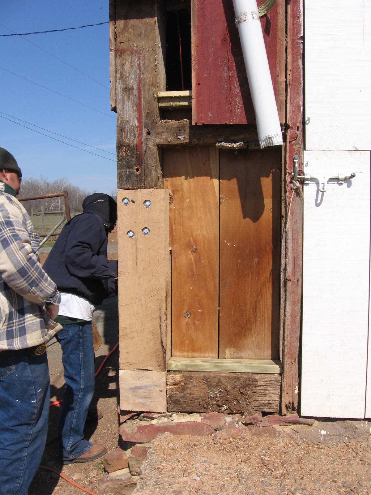

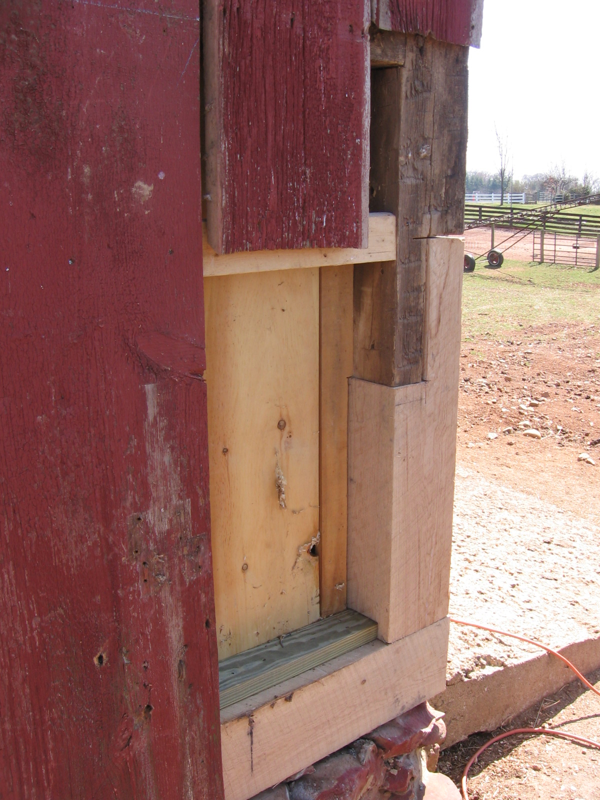

/ PROJECT.... BARN RESCUE #19
When I had an old timber frame barn restored at the park I was in charge of the contractor did a lap joint on the posts that were rotted at the bottom. He then screwed it together with big lag bolts. These posts only went down to a sill plate and not into the ground. Rick
