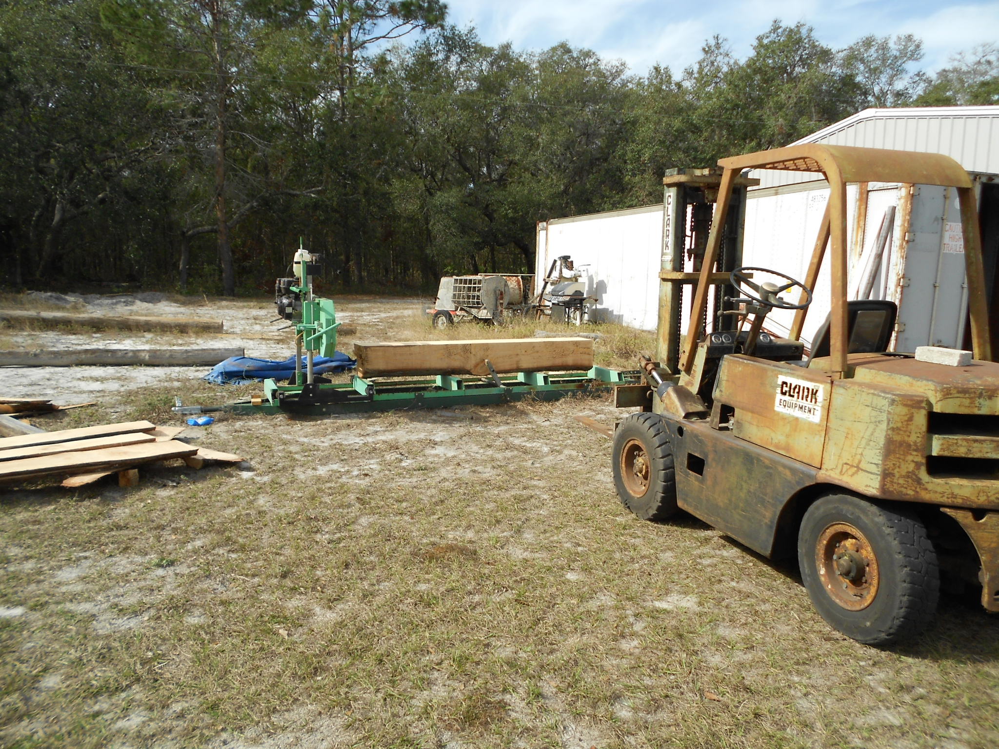

   / Project Clark forklift #32
Here is a pic of my current forklift, I paid $800. for it not running.
I needed to move it 50 miles to my new place 2 years ago.
I found a local guy with a Rollback that moved it for $150.
It weighs 8800 lbs.
This one has a Continental engine, even NAPA sells parts for it.
