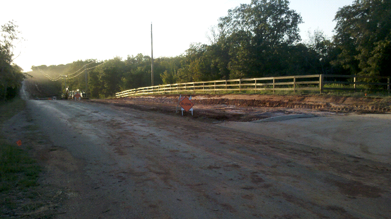

By post and rail do you mean a split rail fence or the type of fence that Rx showed?
I agree with Rx, a 6" auger would be ideal for tamping them, but if you have a loader you can use a 4" auger and then just push them in. If you are going to use the same holes I agree with Beez, you may not have to auger the holes at all. Again, just push them in.
As for getting them straight (this goes for either method) I set my two end posts and any corner posts first. Then run a masonry string like this one as tight as I can about a foot or so off the ground between them. Then if drilling new holes I measure where each post goes with a 100' tape and mark the holes with florescent marking paint.
As for getting them plumb when tamping them, I eye ball them until the dirt is almost completely tamped then use a four foot level to get them perfect by tamping more/harder on the side(s) the post is leaning to.
Check out my fence building pictures to see how mine turned out.
