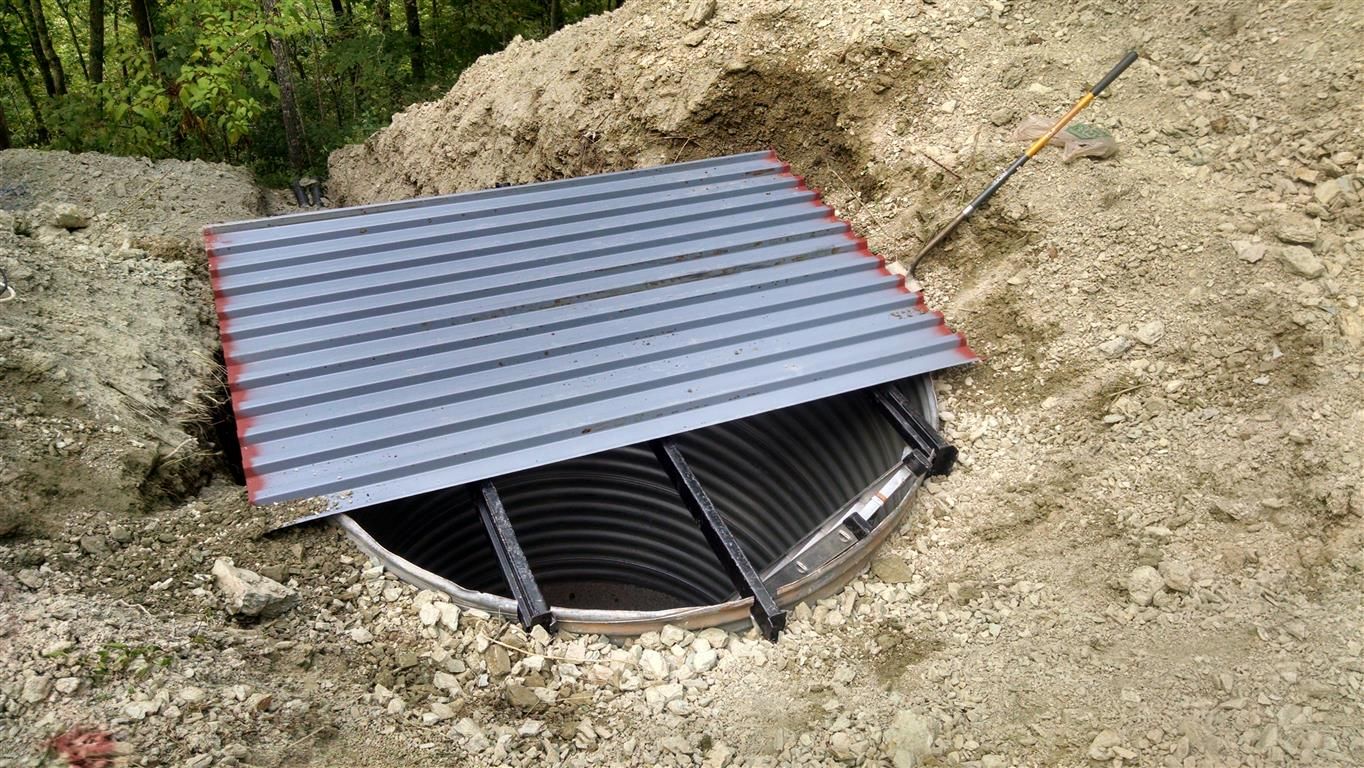

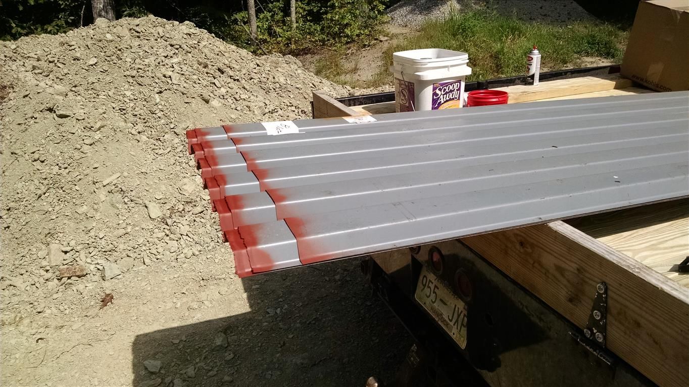

I picked up the bridge form metal today...it is not as heavy as I expected...only 22 gauge, so it will need supports:

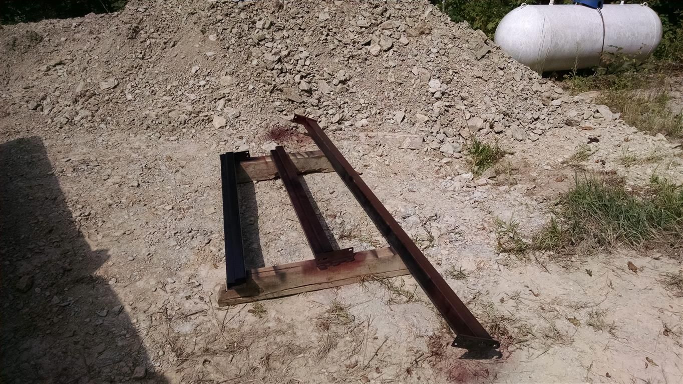

I have a pile of industrial shelving frames that was left behind from the previous owner. It's the type you see in Lowe's or Home Depot so it is pretty heavy duty. They are 9' long so I used a full length in the center of the culvert and cut/welded two on either side. Cleaned up and getting painted:

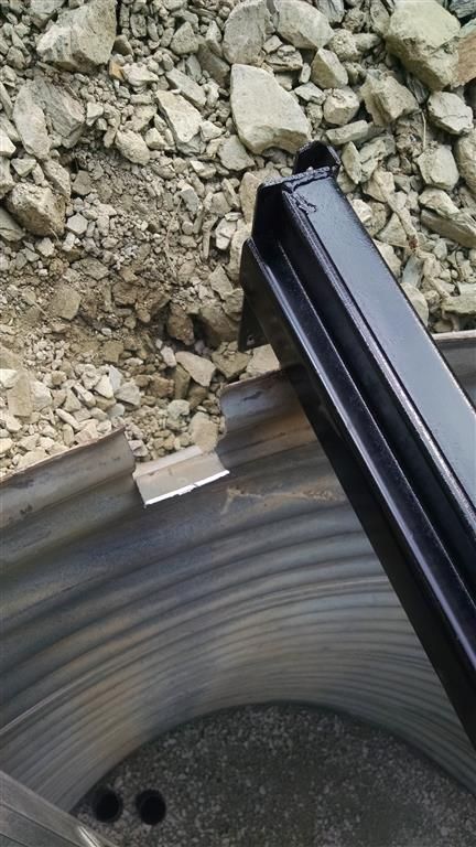

Cutting the slots in with a side grinder:

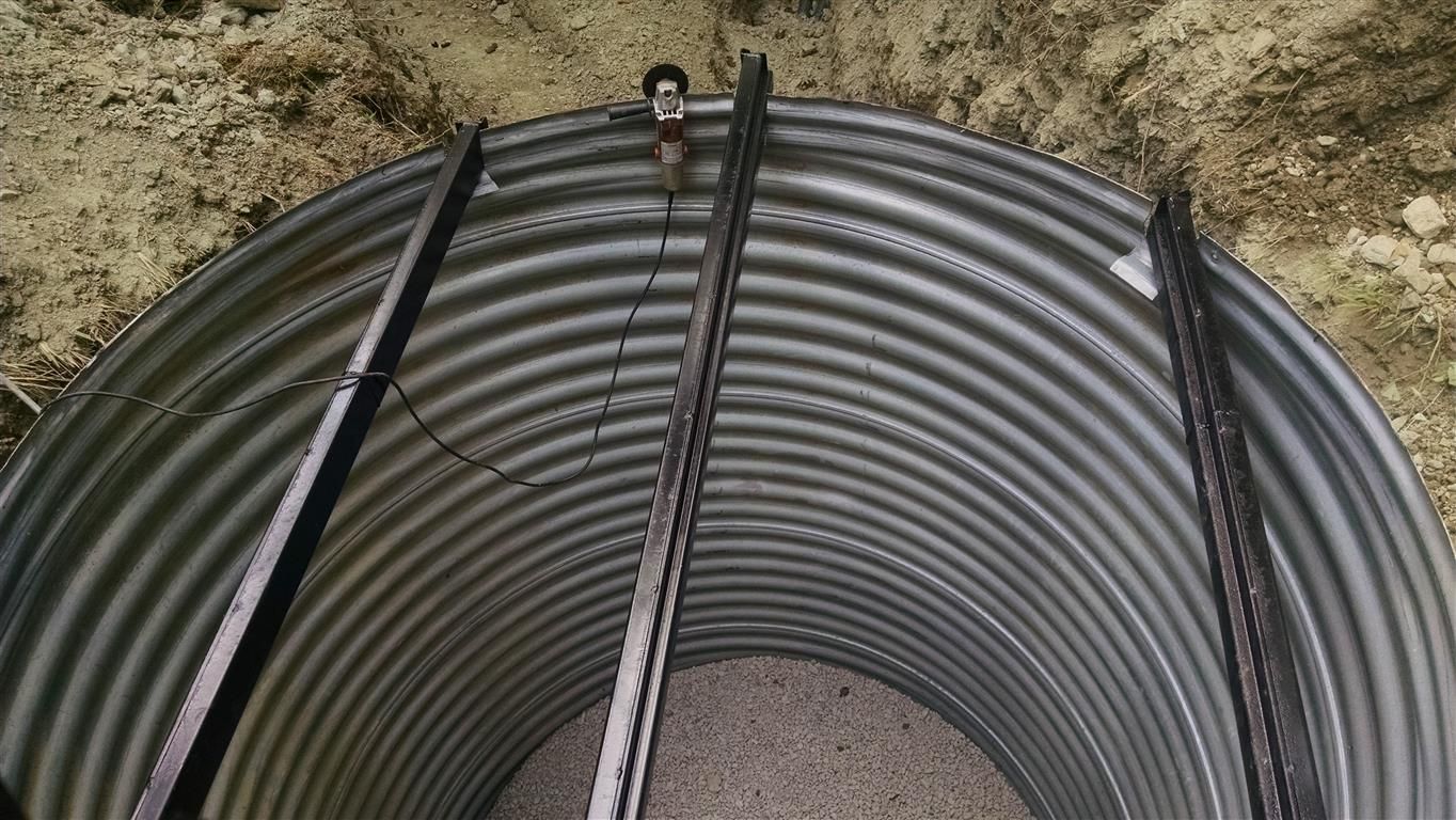

Joists all set:

Laying in the decking:

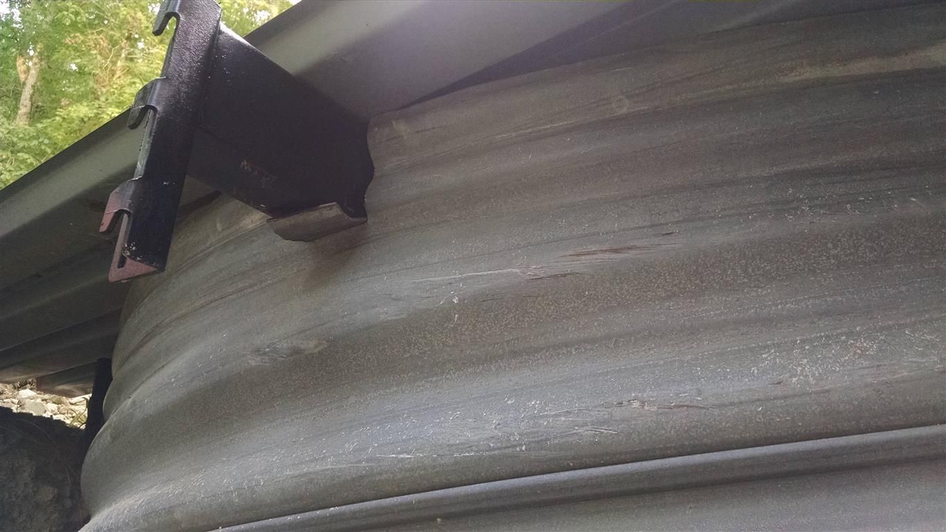

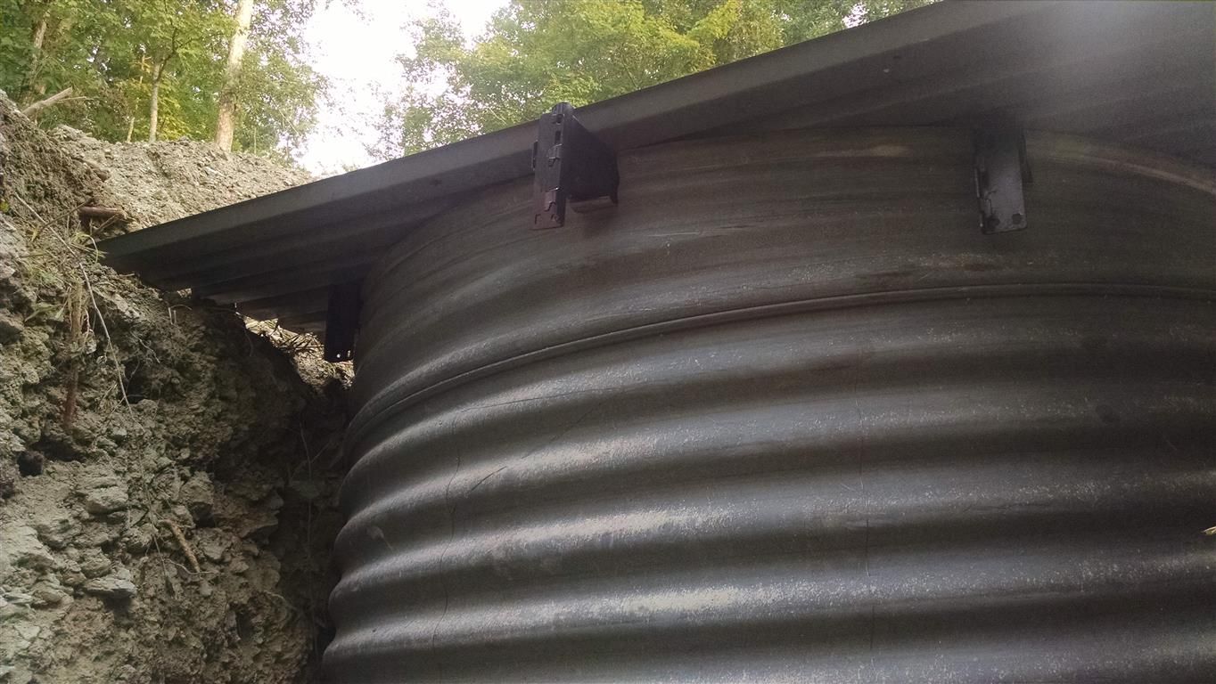

I used the chunk of metal I cut out as a pad for the joist to sit on....they are hollow:
