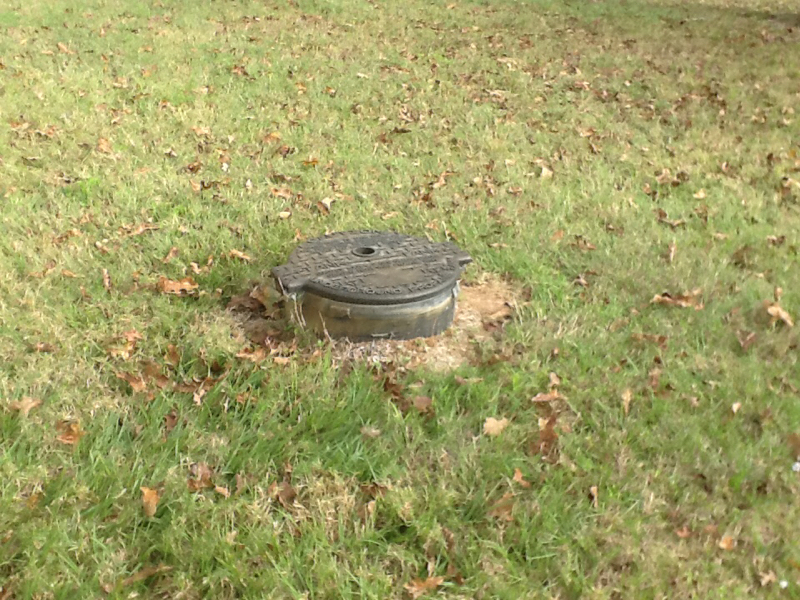

Corporate America at it again. It seems that a big name Propane supplier has bought out 1 of our local suppliers & is trying to force some residents to buy from them at a much higher rate, claiming ownership of underground tanks that have been in place for many years. The company Is requiring proof of ownership on the tanks or pay a rental fee. If anyone has any advice would be great. And how do you show proof of ownership on a propane tank that has been in place for 20+ years? Anyone w/sound advice please feel free to send me a Private Message. Any & all info is Greatly appreciated.
Turn the tables on them and demand a current certification or removal or "their" old and likely unsafe tank.
If everyone agrees that you own the tank, you are responsible for the damage it may cause and the propane company can refuse to fill it unless it's certified within the last X number of years. If they claim it, they will continue to fill it and will be liable if it fails. If you force them to get rid of it, you can buy your own tank and forget the rental. If it becomes outdated, re-certify it yourself with fresh paint and a date stamp. That sounds like a trick, but it's all that the propane company likely will do (I've seen them do it).
